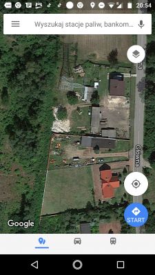

    I'm going to buy a house. It is located in Krzeszowice, 90 meters from the WN 220kV line. additionally 10 meters from the house there is an MV 15kV line. Will I be exposed to EMF more at such distances than living in the center of Krakow?
    Do I have to worry about it? I am asking for advice :(
    I wanted to buy an electromagnetic field meter, but I do not know if the measurement in uT is enough or is the measurement of the electric field V / m also important? because then I would have to buy 2 meters and the cost becomes significant.

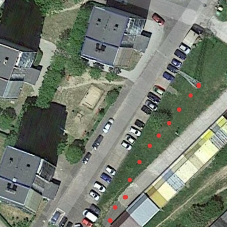

    110kV and 30m. A buzzing in the fog. No other inconvenience for years. I marked the course with dots.
    220kV High Voltage Line 90m from Krzeszowice House: EMF Exposure & Meter Recommendations
