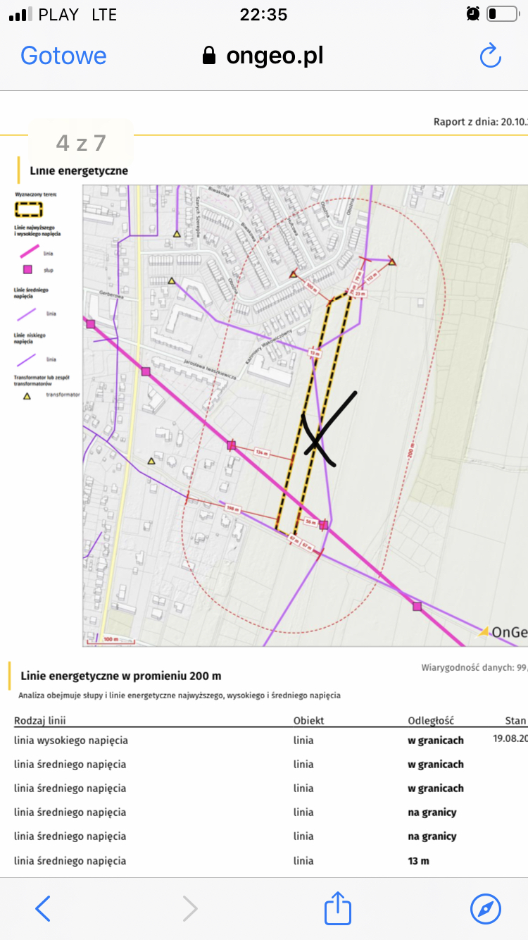

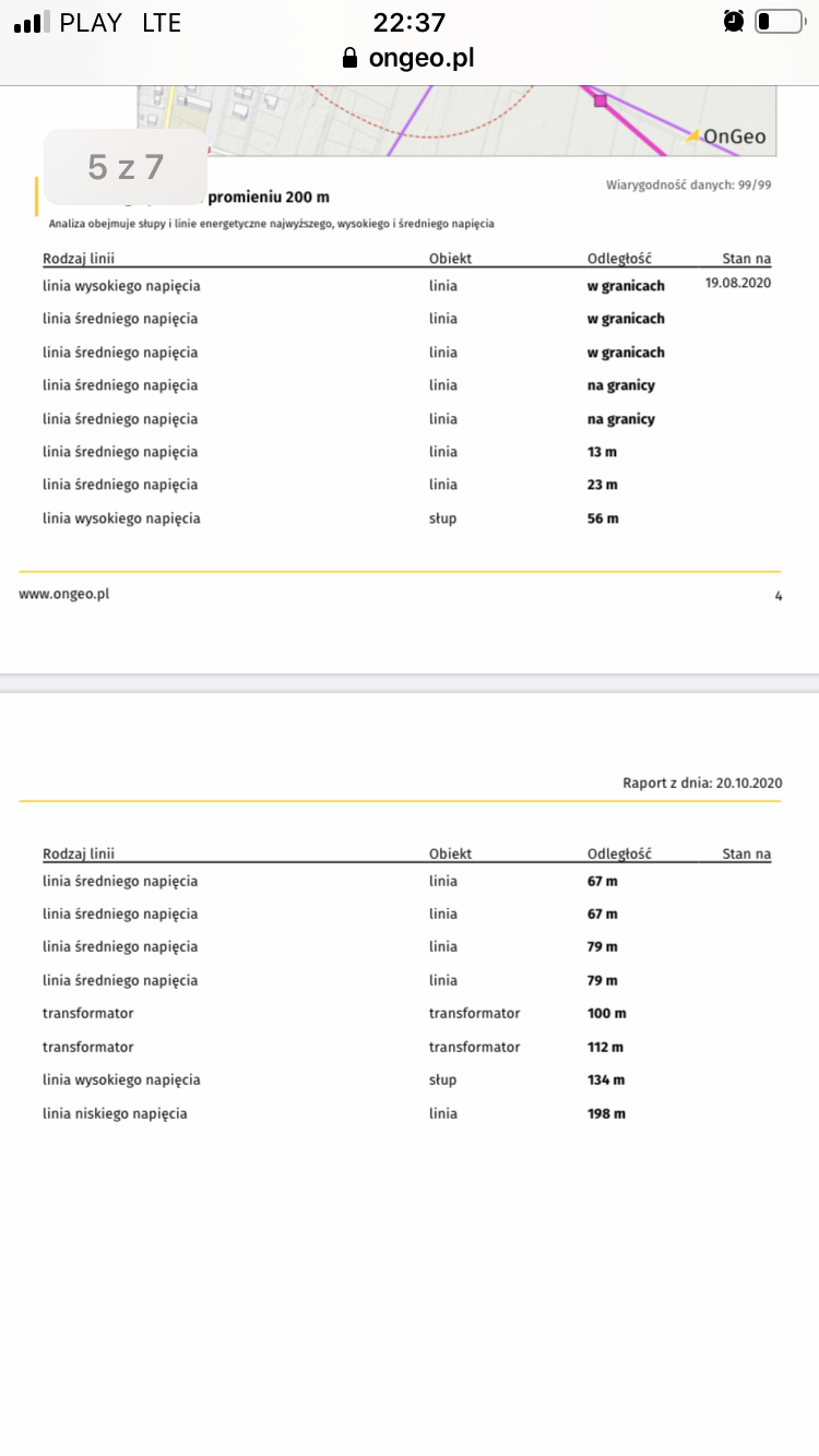

    Hi!
    I am planning to buy a house from a developer but I am worried about a large pole near the plot..
    I made a report online but I don't understand much of it - in fact I don't know if the presence of all these lines should disqualify the choice of this offer or in big cities it's the norm such a forest of lines 🤦
    Could someone enlighten me? The house will stand more or less in the place of the black cross on the attached photos.

    I advise against.
    Let's skip the stories about the electromagnetic field and other witchcraft - the HV line is noisy. Take a ride there in wet weather, fog, and listen. You want to build a house 100m from it, which is a terrible idea for acoustic reasons. You can still specify the exact location or appearance of the pole, it will determine the line voltage, but it will make noise anyway.
    In addition, to carry out any work under (the house is far away) the line, you must comply with certain regulations, restrictions.
    As if it was an MV line, everything is ok. Unfortunately, HV interfere.

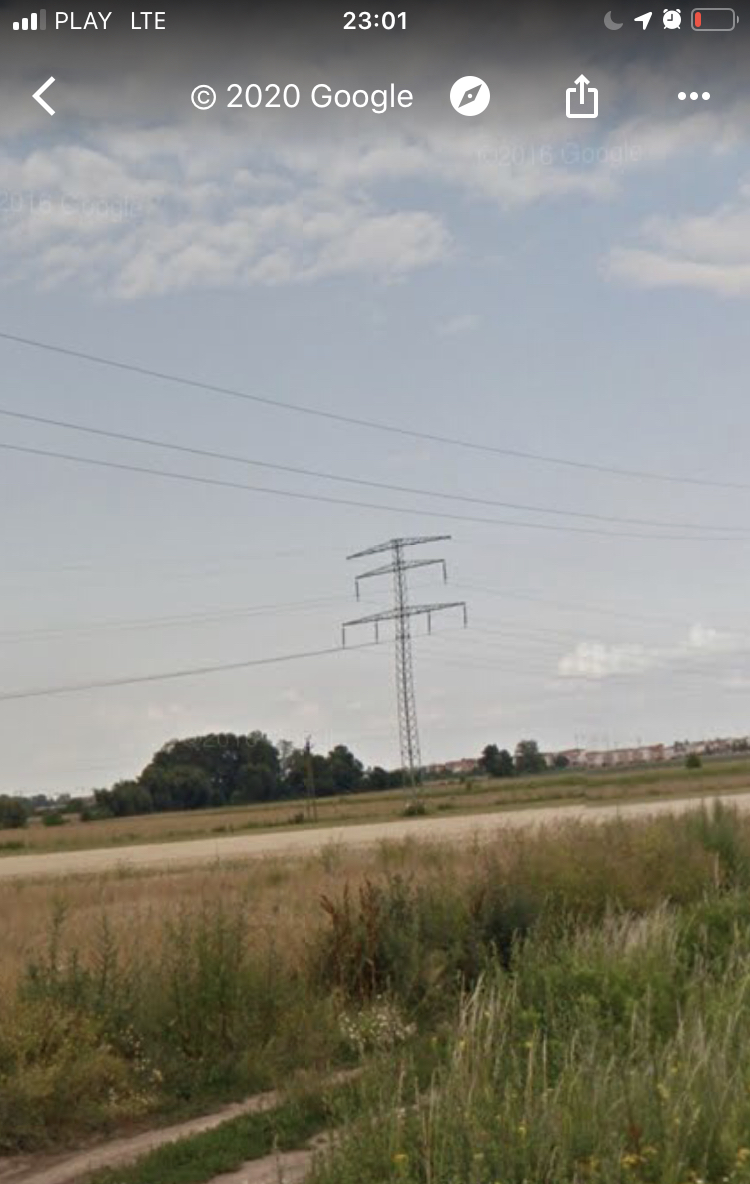

    this is what it looks like

    220kV. I stand by what I wrote earlier.

    To me it looks like 110 kV lines on D2 poles.
    This line goes over the house?

    moze-byc wrote:
    220kV.
    It is a 110kV line from GPZ Czechnica - Wieczysta/Wilcza Station - GPZ Klecina in Wrocław.
