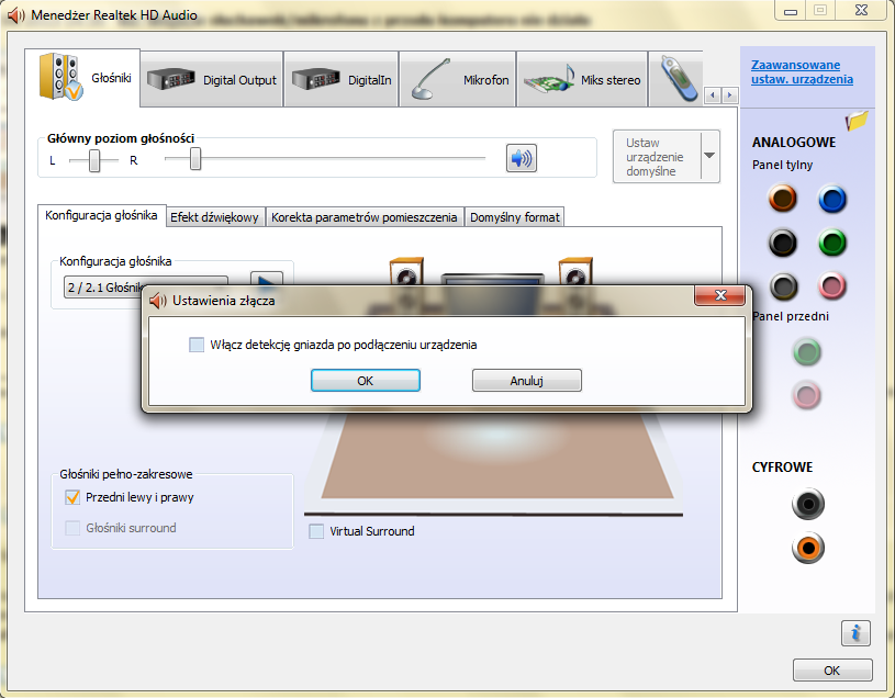

  • #11 12673429
    safbot1st
    Posts: 21951
    Help: 2719
    Rate: 1585
    The headphone / microphone input on the front of the computer is not working
    Click on that yellow folder seems to and tick off what is checked.
    The green and pink circles on the right in the center should light up.

    And how do you "turn on the detection" what happens?
  • #15 12673720
    Yakers
    Posts: 773
    Rate: 43
    Nothing: /

    But you put a jack in the front panel then?
    Give screenshots of what you have under the advanced button set. devices.

  • #19 15345731
    safbot1st
    Posts: 21951
    Help: 2719
    Rate: 1585
    @Yakers Try to enable "simultaneous playback".
