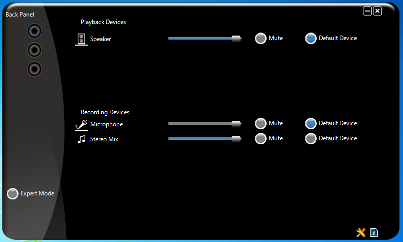

    Today I bought a used computer, it is more efficient, but unfortunately after further checking I came across a problem with sound.
    I have installed the new Windows 7 Professional, I have updated the Audio drivers, the equipment also works because I checked it on the old computer. On the screenshots he adds, you can see that the sound is, unfortunately, nothing comes out of the speakers. I installed drivers from the manufacturer and also zero response.
    Sound problem. - No sound when the speaker / headphones are connected Sound problem. - No sound when the speaker / headphones are connected

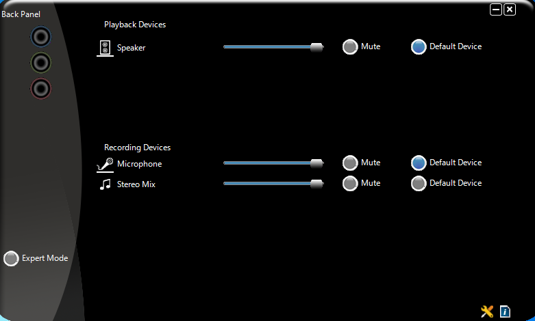

    The front panel is attached.
    I put the jack in the green socket.
    Everything is factory set there because I didn't rummage there.
    It doesn't detect and how the jack is disconnected and the sound fires it shows the sound mixer how the bars walk.
    Unfortunately not, so I wanted to upload everything again.
    Added after 11 [hours] 36 [minutes]:
    I connected completely different headphones and no reaction.
    Headphones connected Sound problem. - No sound when the speaker / headphones are connected
    and here after disconnecting Sound problem. - No sound when the speaker / headphones are connected
    You can see that there is no difference. Could it be a broken integration or conflicting drivers?

    It looks like the jack is damaged.
    He can't see it in the software.
    After connecting the jack to another socket - shows the connected device>?
  • #10 16379635
    Night_Ghost
    Posts: 23
    No, when I connect the jack to another socket, it is the same as with the rear socket, i.e. it does not show that the device is connected.
