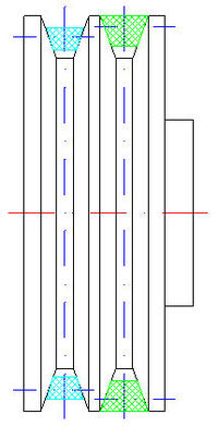

    Pulleys and V-belt - illustrative drawing

    Pulley and V-belt - pictorial drawing
    For comparison, the location in the groove on the pulley of type A and B belts. Use the same type of belts, e.g. for a 2-groove pulley: 2 belts B or 2 belts A.

    An example for my motor shaft pulley and A (13) and B (17) V-belts.
    Data:
    - Engine revolutions: n1 = 940 [rpm]
    - Effective diameter of the active (driving) pulley on the motor shaft: d1 = 132 [mm]
    (Outer diameter of the driving pulley on the motor shaft: d1z = 140 [mm])
    - Pulley with two V-belts type B (17). For stubborn, you can also use two A-type belts (13).
    (view of both belts in the overview drawing)
    - Required revolutions of the driven device shaft: n2 = 650 [rpm]
    - The axial distance of the shafts is adjusted by moving the motor in the guides.
    Wanted size:
    - Effective diameter of the idler pulley (driven) on the shaft of the driven device: d2 =? [mm]
    The value calculated from the formula d2 = (n1 * d1) / n2 is: d2 = 190.89 [mm]
    As the rotations of the driven device shaft in my case do not have to be that exact, I choose from the standard the closest value of the effective diameter of the pulley: d2 = 190 [mm]. Outer diameter of the pulley: d2z = 200 [mm].
    Ds - effective diameter of the pulley (selected from the standards, after previous calculation)
    Dz - outer diameter of the pulley
    Dp - outer diameter of the pulley (base) for the V-belt
    Dw - inner diameter of the pulley (per shaft)
    L - pulley width

    Pulley Dz140 Dp110 Dw38 L50 Ds125 Ds132 (V-belt type A13 B17) .dwg
    Pulley Dz140 Dp110 Dw38 L50 Ds125 Ds132 (V-belt type A13 B17) .pdf
