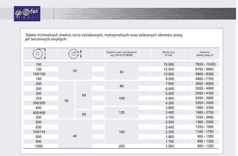

    Hello, I have a 2.2kw 1420 RPM engine. What would I have to give the pulleys for the shaft and the engine to cut the 300 disc

    Ok, and with which pulleys to reach 3000 rpm With the engine of 1420 rpm

    The conversion factor - 2.1126 for the 1420 rpm engine for 3000 rpm for the disk.
    For example, at the wheel on the saw shaft, a pulley fi 80 mm, on the motor fi 169 mm.
    This motor is a bit weak for a 300 mm saw, of course, it depends on what will be cut.

    It would be better with a power of 2.2kW 2840 rpm, everything depends on what will be cut.
