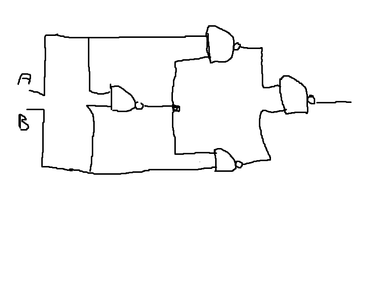

    I'm trying to remember Boolean algebra and De Morgan's laws.
    And I have a problem with implementing an XOR gate using NAND gates.
    Especially with the transformation Q=A+B= ???
    I am attaching a combination of NAND gates that create an XOR gate
    Implementing an XOR Gate Using NAND Gates: De Morgan's Laws and Boolean Algebra
    I would be grateful if someone helped me ;)

    Where's the addition here, just looking at the diagram?
    By adding a few symbols, you can define logical states at various points in the system:
    Q1 = ~(A*B)
    Q2 = ~[A*~(A*B)] = ~(A*Q1)
    Q3 = ~[B*~(A*B)] = ~(B*Q1)
    Q = ~(Q2*Q3) = ~{~[A*~(A*B)]*~[B*~(A*B)]}
    http://pl.wikipedia.org/wiki/Prawa_De_Morgana

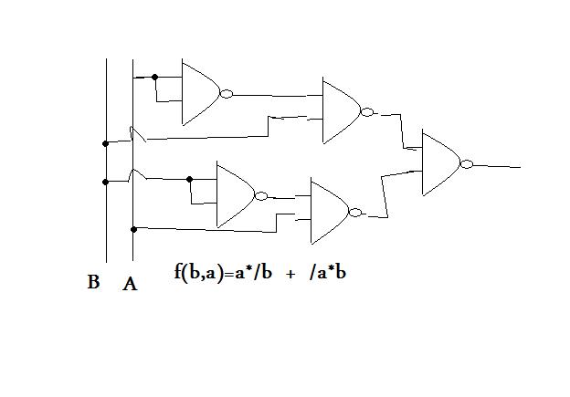

    It's not that simple, friends,
    Regards. :D
    PS: Sorry for the quality, but everyone should be able to understand it. :spoko:

    Since there is an imposed type of gates from which you build...

    These gates are NANDs, not NOTs. :D

    No, it's not adding, it's expansive ;) XOR gate designation.
    Thank you so much for help ;)
