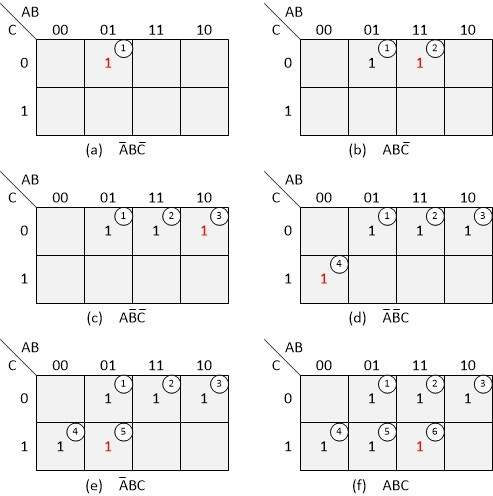

    The next step is to create the Karnaugh map. We start by creating the mesh itself. Since we have three inputs, we can do it in two ways as below screenshot shown:
    Implementation of logic functions only from NAND or NOR gates
    It doesn't matter which option we use. The answer will be the same in both cases. We will use option number one. When looking at map number 1, notice where "AB" is. On the right side there are four combinations of zeros and ones that can be associated with AB inputs: "00", "01", "11" and "10". It is very important to note that these combinations are represented in Gray code which means that only one bit changes as we move from one value to the next. This is the key to the operation of the Karnaugh map.
    Natural binary code Gray code
    00 00
    01 01
    10 11
    11 10
    In natural binary code, when we go from 01 to 10, two bits change. For comparison, if we look at the corresponding shift in the Gray code (01 to 11), only one bit changes.
    In addition, consider the last line of the binary code. If we were to wrap around and go from this line to the first line (11 to 00), then - again - two bits change. However, if we look at the corresponding lines in the Gray code (10 to 00) we see that - again - only one bit changes.
    Now let's complete the Karnaugh map. We do this by adding 1 to each square that corresponds to the product in our equation. We will do this step by step again as shown below (the little numbers from 1 to 6 in circles correspond to the products in our original equation):

    It should also be noted that we do not need a truth table to complete the Karnaugh map. It is enough if we go through our equation and for each product we add 1 to the corresponding area of the Karnaugh map.

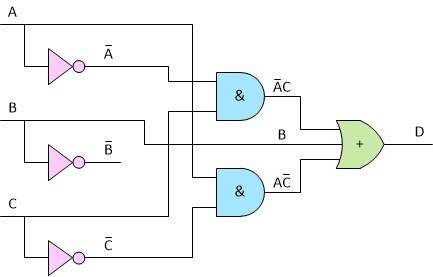

    In this case, the value of variables A and C does not matter - the only variable that has the same value for these ones is B and it is always one. This means that the minimization result from the Karnaugh map looks like this:
    $$D = \bar{A}B + A\bar{C} + B$$
    From here, we can easily draw a circuit diagram with logic gates using the NOT, AND and OR gates. The diagram corresponding to this equation is shown below:
    Before you notice - we know that we are not using the! B signal (the! Sign means negation, and this notation means NOT B). We will use it in the future, however, so let it stay on the diagram. Speaking of the future, the next step is to implement the last part of the task and use only NAND or NOR gates.

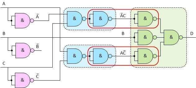

    The gates are color coded to make it clear what will happen next step by step. Suppose we want to use only NAND gates. So, using everything explained so far, let's convert the NOT, OR and AND gates to NAND gates.
    Let's start with the three NOT gates shown in pink to the left. We can replace each of these gates with a 2 input NAND gate with the inputs connected so no problems.

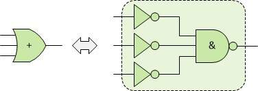

    Next, let's take a look at the three-input OR gate, marked in green. It is on the right side of our diagram. According to the DeMorgan transform, we know that we can replace it with a three-input NAND gate by adding NOT gates at the inputs as shown below.
    Again, as before, we can convert each of the three added NOT gates into a NAND gate as shown below.

    Now we just need to worry about the two AND gates, marked blue in the center of the circuit. Obviously, the DeMorgan transformations are not helpful here, since the equivalent of an AND gate is a NOR gate with NOT gates at the inputs, and we assumed that we cannot use NOR gates in this exercise.
    Fortunately, this has a simple solution, we just have to remember that the AND gate is really made up of a NAND gate followed by a NOT gate (similarly an OR gate consists of a NOR gate followed by a NOT gate). This means we can replace the selected AND gates as shown below:
    Of course, once again, we need to change the NOT gates to their equivalent, made of NAND gates, as we only want to use this kind of logic gates in our system. The layout after the transformation looks like this:
    Now we are almost to the end. Let's see what our layout looks like after putting together all the transformations we've done so far:
    Functionally, this system will perform the function entrusted to it, however, it is far from optimal. We can see that in two cases there is another NOT gate after the NOT gate (both implemented with NAND gates, of course). Both cases are marked in the figure below with a red outline.
    Each even number of negations connected in series gives the output exactly the same state as the input (plus the delay, but this is not important in these considerations). So we can just turn them into a simple connection.
    After all optimizations, the layout looks as follows:
