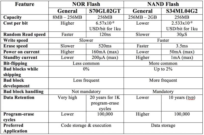

    Table 1 , below, summarizes the main aspects discussed in this article.
    What are the criteria for selecting NAND vs NOR Flash memory?
    Essentially, NOR Flash memory is an excellent choice for applications requiring lower capacity but faster random read access and higher data reliability. Therefore, NOR Flash chips are ideal for storing CPU code, etc. NAND Flash memories, on the other hand, are ideal for applications such as data storage where larger memory capacity and faster write and erase operations are required.
