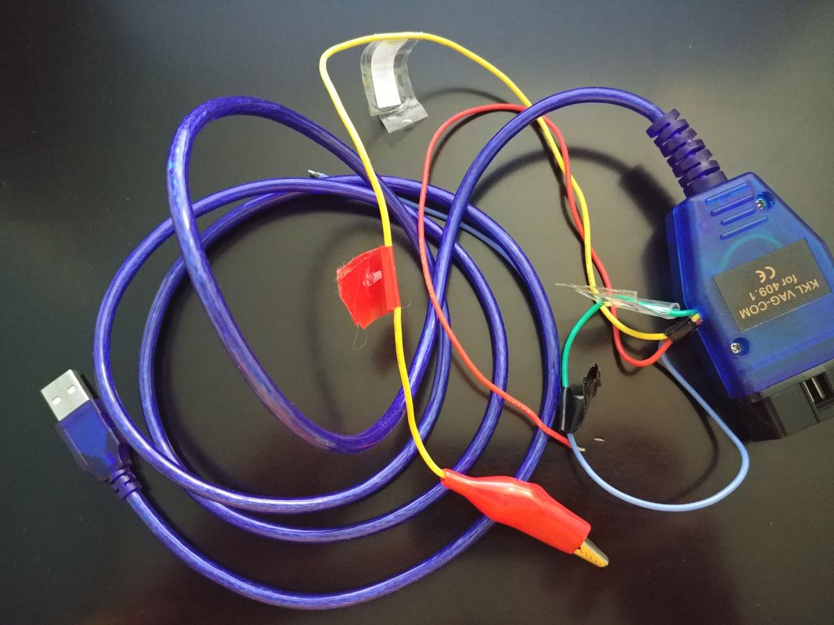

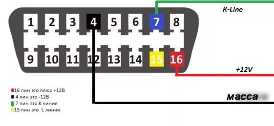

  • VAG KKL cable works over l-line
    #55 21802343
    xdyspozytor
    The connection is very simple - all you need is a regular VAG KKL cable. Communication goes via l-line
    Modified VAG KKL cable with added wires and clips on a black background
    OBD2 pin diagram showing K-line, L-line, ground, and power connections
    The cable you are converting - it must be powered by 12 volts. As I searched for information, everywhere recommended communication over k-line, but from my experience it is better over l-line.
