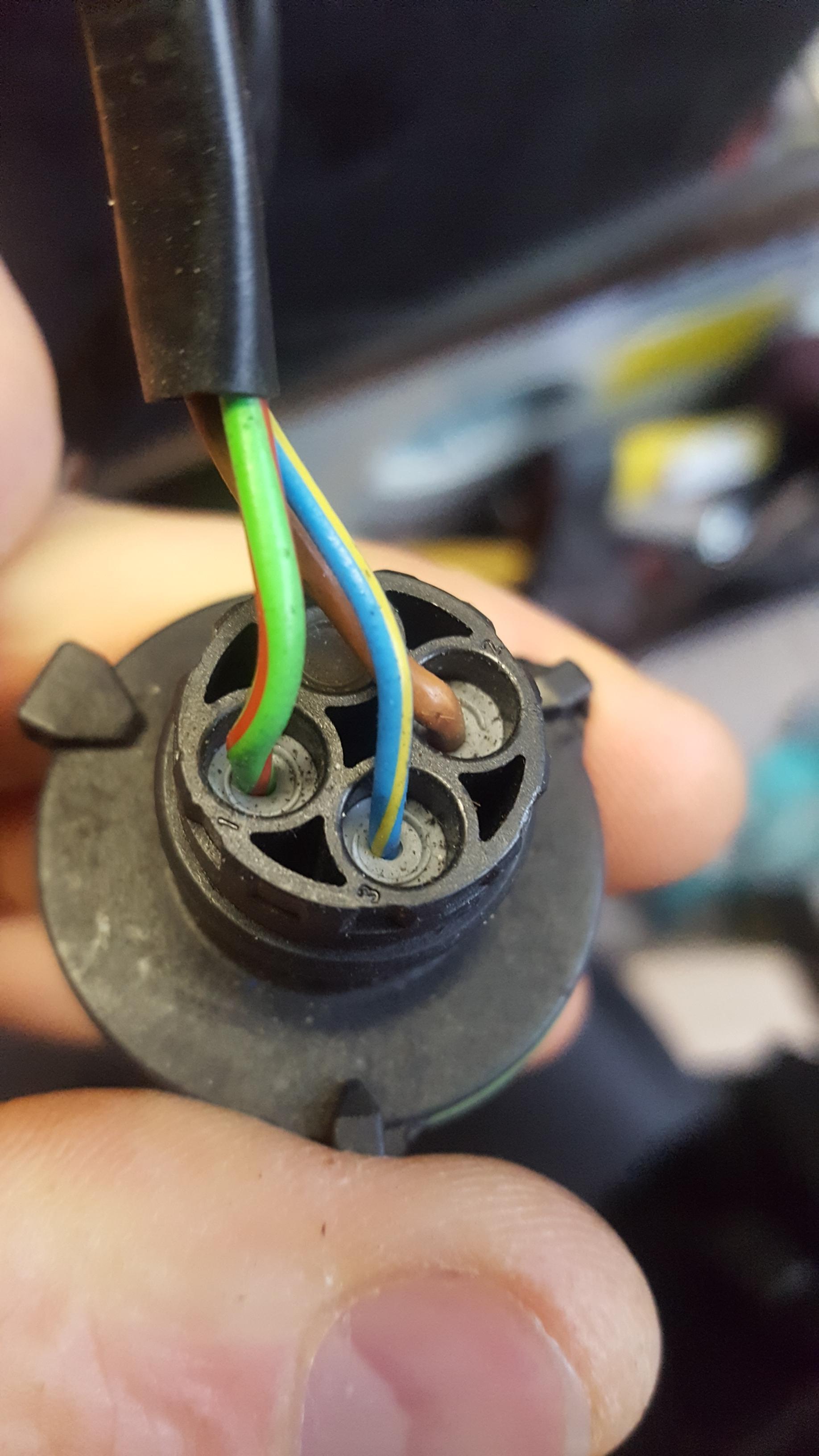

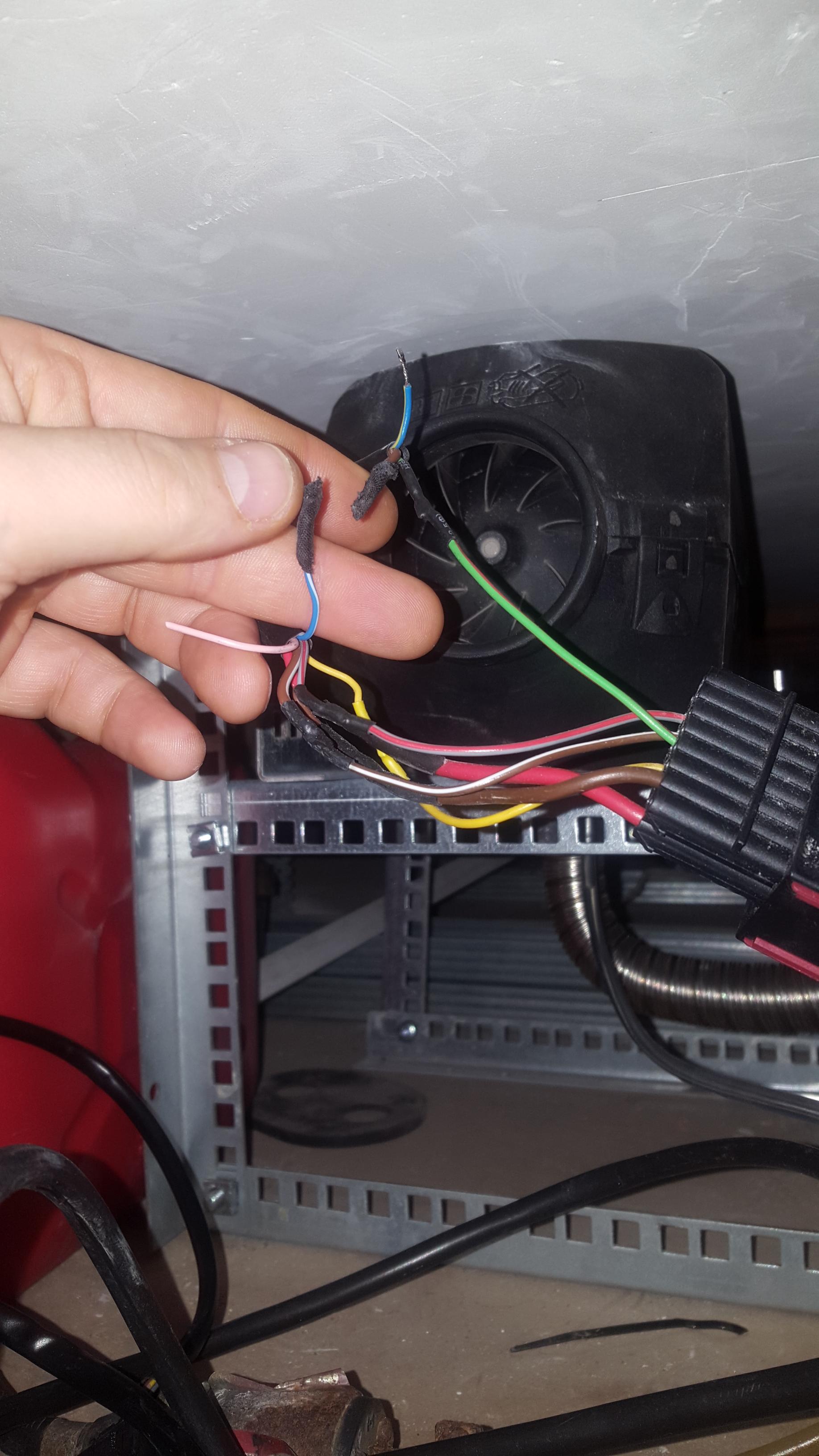

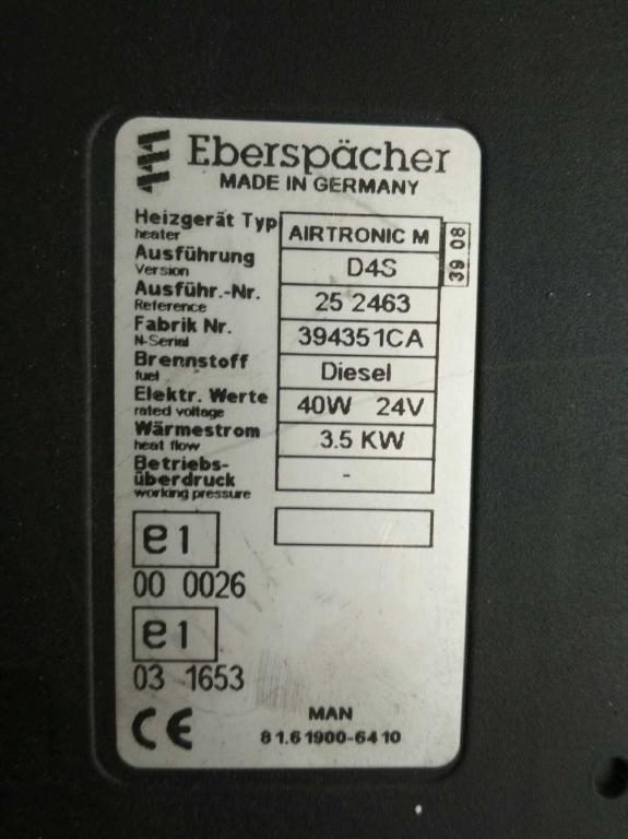

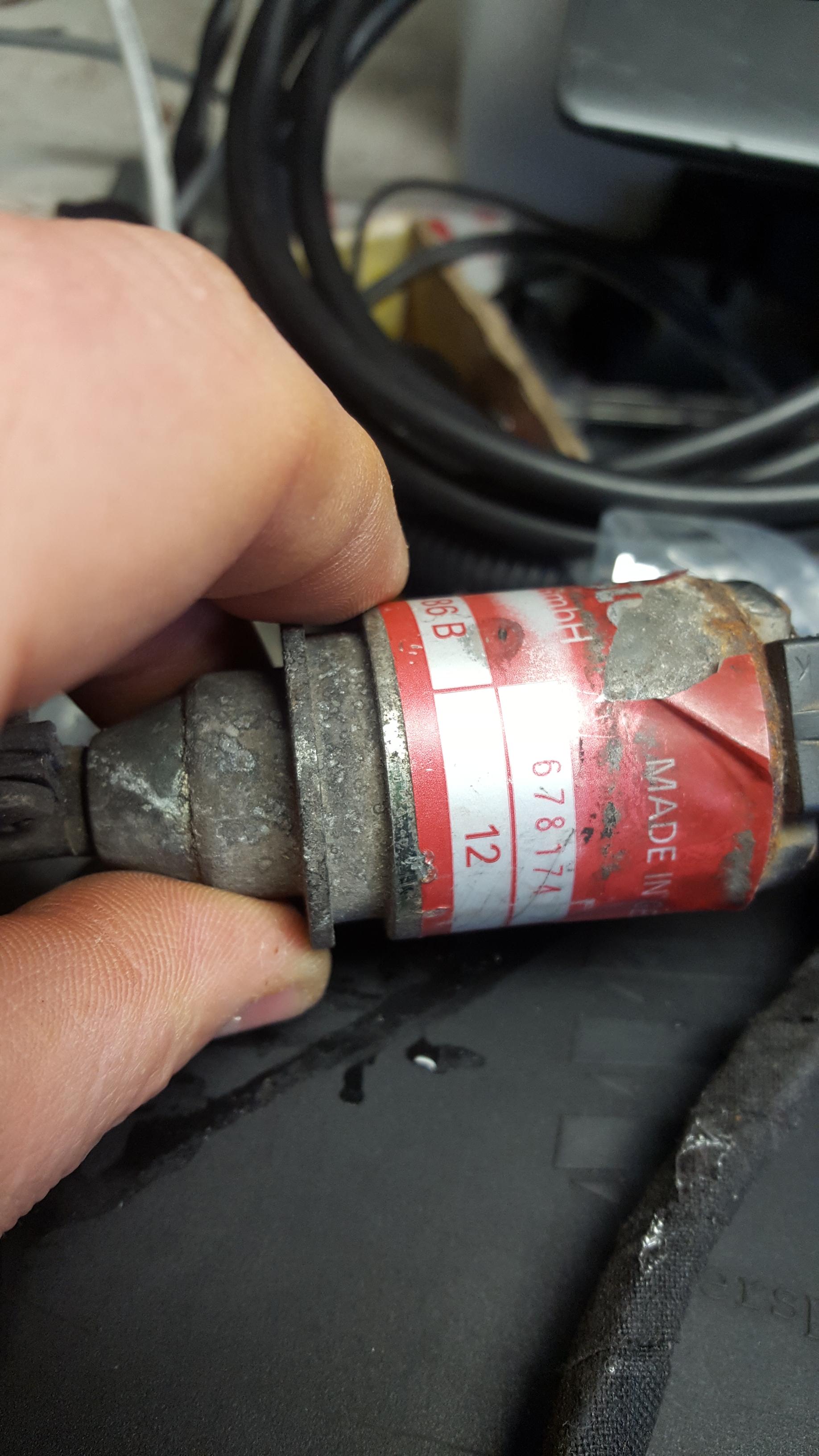

    Hello colleagues!
    I got an Eeberspracher heater, model AIRTRONIC M D4S, disassembled from the MAN truck. The set includes a driver, and both he and the device have only dice, no description. I got the driver somehow but I have a question with the device, where is it when it comes to the colors of the cables?
    I am throwing photos below
    Eberspacher AIRTRONIC M D4S: Cable Colors, MAN Truck Heater, Driver & Device Details Eberspacher AIRTRONIC M D4S: Cable Colors, MAN Truck Heater, Driver & Device Details Eberspacher AIRTRONIC M D4S: Cable Colors, MAN Truck Heater, Driver & Device Details Eberspacher AIRTRONIC M D4S: Cable Colors, MAN Truck Heater, Driver & Device Details

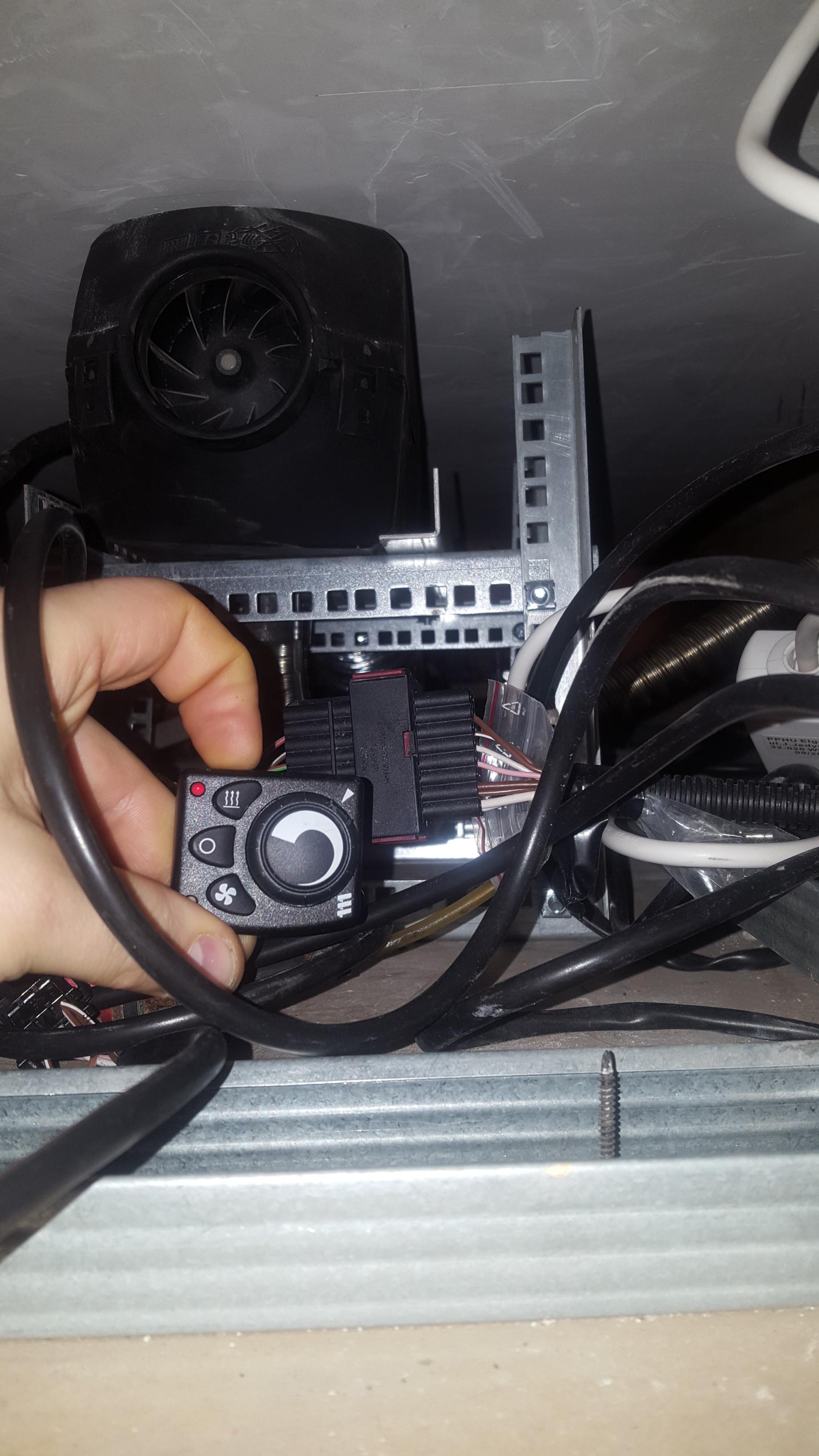

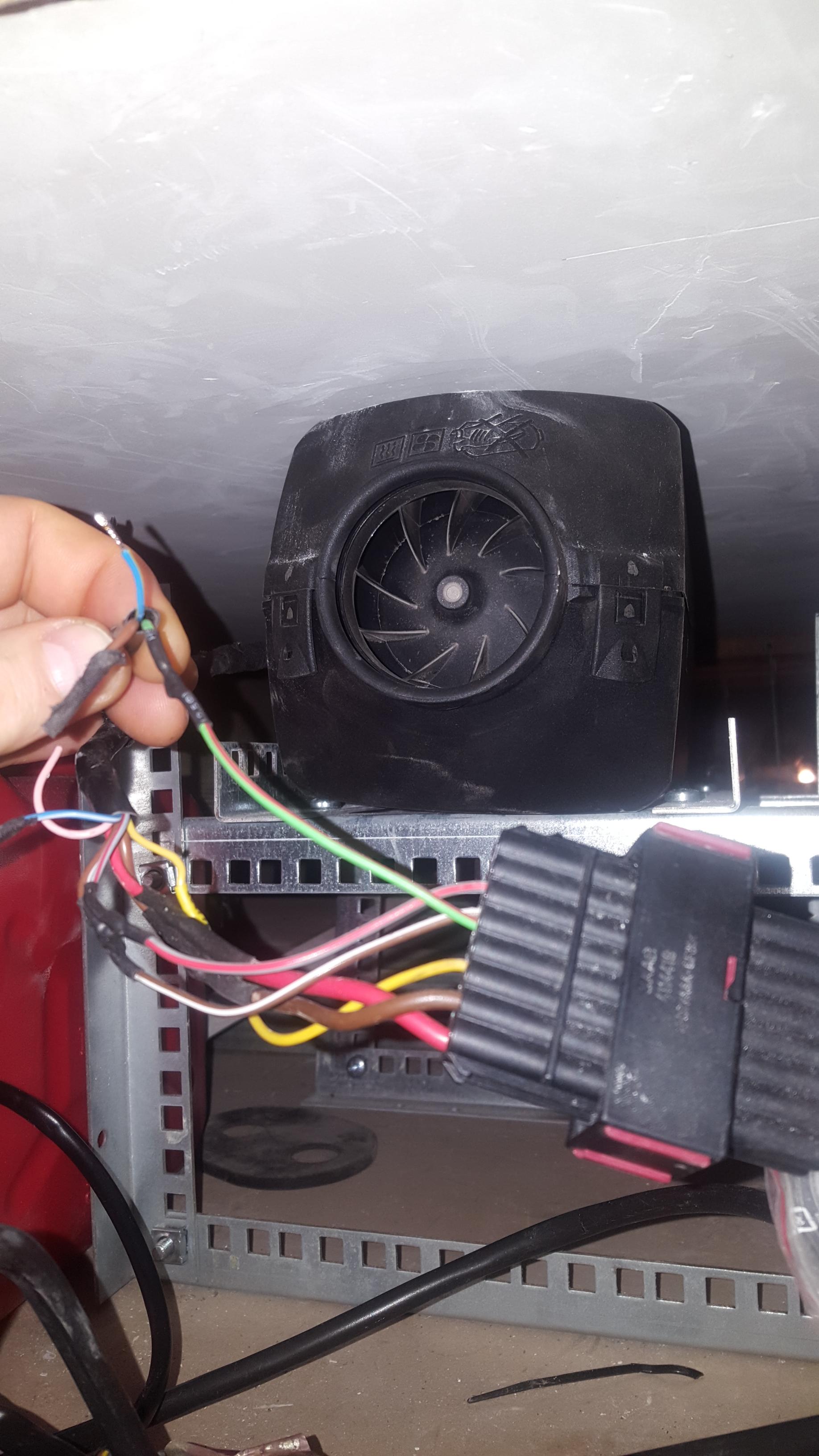

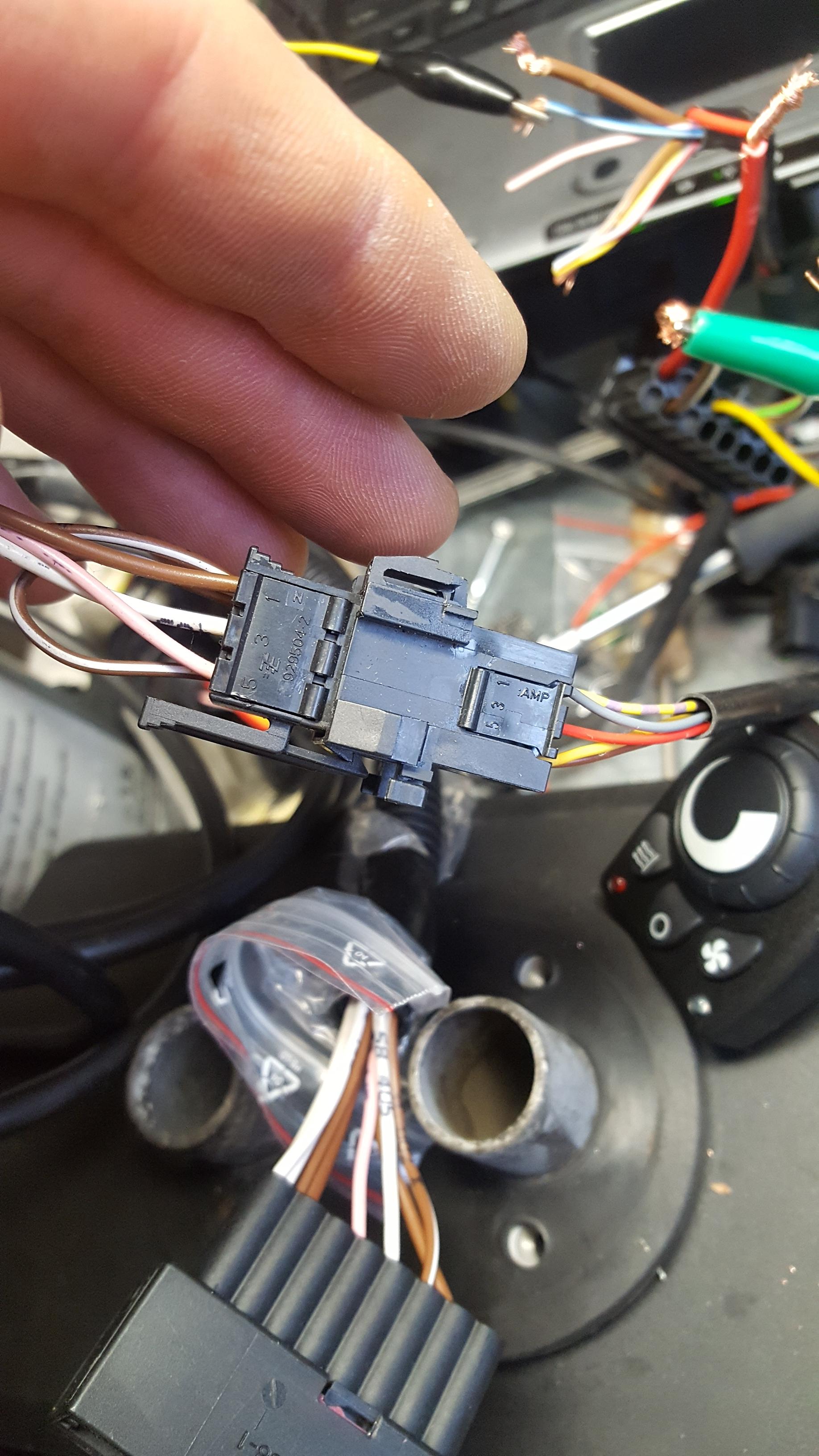

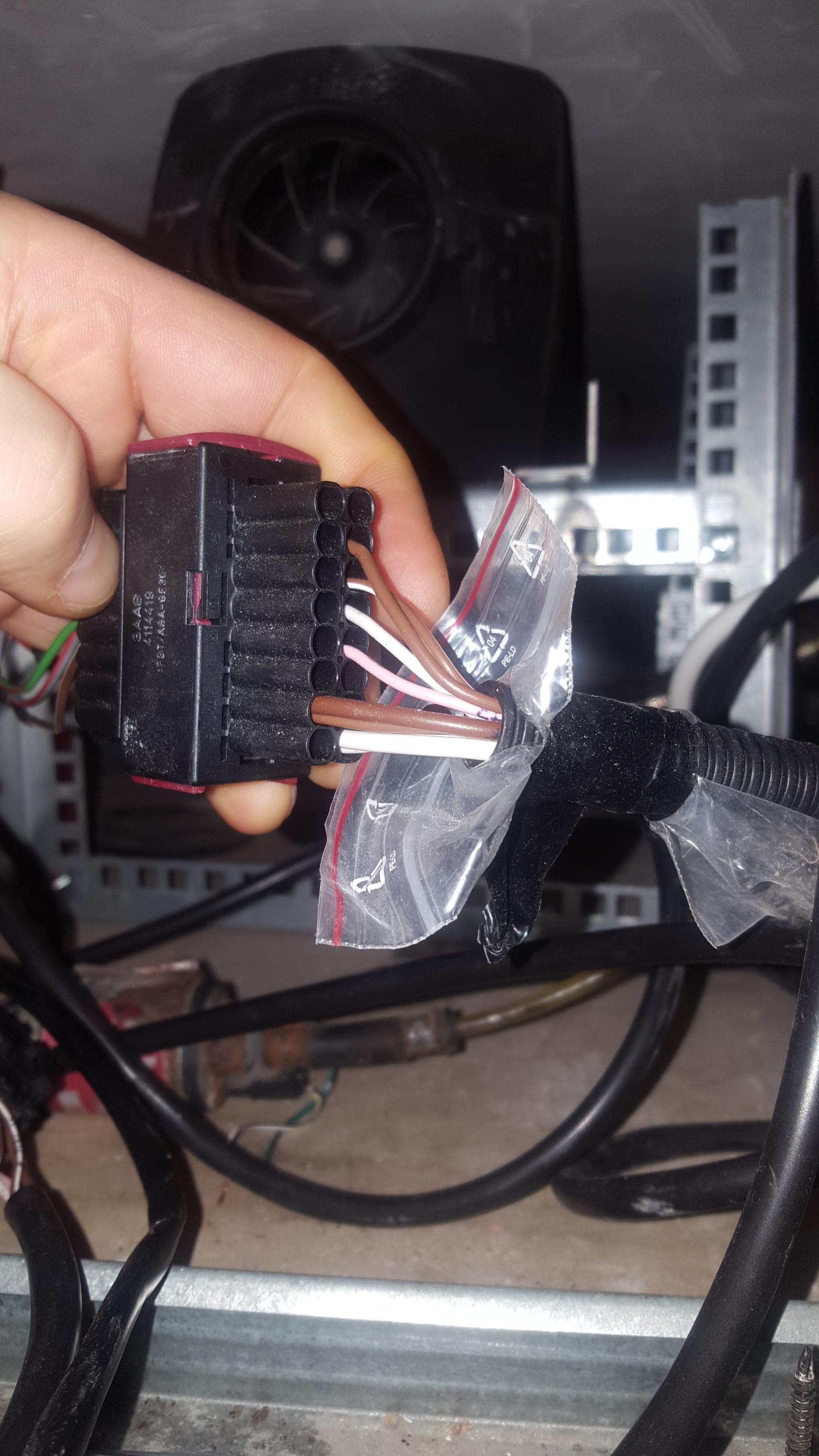

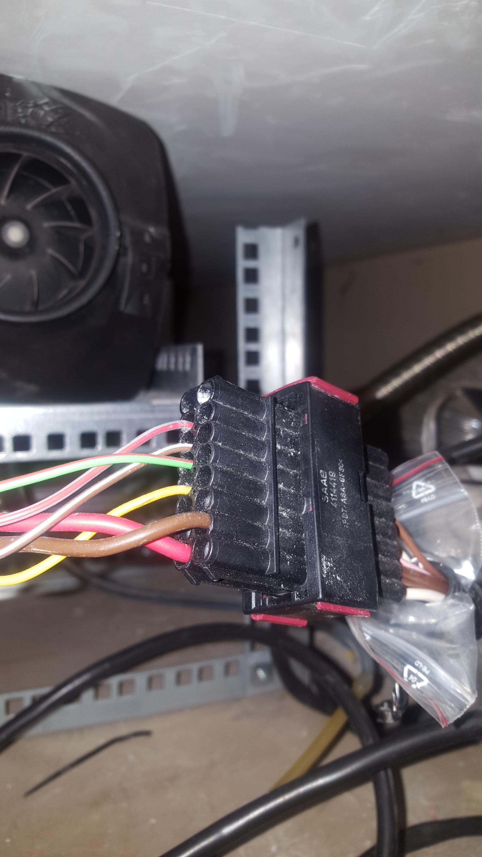

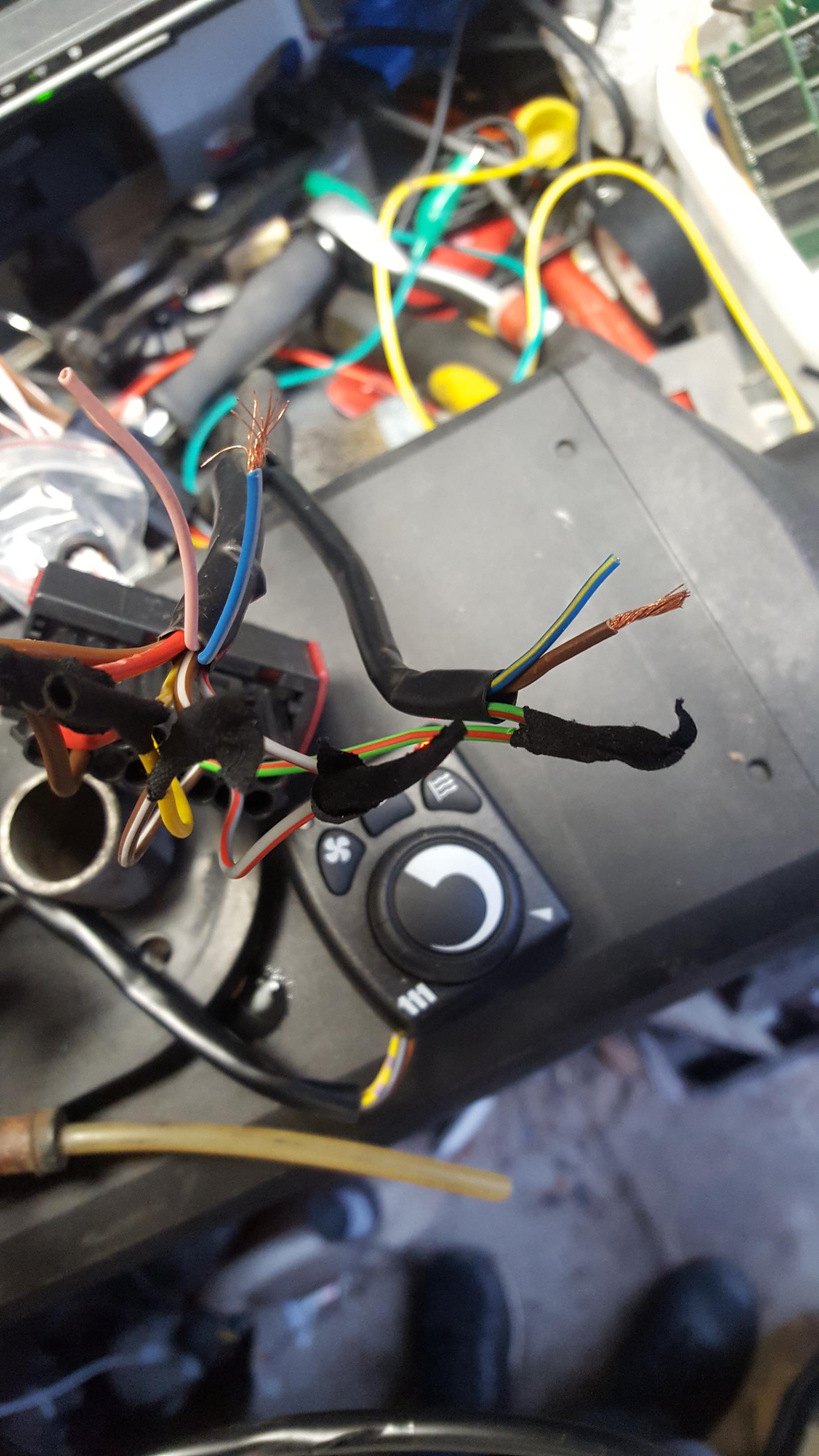

    thanks magik332 from the description but I have a cube from Man and I have these colors
    red gr and 2 brown thick and a pump (green / red) ok ... but to turn on and the rest - I suspect that blue / white is a diagnosis - I would take off the casing and get according to the description but it has seals and lime ...
    • Eberspacher AIRTRONIC M D4S: Cable Colors, MAN Truck Heater, Driver & Device Details WP_20180104_14_40_47_Pro.jpg (466.54 KB) You must be logged in to download this attachment.
    • Eberspacher AIRTRONIC M D4S: Cable Colors, MAN Truck Heater, Driver & Device Details WP_20180104_14_40_13_Pro.jpg (509 KB) You must be logged in to download this attachment.
    MAN heater diagnostics on blue-yellow cable
    #3 16951084
    SP7SEC
    Posts: 1011
    Help: 110
    Rate: 410
    Hello, this driver is not from this set, if you want to start it, for example using the easystart E. The watch from the photo implements the switching mode by providing 24v on the yellow cable, and you do not have one in the set. I am also 100 percent not sure if it will fire like this because I can also see CAN lines and she can block ADR and provide information about the fuel level because with these new inventions, even in the websites they are not able to say how it really is. By the way, the diagnostics in Man are on the blue cable with a yellow stripe

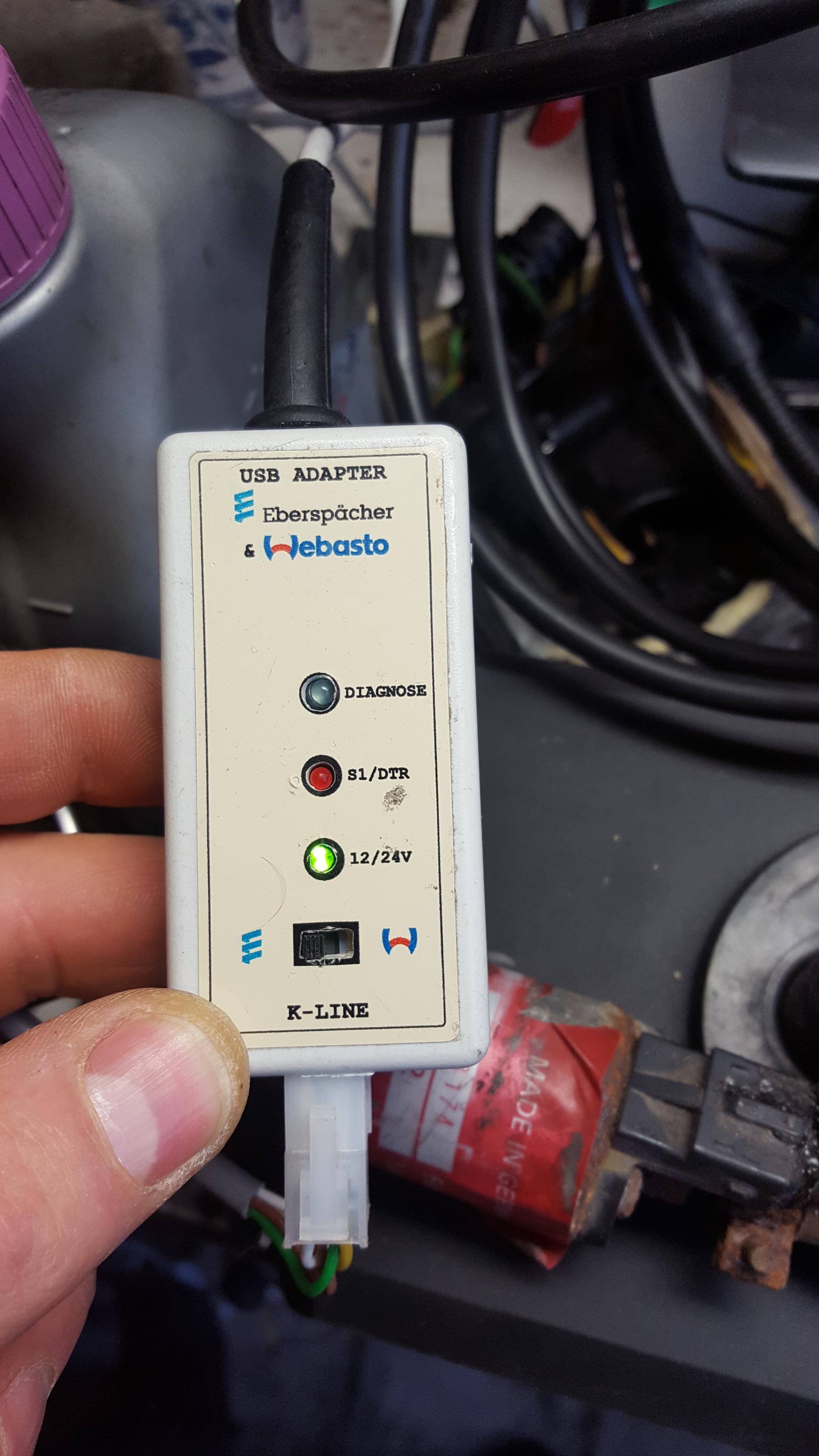

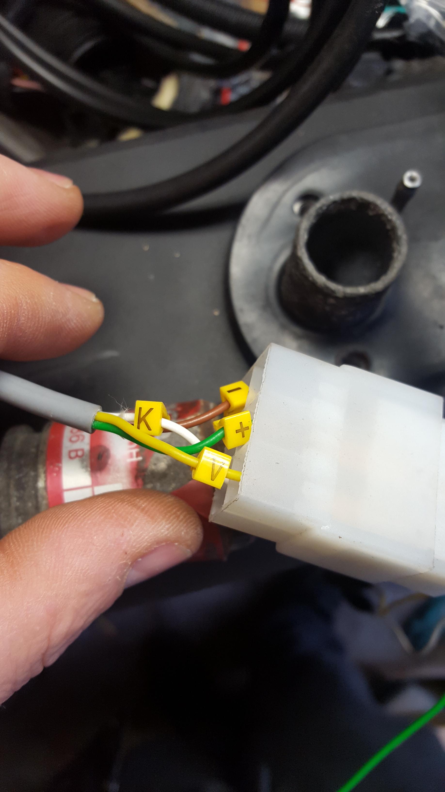

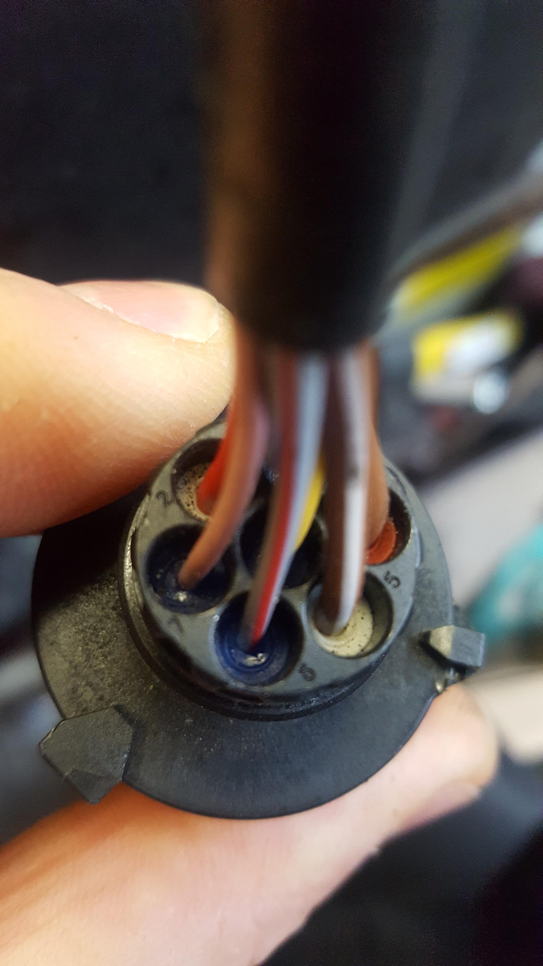

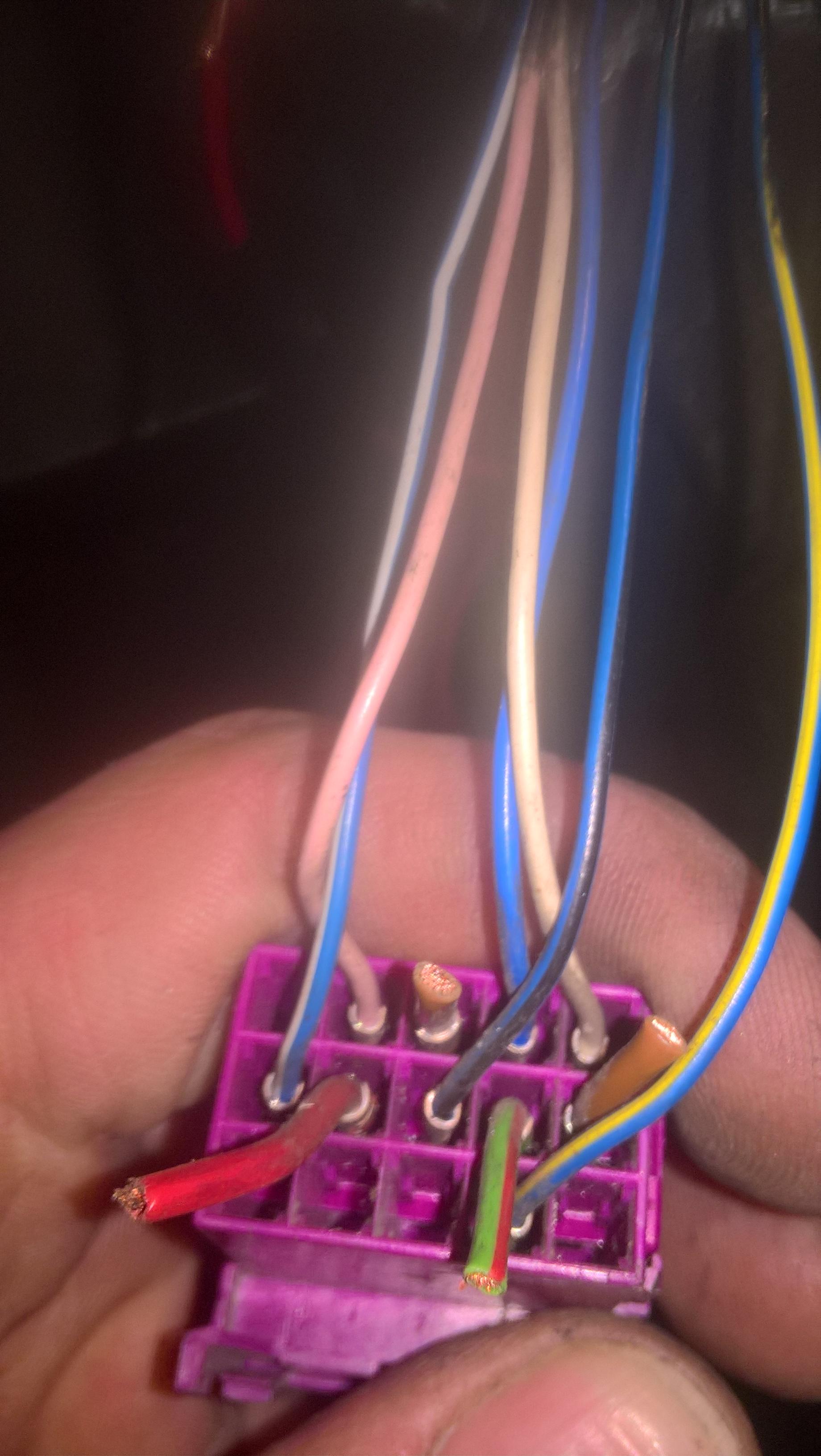

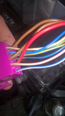

    By the way, I will connect to the topic.

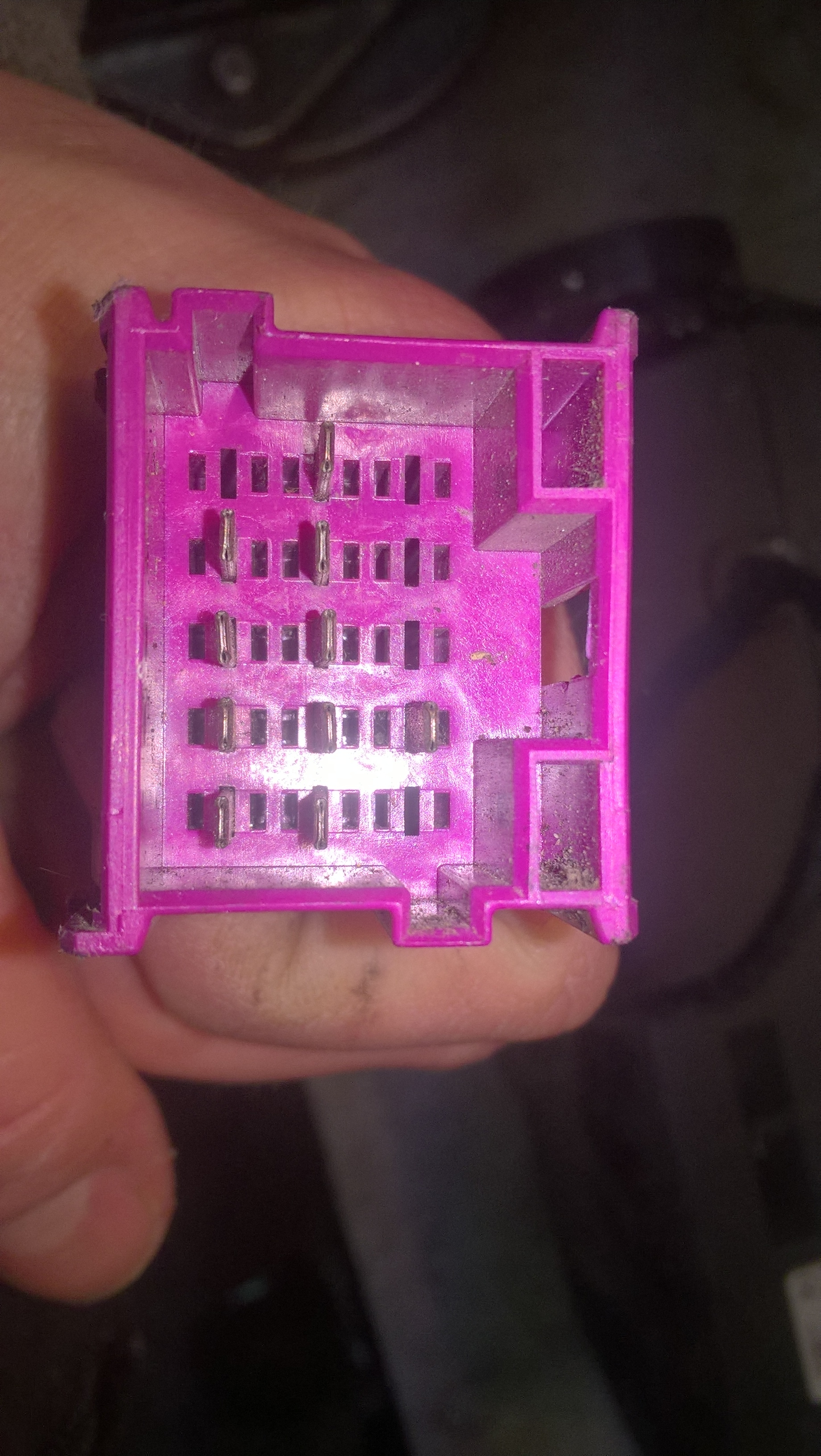

    my patient D4S from Mercedes two original round plugs in the photo. I bought a harness with a micro switch, heating / ventilation and a knob. The stove does not start yet - something is heard when turned on as if a relay and that's all, I'm waiting for a fuel pump from eberspacher because apparently from Webasto it will not go with this stove. Question because I have a webasto / eberspacher 12v / 24v interface I do not know how to connect the diagnosis in the rib and what soft this device to check. Do you need any drivers for the interface? EDiTH on xp somehow does not find the stove. I read that the diagnosis in white and blue should be connected, but I do not know if only K-line, why the wire marked V in the interface?. Below a few photos.
    • Eberspacher AIRTRONIC M D4S: Cable Colors, MAN Truck Heater, Driver & Device Details olx_image_2018-12-18_12-16-55.jpg (489.97 KB) You must be logged in to download this attachment.
    • Eberspacher AIRTRONIC M D4S: Cable Colors, MAN Truck Heater, Driver & Device Details olx_image_2018-12-18_12-08-26.jpg (429.2 KB) You must be logged in to download this attachment.
    • Eberspacher AIRTRONIC M D4S: Cable Colors, MAN Truck Heater, Driver & Device Details olx_image_2018-12-18_12-07-24.jpg (372.36 KB) You must be logged in to download this attachment.
    • Eberspacher AIRTRONIC M D4S: Cable Colors, MAN Truck Heater, Driver & Device Details olx_image_2018-12-18_12-05-05.jpg (440.36 KB) You must be logged in to download this attachment.
    • Eberspacher AIRTRONIC M D4S: Cable Colors, MAN Truck Heater, Driver & Device Details olx_image_2018-12-18_11-53-24.jpg (449.07 KB) You must be logged in to download this attachment.
    • Eberspacher AIRTRONIC M D4S: Cable Colors, MAN Truck Heater, Driver & Device Details 20181218_110722.jpg (551.15 KB) You must be logged in to download this attachment.
    • Eberspacher AIRTRONIC M D4S: Cable Colors, MAN Truck Heater, Driver & Device Details 20181218_101851.jpg (417.59 KB) You must be logged in to download this attachment.
    • Eberspacher AIRTRONIC M D4S: Cable Colors, MAN Truck Heater, Driver & Device Details 20181218_101859.jpg (426.1 KB) You must be logged in to download this attachment.

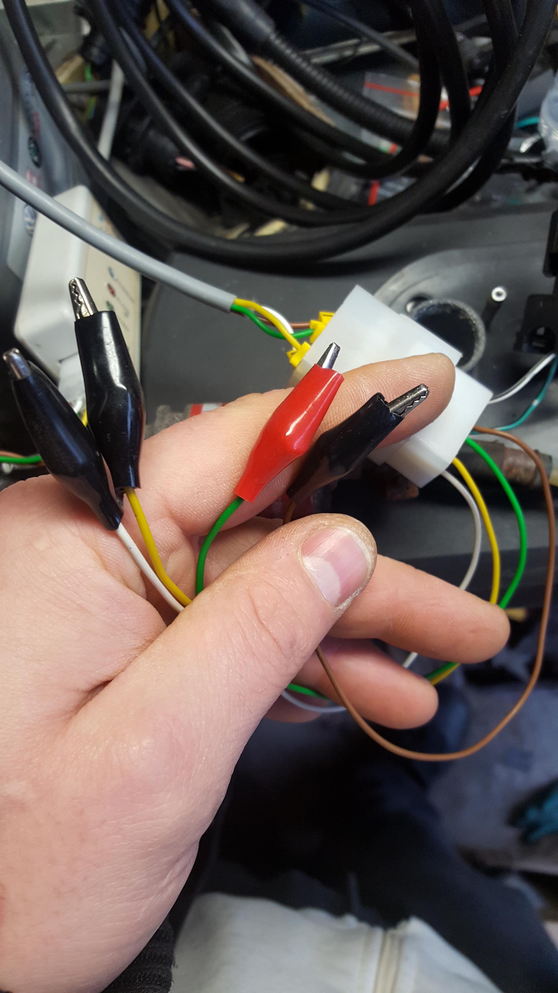

    Approx. topic resolved. bundle and mini controller bought on a well-known website with advertisements - a small hint from a seller from Starachowice. MTM-Wrocław fuel pump, maybe I was unlucky because she returned to complaints. Below are photos how to connect the contraption.

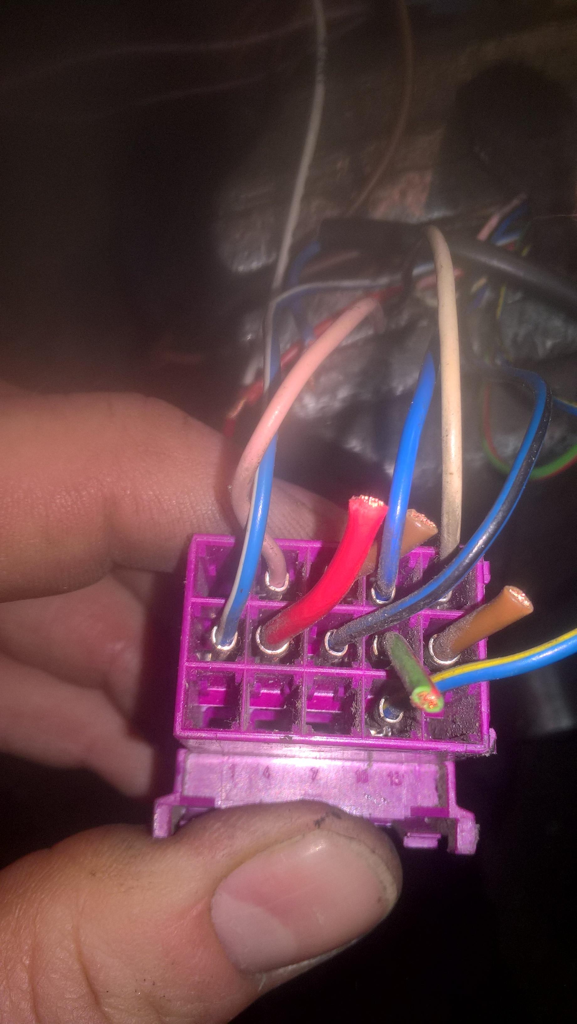

    I need an AIRTRONIC M D4S pinout from MAN. - will you help?

    mine is from Merca, round plugs, so in all-rawno you have yellow, blue, green, brown, red, pink. etc etc. color into color and ride. my plug is shown too, so you shouldn't have any problem. And Man's service diagrams, I doubt anyone has. If you want, you can do it from me. brown mass red 12v. white and blue diagnosis at the beginning .....
