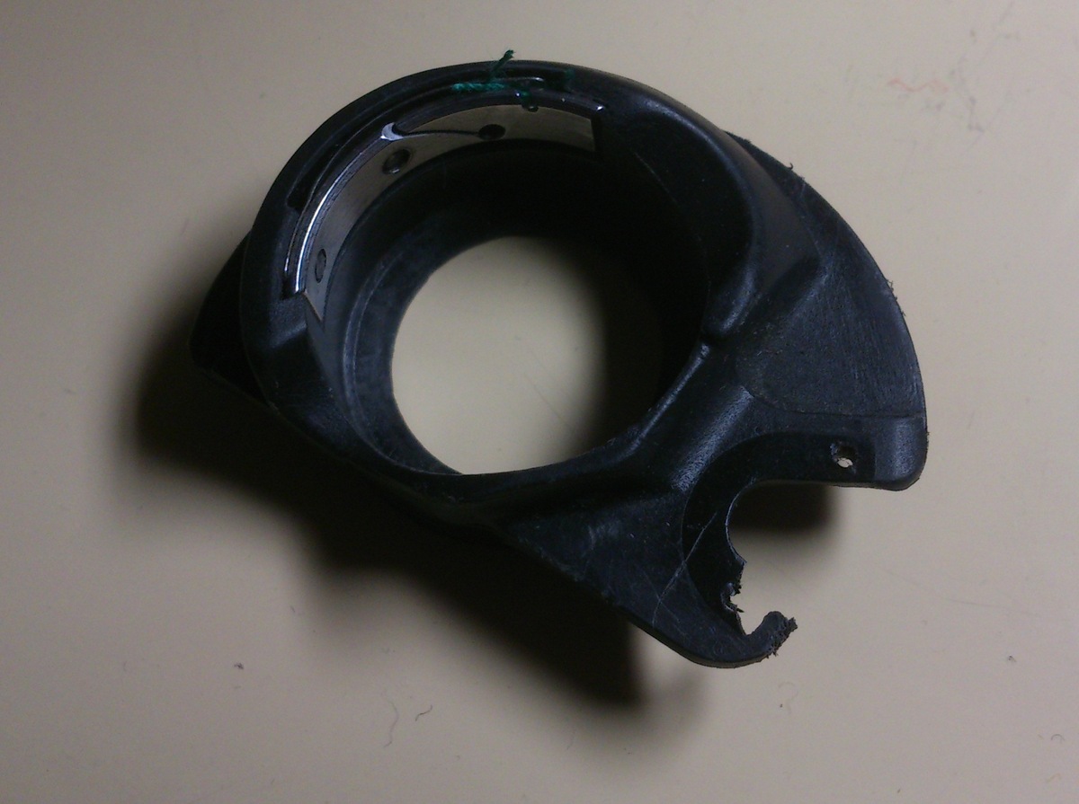

    I bought a second-hand Łucznik 884 sewing machine.
    The machine is operational, but requires repair or adjustment.

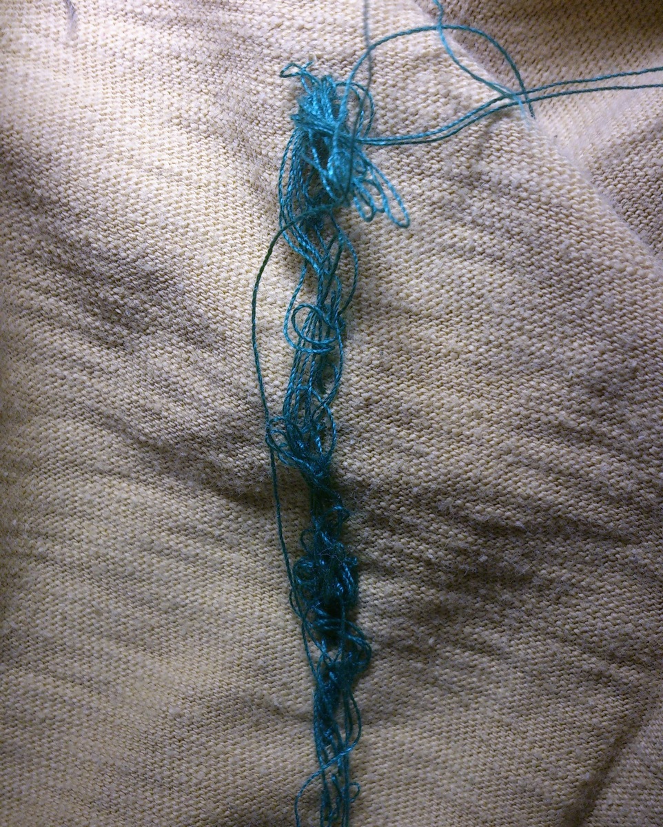

    The machine sews, but tangle the threads from the bottom, at best the bottom seam is loose.
    I read threads about adjusting this machine and followed all the instructions, but the problem remained unresolved.
    I am enclosing a few photos presenting the problem.
    As you can see in the photos, the underside of the threads is tangled or the seam is loose, while the seam looks normal from the top.
    I adjusted the tension of the upper thread, but it didn't change anything.
    I took out the bobbin case, it turned out to be chipped, as shown in the last photo. However, I don't know if this can be the cause of these problems or if it has an impact on sewing quality.
    If this can be the cause of these problems, I will get a new drum, but I'm afraid it won't get the job done.
    Thank you in advance for your response.

    Loosen the bobbin thread tension in two to three steps and adjust the stitch width to 3. Loosen the presser foot slightly. it should be OK . As for the eardrum. It must be intact and undamaged

    Such damage to the bobbin may cause the thread to catch on a dent while sewing, and the stitch will be wrong or the thread will break,
    You must first a new bobbin and then adjust the stitch.

    Thank you for your answers, I will equip myself with a new drum and we will see if it is enough. I wonder how to loosen the thread in the bobbin case. I know how to loosen the upper thread, but I do not know how to adjust the bobbin thread tension.
  • #5 12848334
    wiesław67
    Level 21  
    Posts: 378
    Help: 39
    Rate: 400
    Looking at the screws on the side of the bobbin case, adjust with the left screw.
    Tension should be minimal.
