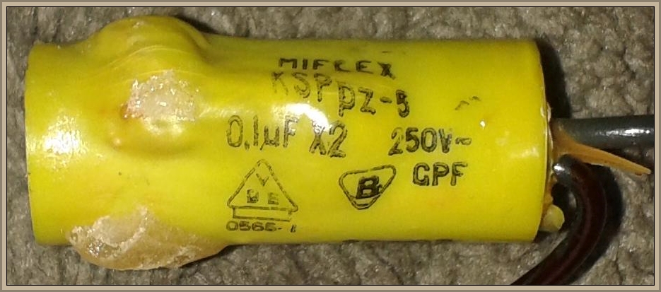

    What is the function of a capacitor in the pedal? Starting or filtering for the engine?
    Could it be the cause of engine starting / humming problems and engine warming up?
    After taking it out, it turns out that the capacitor has poured out, and the photo is attached. Instead of 0.1 uF, it is measured at 0.075 uF. Could this be the reason?
    Thank you for your attention regarding checking the motor current. I understand that more than 0.5A will mean damage inside the motor (lower resistance of the rotor / stator winding)? Can I measure the current in front of the pedal or behind? In my opinion, it does not matter, provided that the pedal is pressed all the way and the carbon resistors are bypassed by the metal plate in the pedal housing? I'm not wrong?

    This capacitor is anti-interference and replace it with the same. If the engine heats up and lacks power, it is defective.
