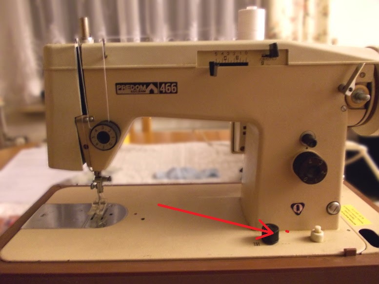

    Please help. I have a Łucznik 466 sewing machine. It worked impeccably. Today, while sewing, she stopped moving the material. When I pull hard, it sews, but with a very fine stitch. I make strange noises. I know nothing about sewing machines at all.
    I am asking for advice and help.

    On the right side in the lower part of the machine there is a knob and probably next to this knob on the head there is an engraved sign in the shape of a grid. This knob is used to disable the feed teeth from moving the material, maybe someone played with it and lowered the teeth down and they do not go above the needle plate.

    My machine does not have this knob

    Since there is no knob to turn off the teeth, the question arises whether it is Łucznik 466?
  • #12 15810082
    baska61
    Posts: 18
    Rate: 39
    he is an archer, he writes on it, the same as in the picture above, the place for the knob is only so it looks as if it was broken off, I got the machine from a friend who is no longer there

    Buddy wiesław67, not all 466 models have this knob. Check that the stitch length dial does not turn while sewing and that the reverse button is not pressed.

    I noticed that if I turn the stitch length knob, the back and front button is hidden. Maybe it's a connection?

    This is what happens with the so-called button. reverse gear, when reducing or increasing the stitch length, the reverse button moves. When we increase the stitch length, the button extends, when we decrease, the button retracts.

    I will not insist on the undo button, but I think that the only child is as I wrote. Although I may be wrong. As for the stitch length dial, this is because the dial is too loose. It should rotate with a lot of resistance, then the spring that moves the retraction button back cannot turn the stitch length knob.

    Stitch density is affected when the length adjustment knob is turned loosely. Therefore, when we set the knob, e.g. to "2", then when sewing, for example, thicker material, the teeth move the knob to max. stitch length. The teeth move the material to the length set on the stitch length dial. The presser foot presses the material against the teeth when sewing. The whole problem is in the loosely turning stitch length dial. I would recommend giving the machine to a professional.

    Hello. I don't remember exactly, but so that the knob does not have longitudinal play, it is secured with a ring. When you unscrew the top cover, looking from above, you will see the stitch knob outside the machine and the rest of the stitch knob (knob shaft) in the inner part of the machine. On this axis, inside the machine, at the very body of the machine, there is a ring with two counter screws in it, and between this ring and the machine body there is a cup-shaped washer. Now you have to press the outer knob to the body of the machine and at the same time the loosened inner ring on the shaft is also pressed to the body until the washer becomes flat. At this point, tighten the screws in the ring. Regards.

    I disassembled the stitch knob and it turned out that there are 2 washers (cups), one is cracked, I think that's the reason. I'll try to buy it and see if that was it. Regards.

    I disassembled the stitch knob and it turned out that these 2 washers (cups) are cracked. I replaced them with new ones and everything works, maybe someone will find this information useful.
