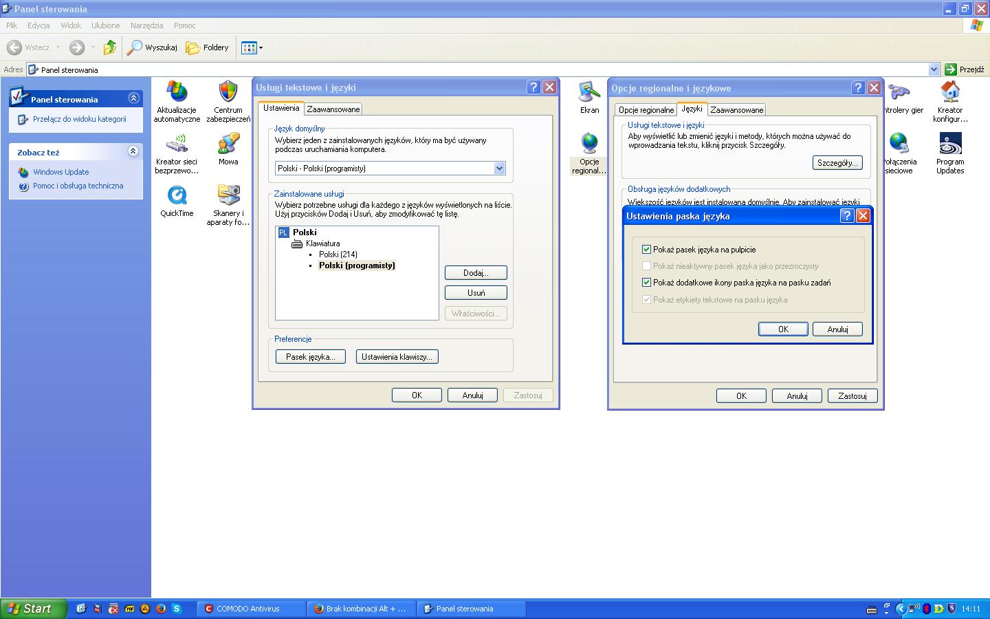

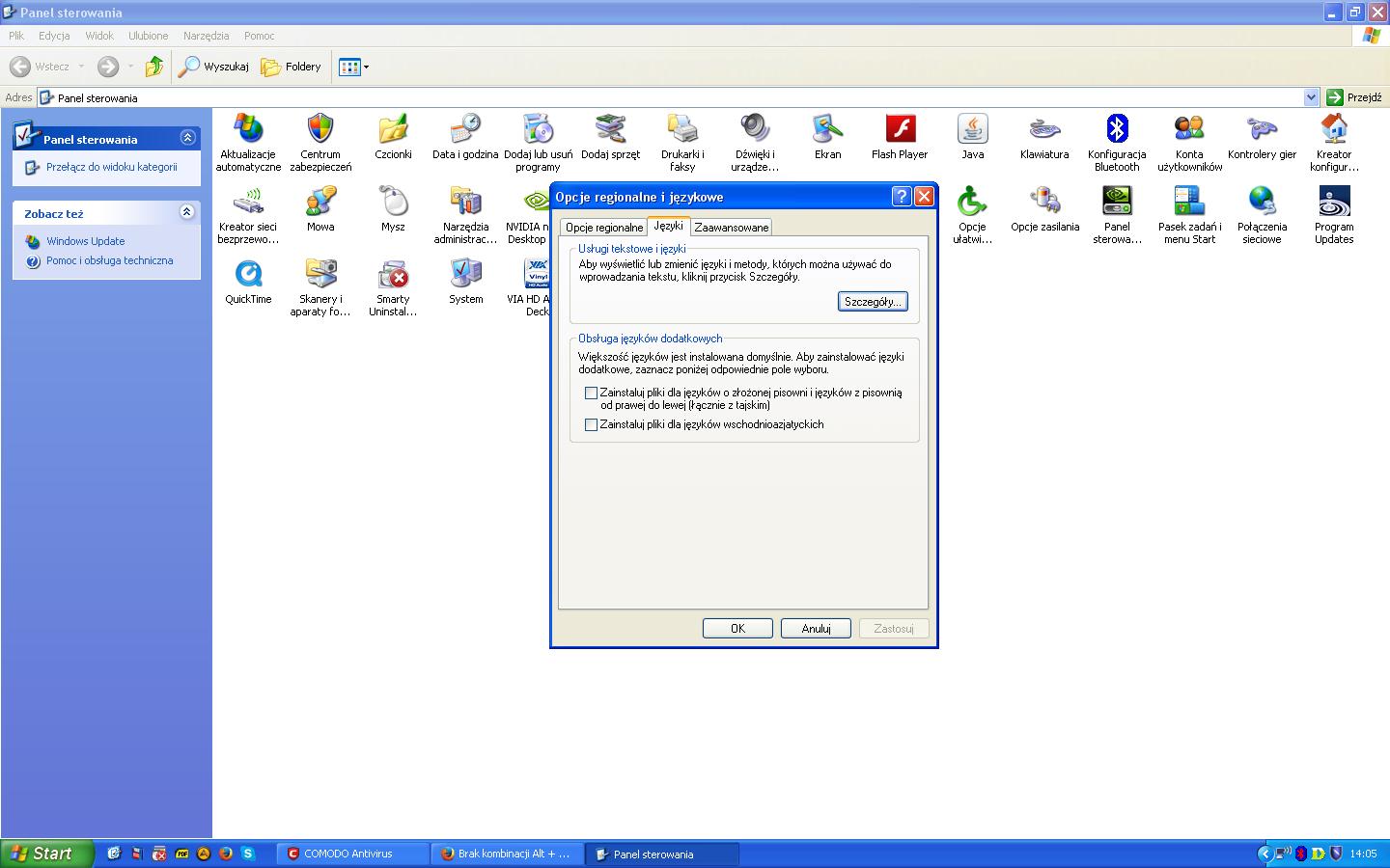

    Bubu_lbn wrote:
    I have tried all the combinations I found on the internet; alt + shift, alt + ctrl + z and stuff
    If y is instead of z then it's Ctrl + Shift.

    Bubu_lbn wrote:
    Someone told me that there is no such option that there is no Polish choice there and that this is the main reason for this.
    That someone was right. Polish (214) should be. Original system, without any modifications?

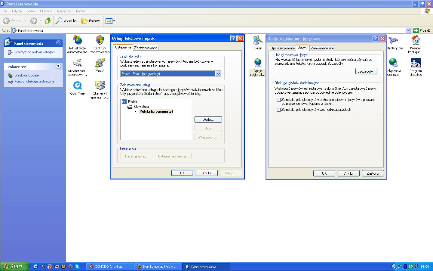

    Bubu_lbn wrote:
    how to get into these system services?
    and what is this for you? The colleague was most likely thinking about the shortcuts assigned to the graphics driver application. The default for ati is alt + c, and if you haven't assigned any others, there is no other option. Besides, write what system you are using. Do you have the language bar active? You can add the language (214) again, remove the Polish developer, and repeat the operation deleting 214. It should be back to normal.

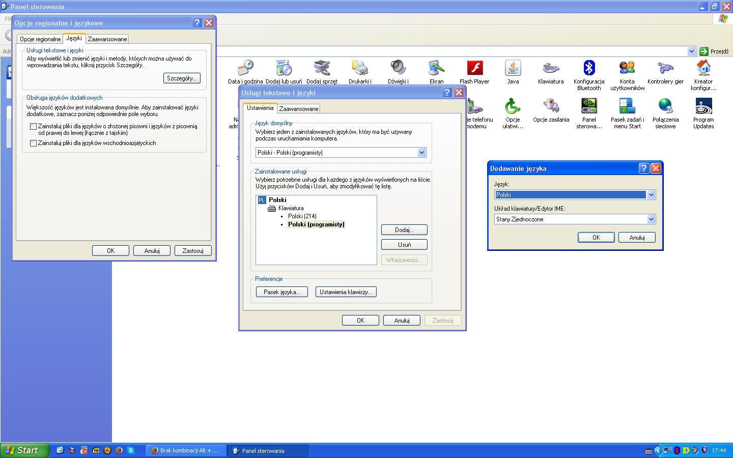

    Nobody is telling you. Just to refresh or change the order. Actually, we don't know what it looks like with a friend. A screen would come in handy. In any case, deleting the default language code won't do anything wrong. A moment later, it will add again and maybe it will work.

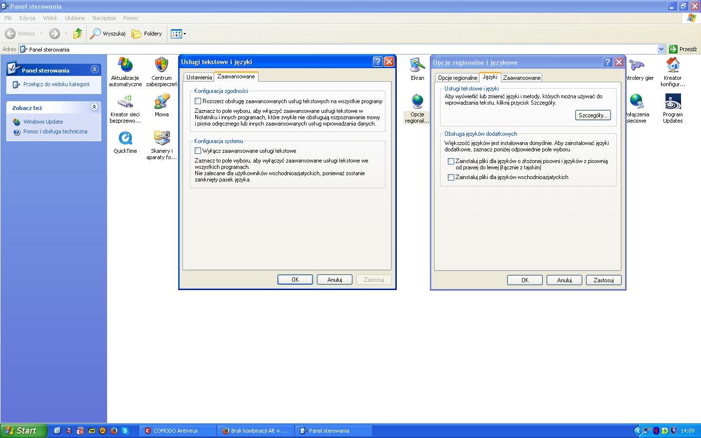

    Rate: 238
    Something you got so stuck to, those system services? You have a Polish programmer as the second one, so it doesn't work. Switch to it, and remove 214. Edit: Active developer, so it's ok. So remove both and then add again Polish programmer.

    Rate: 238

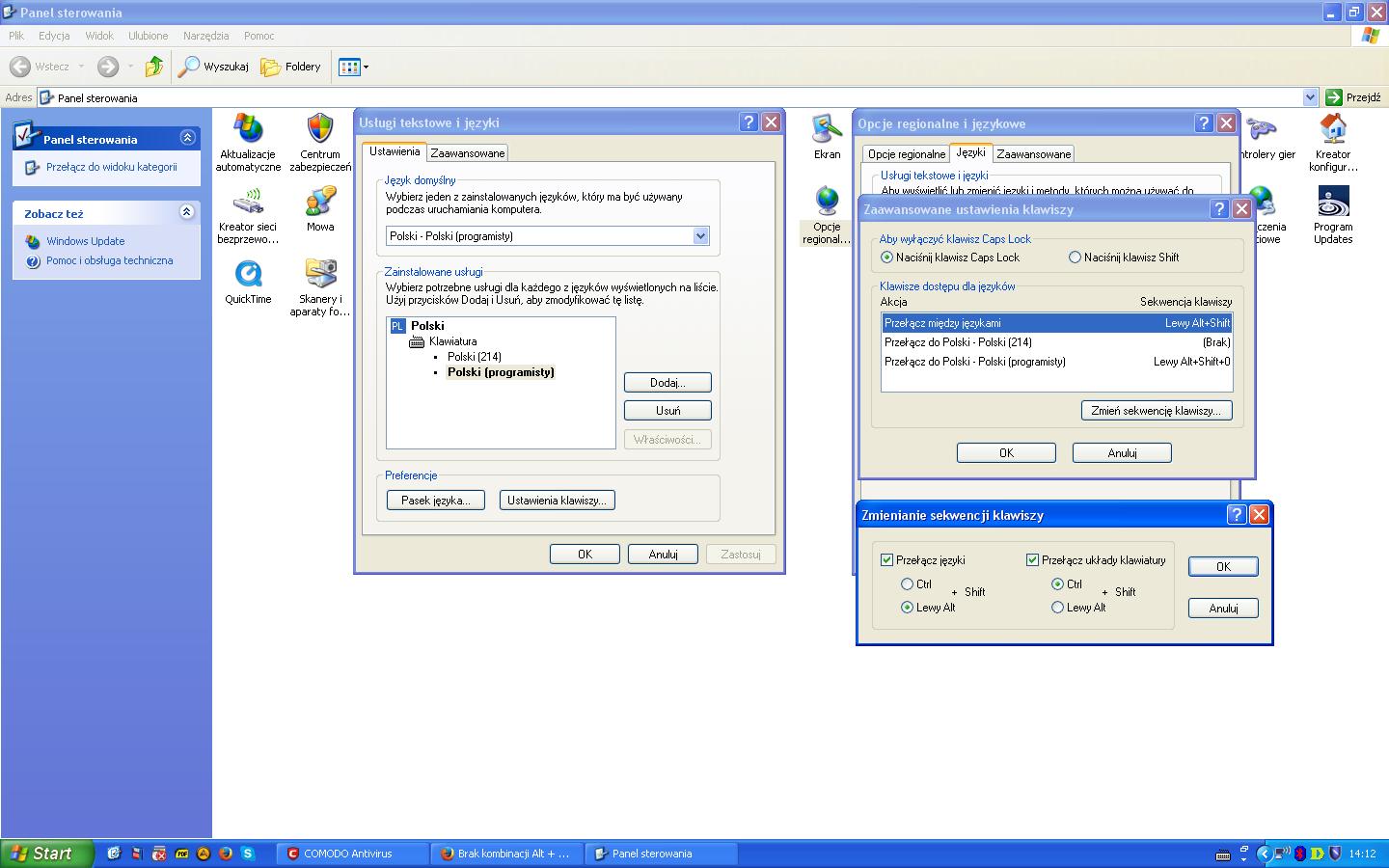

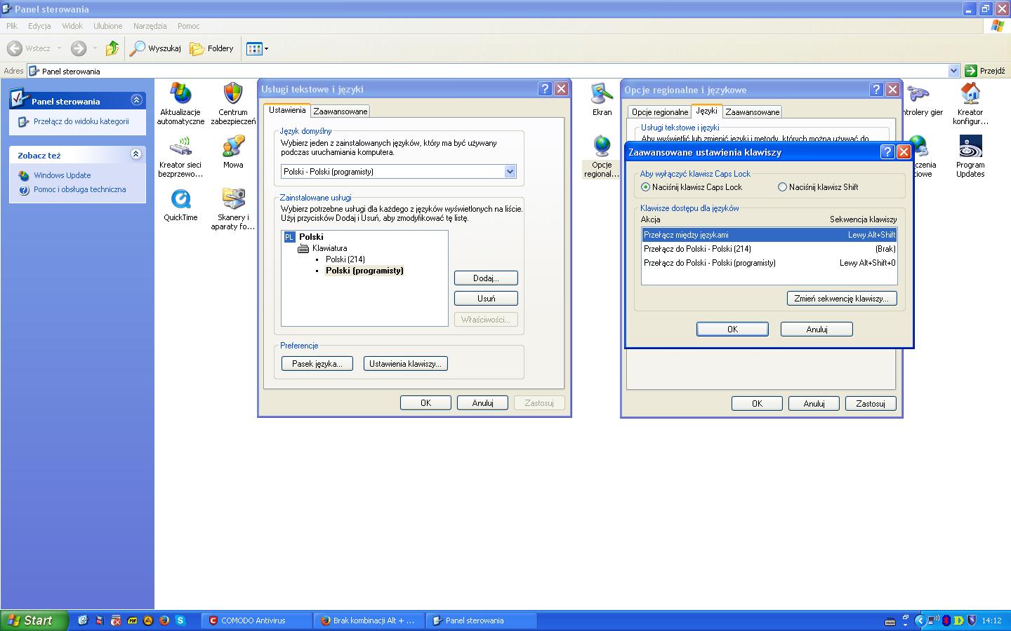

    gpedit.msc find user configuration-> control panel-> regional options. Check if any rules have been set up there. Besides, select the option in the language settings, the option of toggle keys. Set it selected and check.

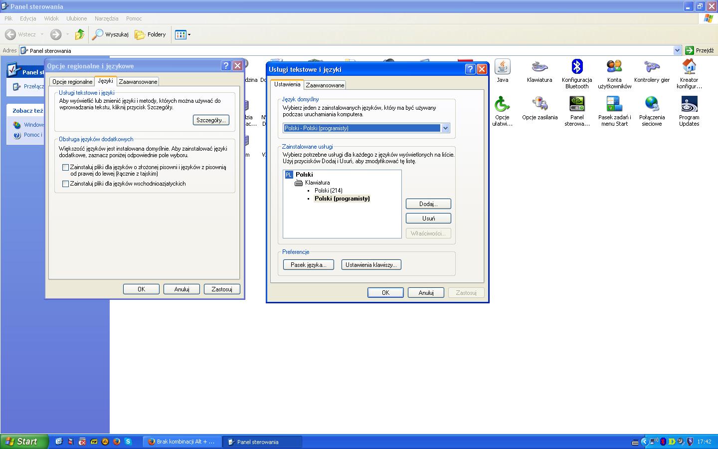

    Start the computer in safe mode, change the language to English, log out and log back into the system.
    Change the language of the programmer to Polish and check how the keys work using the on-screen keyboard.

    You can always retrofit, but that's less important. How does the on-screen keyboard behave?

    So the signs on your system are there, which could mean you have a broken keyboard - replace it with another one and check.
