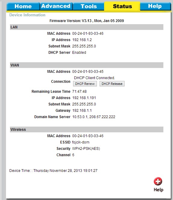

  • #14 13003254
    icoverty
    Posts: 20
    However, I still have a problem ... I bought this WRT, I tried to configure it 10 times according to this page and after connecting to the TV or even on a laptop when I have wi-fi turned off, there is no internet access ...
    Best WiFi to Ethernet Adapter for Connecting TV and Tuner Without Built-in WiFi
    I don't know if it should do this either, but instead of assigning an ip in the 192.168.1.xxx range, it allocates some 169. (I don't remember any further), but I don't know if it should be like that or what. You can never see it on the link (but it probably should be), and when it accepts everything, it will save and restart WRT, then I can not enter it anymore and I have to reset it (in the back). I don't have the strength to do it anymore
  • #16 13003392
    icoverty
    Posts: 20
    dlink di524 - the one I currently use wi-fi and which I want to connect to WRT
  • #20 13007751
    icoverty
    Posts: 20
    Somehow I got it and everything seems to be fine, I just have to enter everything on the TV manually.
    Only one thing puzzles me. Previously, dlink automatically assigned ip and played and roared, and now when it assigns, it gives me ip WRT as DNS (so no internet), after manually setting everything goes without any "but" :) however, I do not want to play with it anymore, set the ip manually, no problem, and on the "network" I even see the TV (when it is on), I have access to the settings of both router via wi-fi :) so it's OK :)
