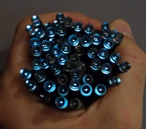

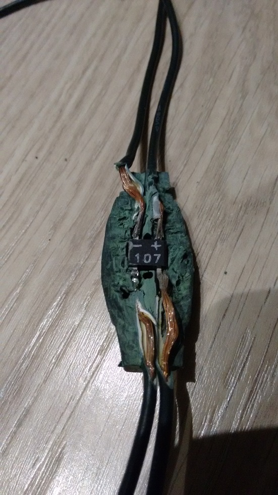

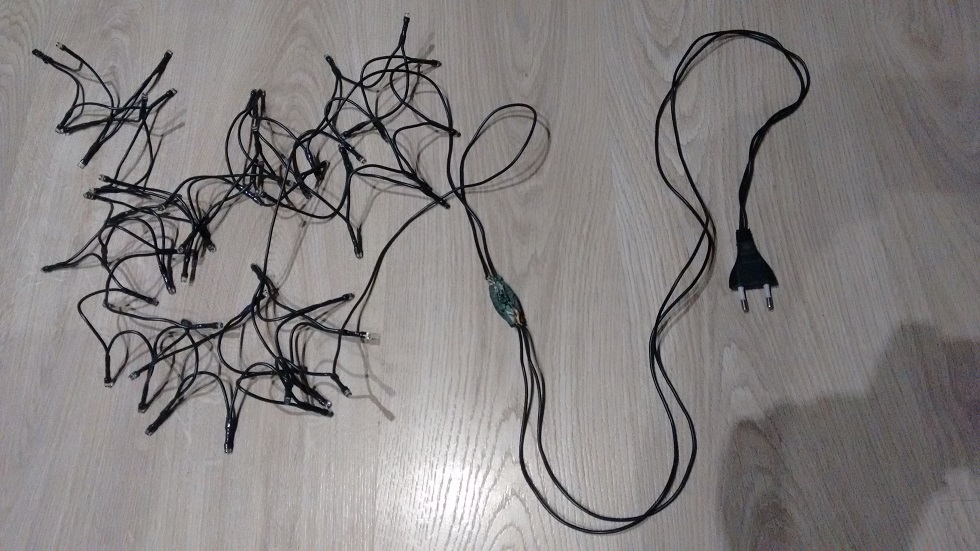

    Hello, while the lights were suddenly shone stronger now they only glow.
    I took the casing apart from the element visible in the picture, but I don't know what that is, maybe the element is the reason.
    I am asking for hints on how to diagnose the cause.

    It is a bridge rectifier (Graetz). Check it with a meter.

    It's just a rectifier. Damaged, replace.

    Thanks for the answers, I checked the bridge with a multimeter, it looks like it's working at the output is 220v. In that case it's probably one of the diodes. How to find the damaged one?

    yes, it would be best to check each diode separately. Alternatively, look at them under a magnifying glass, usually blown out will be visible, but not always.
    Generally these lights are terrible crap. In this system LEDs will not last long - no power source. It's enough if you have garbage in the network or too high voltage and as a result the LEDs will overheat / burn.

    These LEDs are production waste swept from the floor, it is not worth repairing.
    If one burns out and we make a jumper instead, the other diodes will automatically receive more voltage, which will shorten their poor life.

    Everyone writes that this is rubbish, not the author had a question. You have no other option but to check each one individually. The simplest method is to prick a meter or a battery with these pins. Of course, disconnected from the mains voltage.
  • #8 16252863
    radelek
    Posts: 12
    Hello. Do as Witold5 writes, which is a bit laborious. I took each evening
    diode separately in hand and I checked carefully if I finally found one that did not
    glowed. After replacing it all lit up normally. Regards
