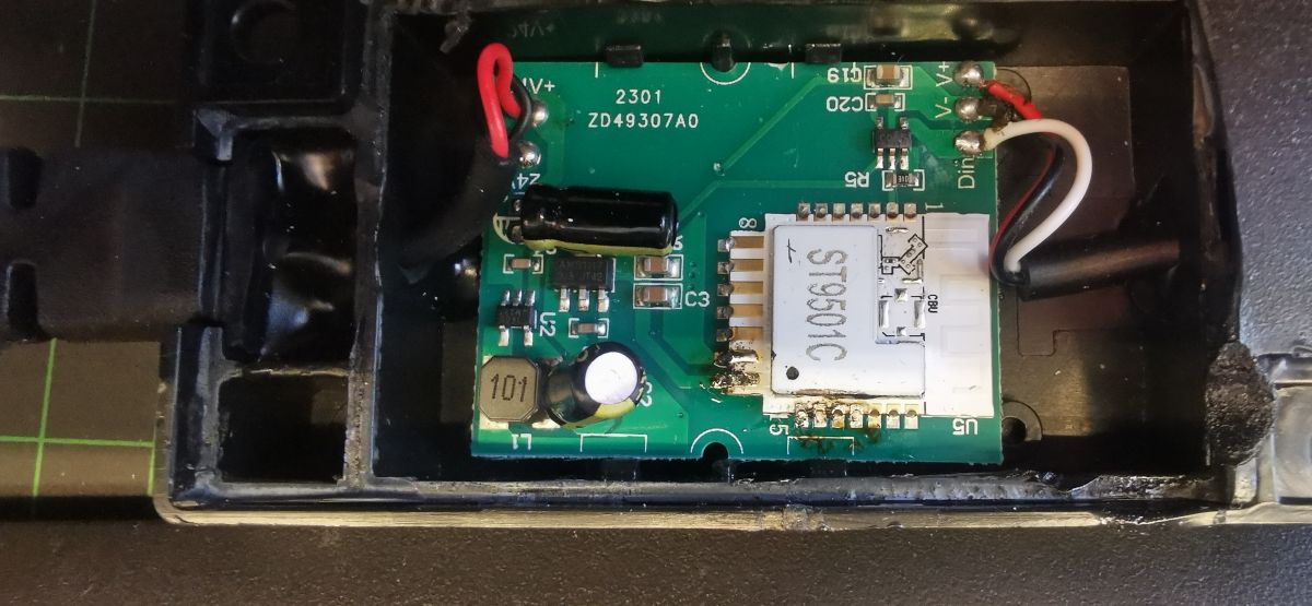

    Printed circuit board with connectors and electronic components inside a casing.

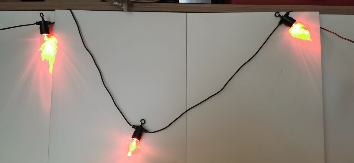

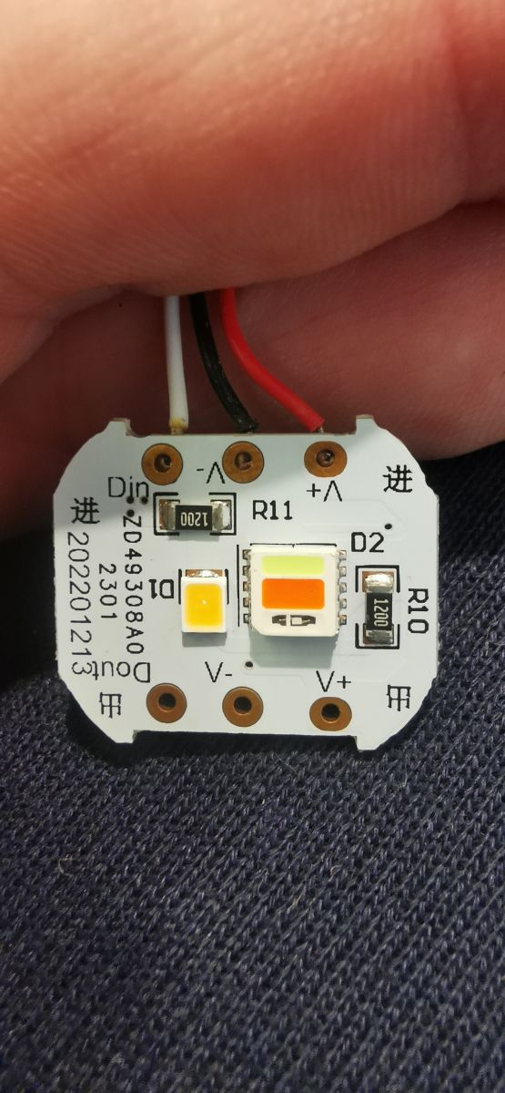

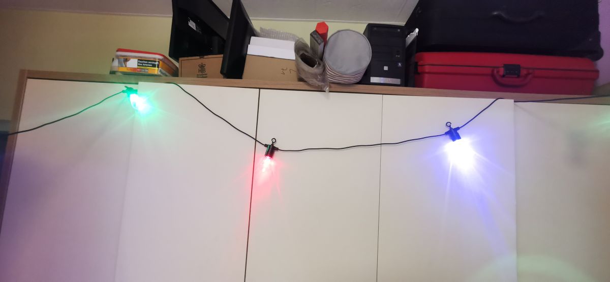

    Flashing was no Problem. But if I toggle on all LEDs have different colors. If I change to blue this is the result, one G, one R, one B and so on. That confuses me, normally all LED should have the same color.
    String lights with multicolored LED bulbs hanging above a cabinet.

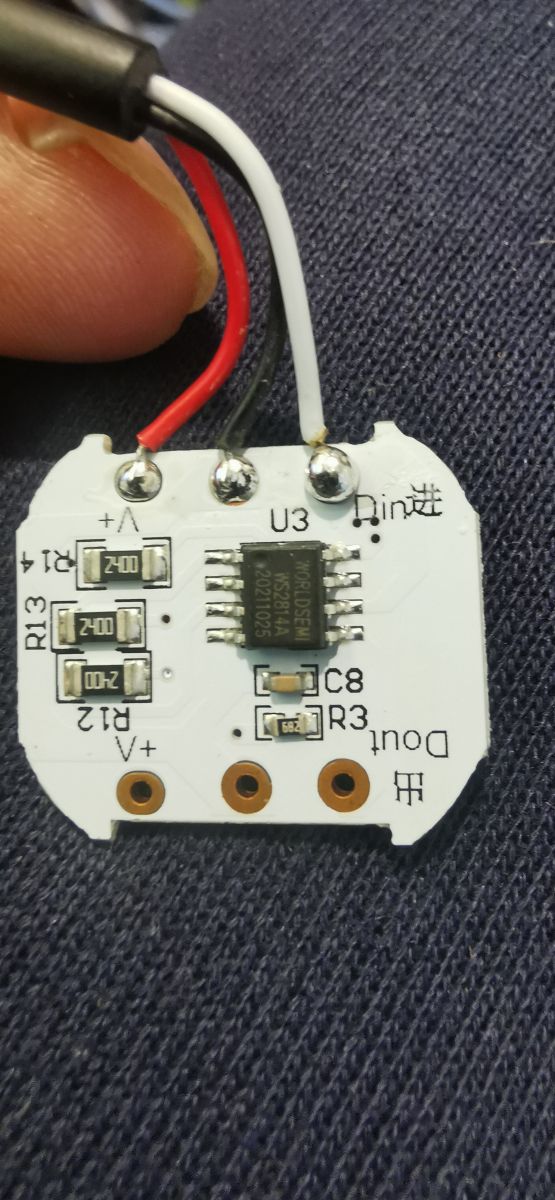

    Every bulb has one small chip with WS2814A
    Electronic module with LED setup and markings. Circuit board with WS2814A chip and wires
    The string works with SM1670P driver for RGB but CW and WW won't work
    PixelAnim works, but the LEDs are mixed up and there is no clean rainbow effect.
    I'm sorry, but I forgot to make a dump :-(
    Somebody out there who has the same String and bring it fully to work?

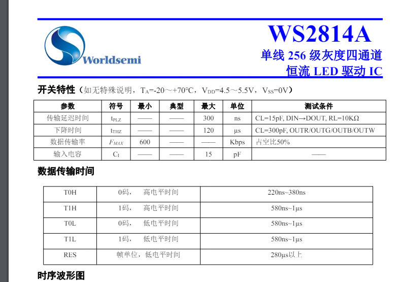

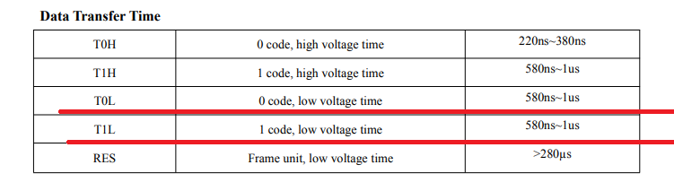

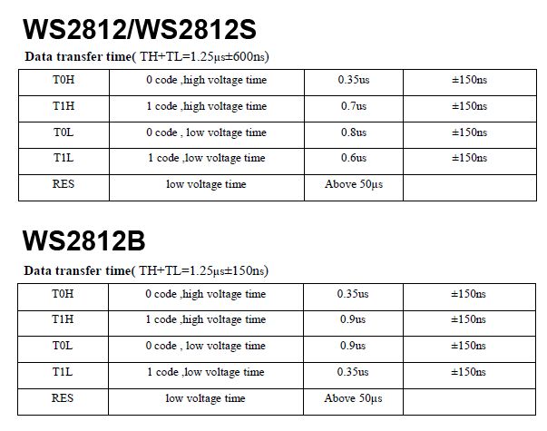

    Hello, are WS2814A timings the same as WS2812B?
    Technical datasheet for WS2814A with specifications and transmission timings.
    Comparison of data transfer times for WS2812/WS2812S and WS2812B.
    They look different, futhermore, it seems they have one mistake in the datasheet... hm. Maybe we need to adjust the driver.

    It still seems that there is an error in the datasheet:
    Data sheet showing a data transfer time table with a potential error.

    I've tried today to use the string with an ESP32 and WLED, with the settings WS2812 it works as I describe above, with setting WS2814 it works completely normally and the bulbs have all the same color.
  • #6 21141949
    Posts: 14770
    Rate: 12912
    So basically you've confirmed that OBK supports WS2812 but WS2814 is not supported?
  • #7 21141956
    marcolueck1976
    Posts: 32
    A string of lights with red and green pepper-shaped bulbs. I think i could say that, yes.

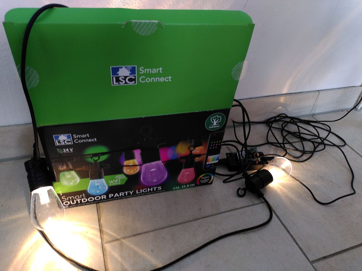

    I also got myself 2 of these string and I got them working by enhancing OpenBeken.
    At the time of writing this pull request is still open: https://github.com/openshwprojects/OpenBK7231T_App/pull/1736
    I seem to have a newer version than the original post. Mine has 5 channels RGB CCT. This is my configuration:
        "vendor": "LSC",
        "bDetailed": "0",
        "name": "Smart OUTDOOR PARTY LIGHTS",
        "model": "outdoor party lights",
        "chip": "BK7231N",
        "board": "CBU",
        "flags": "134217744",
        "pins": {
            "16": "SM16703P_DIN;0"
        "command": "backlog startDriver SM16703P; SM16703P_Init 15 RGBWC"
    For 4 channels try
    or
    backlog startDriver SM16703P; SM16703P_Init 15 RGBC
    as start-up command instead.
