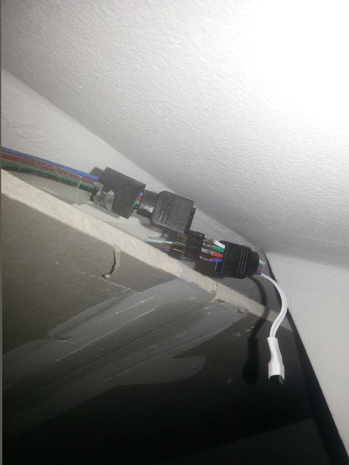

    the led strip was terminated with an ordinary contact plug. I cut it open and ankle out the cables and connected them to the cables that protruded from the ceiling into the lighting. It is a multicolour tape operated by the included remote control.

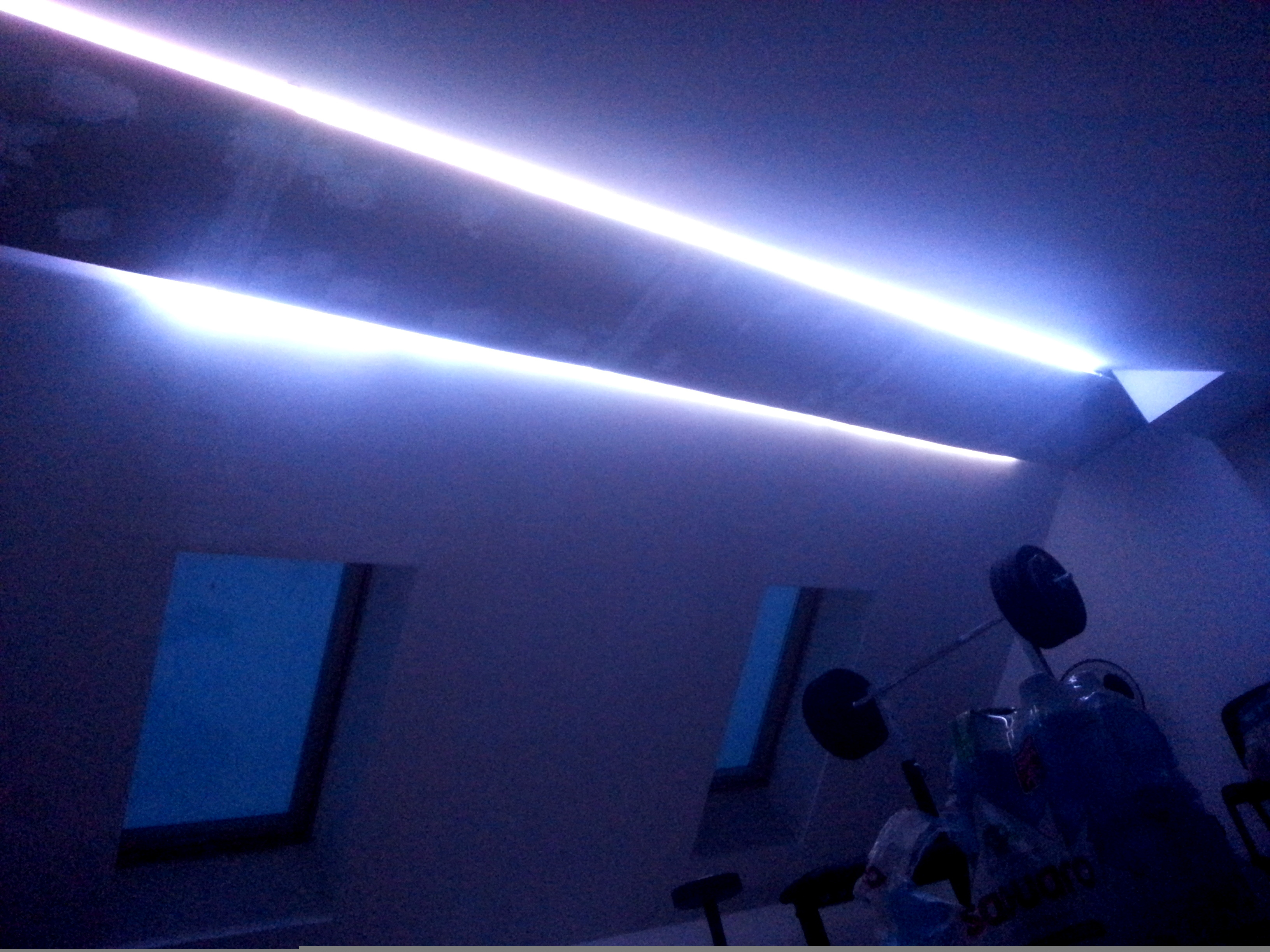

    Everything works properly until the strip is operated by the lighting switch.
    if I turn the tape on and off with the remote control, the program remains unchanged [I want to be permanently white].
    however, if I turn off the tape with the light switch, the tape returns to its basic program [as if resetting] - which is multicolor. when you turn on the tape again, the multicolour mode jumps into the light switch and the room shines like a Christmas tree.

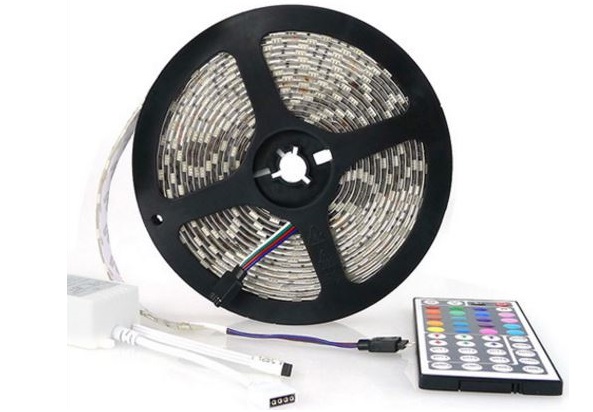

    Only two things do not add up here ...
    The second is a photo of the driver with the tape.

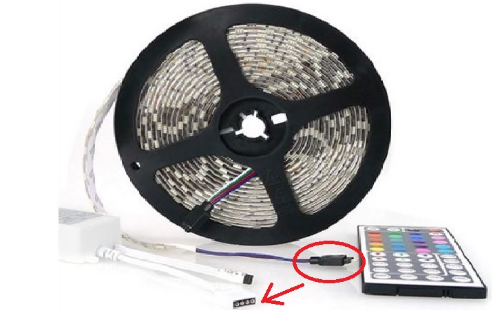

    matysekonrad wrote:
    but now the led strip does not react at all and does not light up,
    You need to locate and disconnect the plug of the power supply that goes into the round plug of the controller.
    The driver is most likely the white box that you can see in your photo behind the cables. It may be that the power supply socket is on a short cable, or directly in this box.
    Plug like in the foreground here:
    RGB LED Strip (SMD 5050, 300 LEDs, 12V) Connection with Ceiling Lighting & Remote Control Issues
    And then (the cable from the tape) white to the buttonhole and these three colors to the outside of the plug

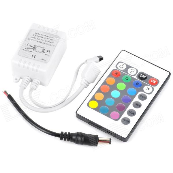

    ok, I got a reply from the manufacturer:
    " The tape driver, unfortunately, does not have the memory function of the last selected lighting mode . "
    what is this driver? this white box is a driver or power supply.
  • #10 16472050
    goldi74
    Posts: 8058
    Help: 1367
    Rate: 1535
    This white box is a driver connected to the power supply on one side and to the LED strip on the other. The element on the cable is the IR receiver from the remote control.

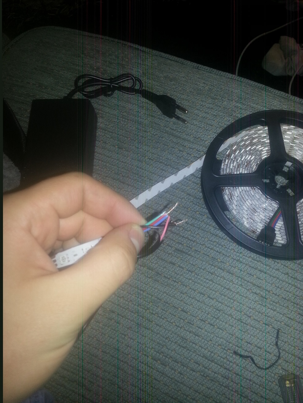

    ok, first attempt failed, what did i do;
    1) I missed the driver [white can];
    2) I separated the cables from the power supply;
    3) I separated the cables from the led strip;
    4) I connected the pink cable from the power supply with the green, blue and red cable from the led strip;
    5) I connected the black cable from the power supply with the black cable from the led strip;
    6) as a result, nothing shines and all the cables have electricity.
    is it possible that there is no downside here?
    I will add that it is a 4.5 meter tape for PLN 35 from a Chinese.
    #12 16472810
    goldi74
    Posts: 8058
    Help: 1367
    Rate: 1535
    Connect the pink one from the power supply to the black one from the LED strip, black from the power supply to the connected RGB wires from the LED strip.
