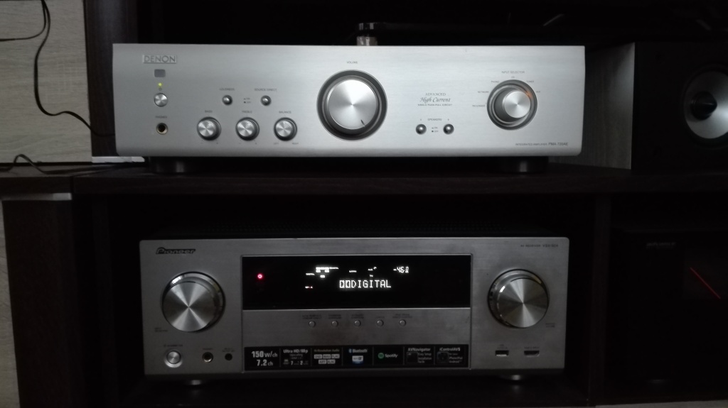

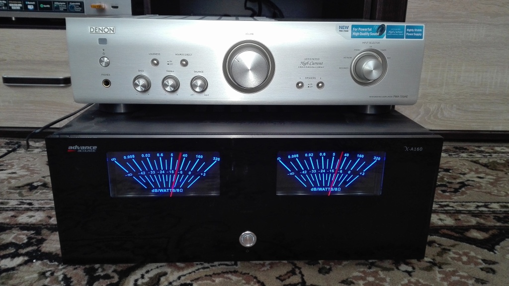

  • #25 17027080
    .:Gregorius:.
    Posts: 110
    and if we do not connect anything to pre out and main in, then whether they must be connected Jumpers or not and what does it matter?
  • #26 17027645
    Exmind
    Posts: 106
    If you don't connect anything to Pre Out or Main IN, nothing will happen.
    They don't have to be connected with any jumpers.
    [Pre Out] is otherwise like ---- output ---- from the preamplifier to power the next block, preferably a two-channel power amplifier with a powerful transformer.
    it is a system for extending the Home Cinema with two more channels: Boost + Power Amplifier sound connection format
    Bi-amping :)
    [Main IN] is --- input --- in the amplifier, power amplifiers to which you lead the interconnect from the [Pre Out] output of the receiver or other device, e.g. amplifier power :)
    I'm attaching a few pics :)

  • #27 17027666
    intenso
    Posts: 3759
    Help: 480
    Rate: 617
    Not completely.
    For example, amplifiers still have pre out and main in outputs, for the amplifier to work as a typical Integra, jumpers must be used.
    As the amplifier is to work as a power amplifier in the cinema, we pull out the jumpers and put the cinch that goes from the amp.
    If you want to listen to stereo, you have to pull out the cinch and put in jumpers, for me it's total nonsense.
    The best solution, as it always is, is a physical button where, when pressed, the amplifier is switched to tip mode.
    You don't have to rewire something every time.
  • #28 17027685
    Exmind
    Posts: 106
    that's right, but you know the amplifier to be a power amplifier, it's a total szjas, which is not enough.
    I tested four amplifiers working as a power amplifier, which is laughable for me.
    I definitely recommend buying a two or more channel power amplifier for such tasks.
    No amplifier can match the ending, unless the Denon PMA 2020, but for this money it is better to buy a powerful receiver.
  • #29 17027718
    intenso

5. What devices can I safely drive from Pre Out?
Active subwoofers, additional stereo or multichannel power amps, headphone amplifiers, or recording decks—all expect 0.775–2 Vrms line signals [Belden White Paper, 2021; Elektroda, daniel22opole, #16191036].
6. What should never go into Main In?
Do not feed sources lacking their own volume control (CD, console, phone). They deliver full output, slamming the power amp at maximum gain [Elektroda, intenso, post #16191070]
7. How do I link a home-theater receiver to a stereo amp (HT bypass)?
  1. Run RCA from the receiver’s Front L/R Pre Out to the stereo amp’s Main In.
  2. Turn both units off; power the receiver first, then the amp.
  3. Set amp to Main In/Power-Amp mode before movie playback [Elektroda, intenso, post #16738038]
