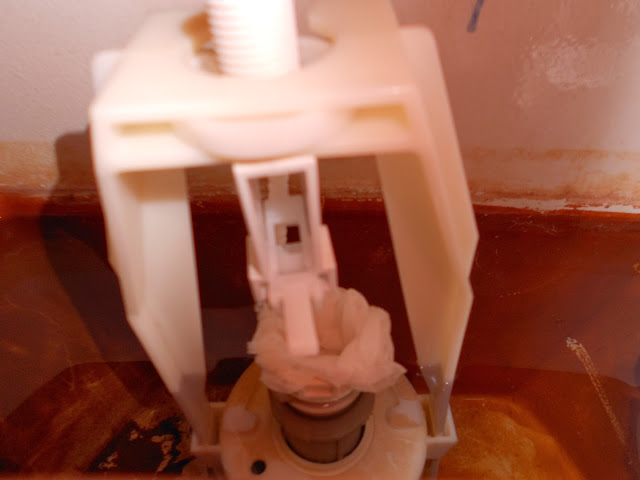

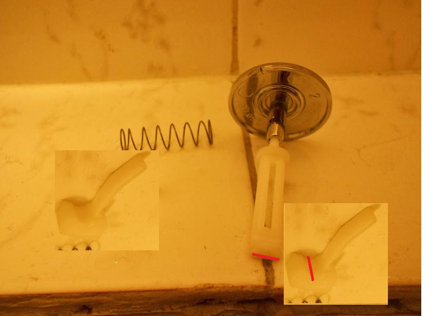

    when I flushed the toilet today I couldn't pull the trigger. After removing the cover, there was one element in the water (it is loose in the photo below). I have not had contact with this type of cistern and I cannot think of how this mechanism works ... Can anyone help and tell you where this part should be, or has any instructions on how this type of cistern works?

    These photos are vague, but I think that the corrected parts should be adjacent to each other and the red marked lines (surfaces) should touch each other.

    Unfortunately, these parts do not match the way you specified. I can connect them like this:
    Toilet Flush Mechanism Repair: Loose Part in Cistern & Trigger Pull Issue (Photos Included)
    But it shouldn't be like that, because if I put on the ceramic cover, I won't be able to connect these elements.

    The metal part must be unscrewed before attaching the ceramic cover, and then reattached after attaching it

    Everything should be inserted before putting on the flush cover and only the silver disk-button is inserted (screwed in) after the cover and nut are put on.
    Unfasten the two hooks on which the mechanism is holding below the water level, fold the inner parts back and put them back on the hooks.
