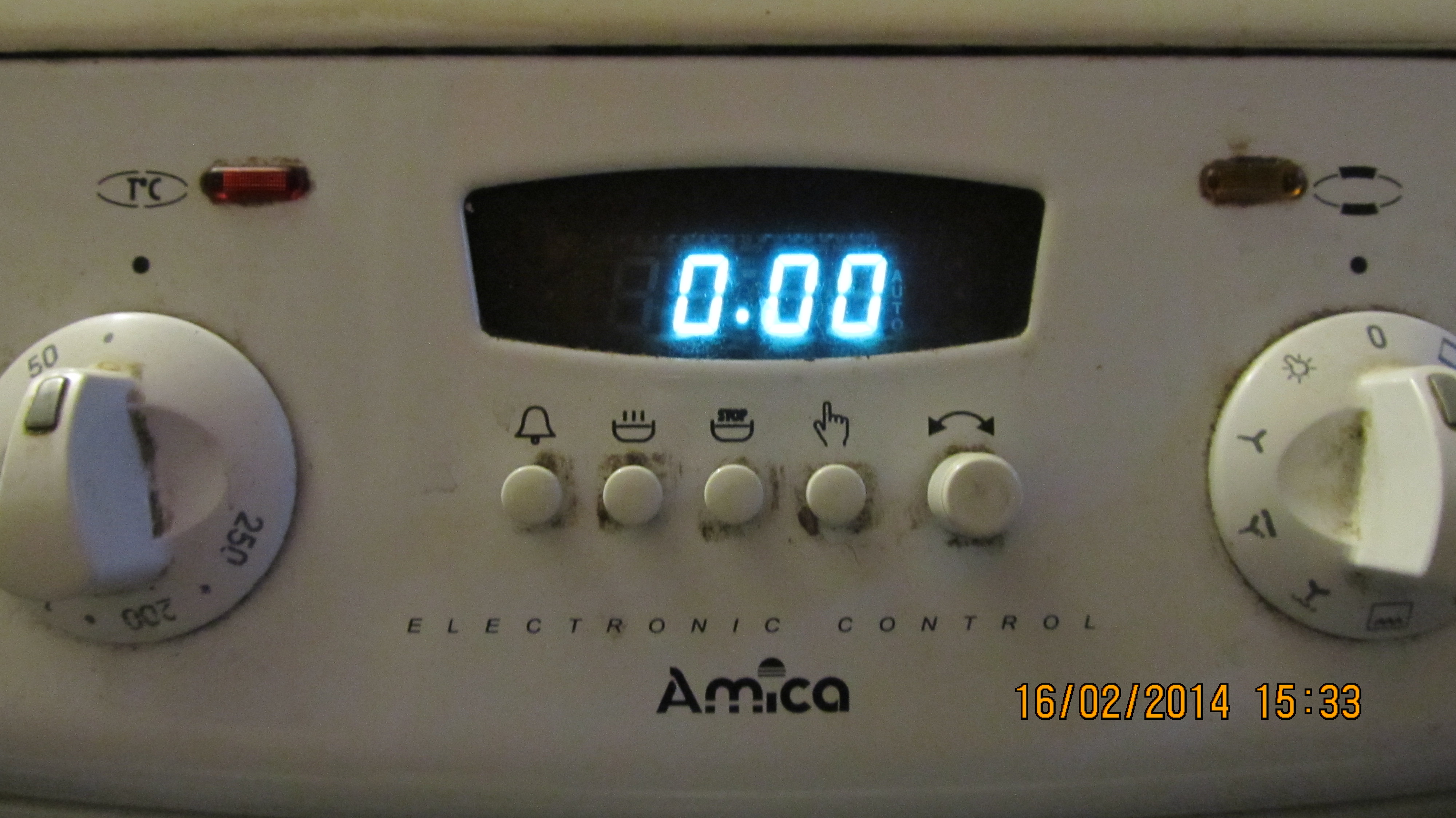

    I have a problem with setting the timer on the Amica ceramic cooker. After turning on the power, the display shows flashing 00: 0 AUTO
    According to the instructions, press the first two buttons from the left simultaneously and, holding the knob, set the hour, then release the buttons. In my case, the programmer does not respond to the knob, and after releasing the buttons, it returns to pulsing zeros. What could be the reason? Can it be programmed in some other way? This is very important because the oven and the left double hob plate do not work without a clock. Please help.

    I tried but to no avail. Zero and AUTO blink alternately. It does not react to the dial.

    thanks for the information, I would like to ask what should be replaced or repaired? I have electronics in my family, maybe he can do it. And the second question: how much can such a programmer cost and where can I get it.

    You have not written, and you are writing for which I thank you very much. You did not write where you can buy it, but with this and the second point I managed perfectly well. I was thinking about something like a stimulant, or after regeneration. But thank you very much anyway.

    The resistor in the voltage divider is 47k? (yellow, purple, black, red brown) costs a little cheaper. You can see it next to the black housing of the buzer with the power of 0.125W. The problem is its desoldering and reassembly of the new one, due to the very thin laminate. During operation, please be careful not to bend the buzer because the paths are cracking, especially the one that connects to the foot of the integrated circuit.
