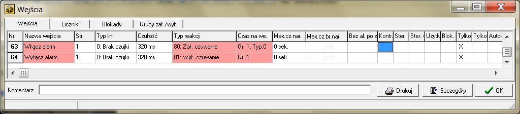

    Welcome back.
    This time I have a question about the control panel configuration, with regard to arming and disarming the control panel with the keyfob controlling the INT-RX module.
    For this purpose, I created two virtual zones on physically unused numbers 63 and 64, assigning them the functions 80-arm and 81-disarm, respectively.
    Then I assigned input 64 to the 1st buttons and input 63 to the 2nd, respectively.
    Will this configuration properly arm and deactivate the control panel when pressing buttons assigned to the above functions?

    Generally, it is not recommended to use the disarm function on the remote control, it is better to use the type 64 bypassing,
    You should also change the name of the virtual to a more readable, e.g., remote control or something similar,
    Set the line type to NO
    It should spin, test
    If it is already on the remote control, it is better 82 On / Off. standby on one remote control channel and one control panel input. In the options, you switch to violation of the input and subsequent pulses activate and deactivate the system. There is an option of signaling on the siren.
    I don't really understand the ideas with these shutters. Every time before arming the alarm you will close the shutters all over the house? In my opinion, you should secure the windows, preferably with reed sensors + vibration, eg VD1.
    As for the control of the light, what does it make during the day? Nothing will be seen. In such situations, I set a short pre-alarm on the siren for 1-2 seconds and, for example, an SMS. The intruder will know immediately that the system is working "and you will not hesitate to use it".

    Thanks for the answers.
    @darzec - I will correct the settings and test.
    @Andrzej_;) lukaszewicz - the remote control will be used in emergency for a neighbor who operates with two-state logic - turn on / off, so I have to match the remote control to the person. There is a story with shutters that when the wind is very strong, one may open. Out of respect for my neighbors, I prefer not to expose them to unnecessary stress.

    It went :)
    First, I started with identifying the keyfob, after installing the INT-RX module.
    I assigned virtual inputs 63 and 64 to the remote control buttons.
    Reviewing Home Security Design: Satel Integra 64 ETHM-1 with Motion, Smoke, Fire Detectors
    I set the inputs to NO (as advised by @darzec), one activates the other disarms the system
    In the structure, I made the Alarm zone, to which I connected the other zones as dependent "OR" (I think in this case it does not matter whether the "OR" or "AND" qualifier will be used)

    Hello @ dariusz.bembenek, thank you for the answer.
    I do not understand why such a procedure is. If you want to control several partitions at the same time, create "On / off groups" - entry window.
    In fact, I have not noticed that at inputs 63 and 64 in the "Time for in" column it is possible to set a group number.
    Now it looks like this:
    Reviewing Home Security Design: Satel Integra 64 ETHM-1 with Motion, Smoke, Fire Detectors Reviewing Home Security Design: Satel Integra 64 ETHM-1 with Motion, Smoke, Fire Detectors Reviewing Home Security Design: Satel Integra 64 ETHM-1 with Motion, Smoke, Fire Detectors
    I removed the Alarm zone and put the remote control inputs in the room where the INT-RX remote control module will be physically located.
    Works just as well ;)
