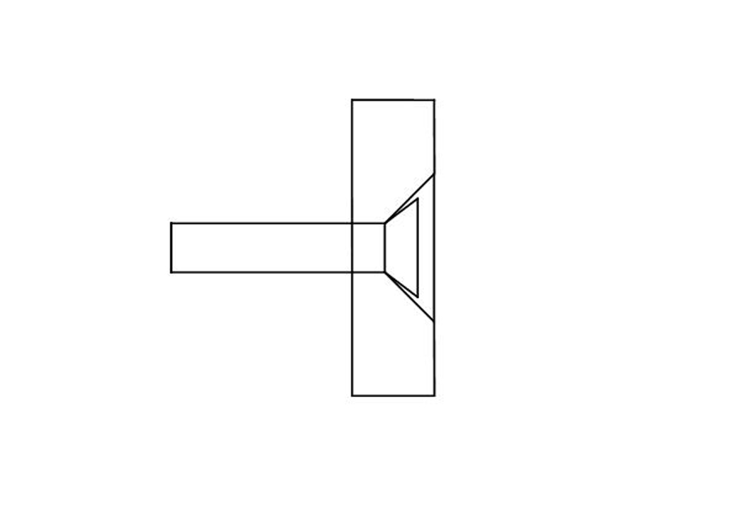

    The easiest way to make an M2 screw with a countersunk head, available in two parts, is available on the market
    and a made washer with a hole with a countersink for the cone, all soldered with hard solder.

  • #21 13584714
    ttessa
    Posts: 20
    Rate: 10
    jerry1960 wrote:
    Or maybe you will choose something here.
    can you provide the link?
  • #22 13585017
