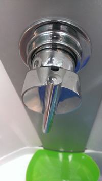

    How to remove the mixer in the shower cabin?
    The cabin is from Praktiker from 2005 (Aquasan / Sanprim I think).
    The symptom is that when a mixed water is set (half warm and half cold), then hot and cold water flows from the shower at intervals of 3 seconds (cold has more pressure then). Various "specialists" from Leroy etc. use a damaged mixer.
    I managed to (with difficulty) remove the handle, but it doesn't go any further. Maybe someone knows what step now? Tried to remove that metal protruding cover but it won't budge (or with the wrong wrench).

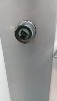

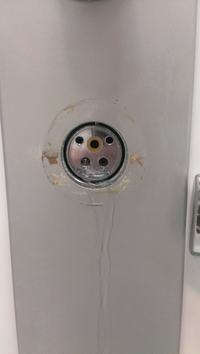

    And it worked. First you need to remove the handle (one screw for a flat key),
    Removing Shower Cabin Mixer in Praktiker 2005 Aquasan/Sanprim: Steps for Disassembly & Fixing
    then you need to unscrew this cover at the panel,

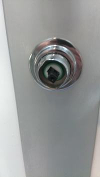

    The following part is pressing down on the mixer, so you have to turn off the water first, before unscrewing it. To unscrew it, I used a frog type hydraulic wrench and unscrewed it through a rag. As you can see from the photos, I tweaked and scratched this part a bit. Fortunately, most of this damage is hidden under the handle later.

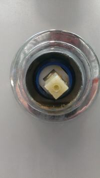

    Without a mixer, it looks like this:
    Assemble in reverse order.

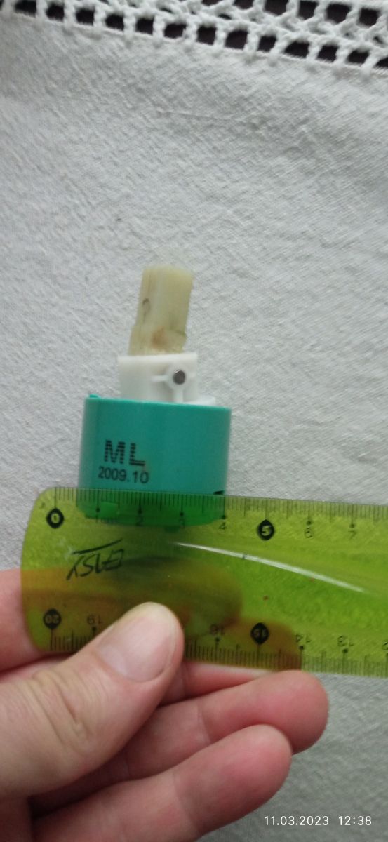

    As for the mixer itself, it is a short fi40 that can be easily obtained (Chinese PLN 10, Italian PLN 40).

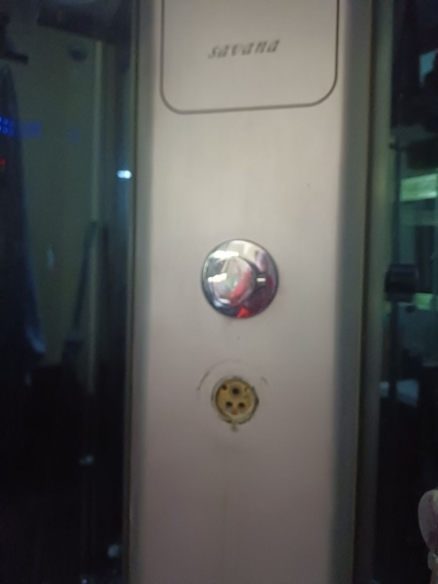

    frulik or this part of the 3 photos in your post in the SAWANNA shower also need to be completely unscrewed or can you just remove the ceramic regulator, i.e. this measure and replace it with a suitable short or long one?

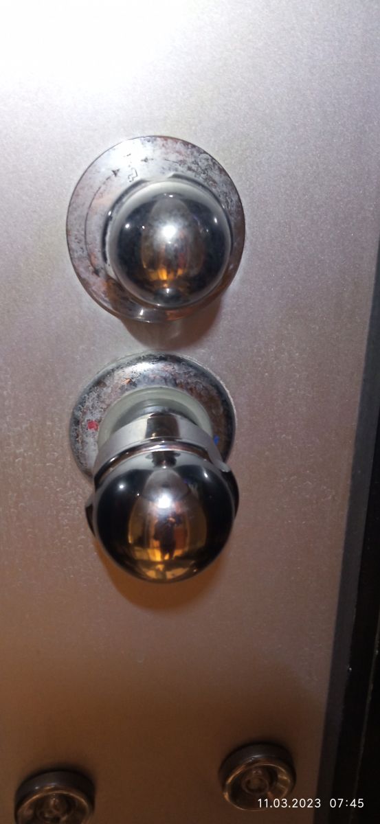

    I'm coming back to the topic because I also had a problem in Sawan's cabin.
    The biggest problem I had with cutting off the water on the installation.
    In the cabin itself, the ball-shaped handle is screwed on with a screw for a flat screwdriver and the screw precisely presses against the mixer shaft. My mixer broke, so the handle fell off.
    It went on easily.
    At the beginning, the stone should be removed around the perimeter of the ring adjacent to the cabin glass, then the ring should be pried and pulled out, it was not screwed on for me, it was only pressed.
    Then you need to unscrew the sleeve that remained counterclockwise.
    It was easy to unscrew with two hands.
    This sleeve presses the mixer to the base of the mixing valve, thanks to the gasket at the back of the mixer, it seals and prevents leakage.

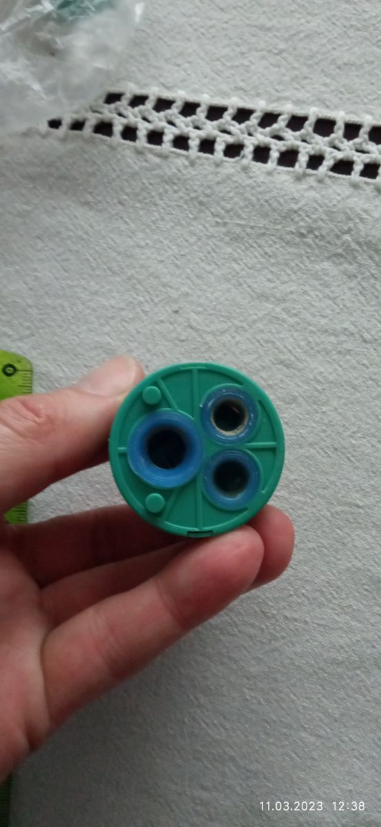

    I bought the mixer at a plumbing store. You need to have an old model because there are different models.
    I cleaned and tightened everything and it's ok.

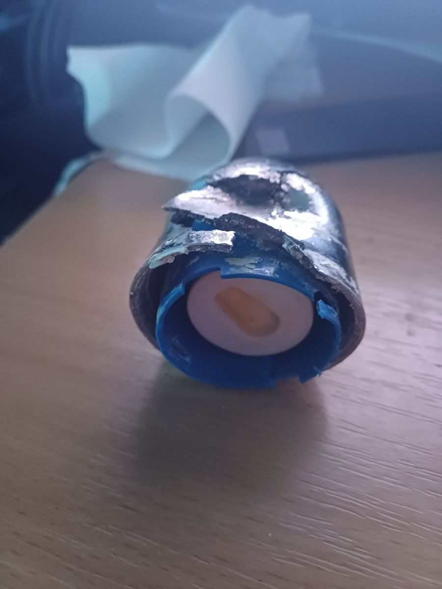

    Original mixer Removing Shower Cabin Mixer in Praktiker 2005 Aquasan/Sanprim: Steps for Disassembly & Fixing lasted 10 years.
    Removing Shower Cabin Mixer in Praktiker 2005 Aquasan/Sanprim: Steps for Disassembly & Fixing Removing Shower Cabin Mixer in Praktiker 2005 Aquasan/Sanprim: Steps for Disassembly & Fixing

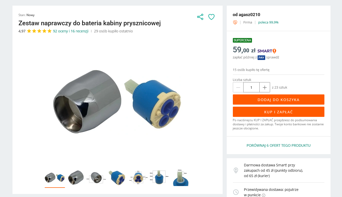

  • Repair kit from Allegro fits the mixer cartridge

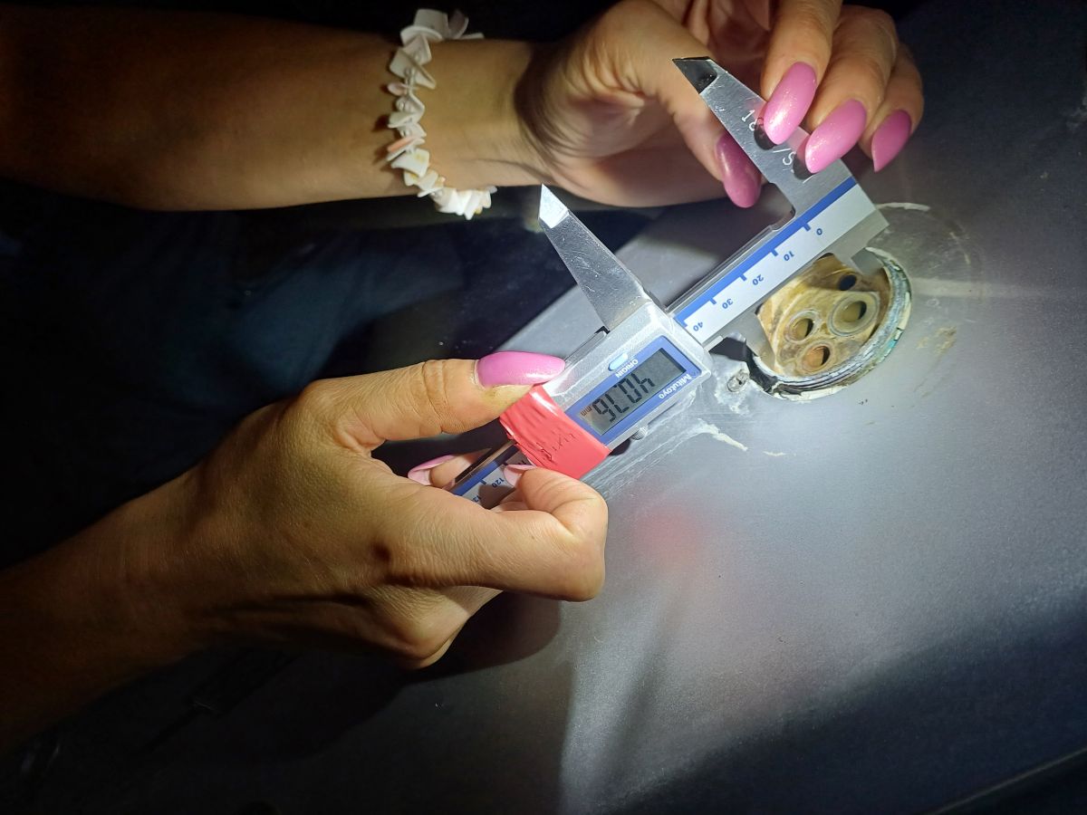

    #25 21206029
    emilkaaisyram
    super post, super tips!
    Thanks to you, I hope the Savanah will last a while. I found a repair kit on allegro. it should arrive the day after tomorrow. i hope it will fit. casto and liroj do not have it in their offer. i also leave photos with the caliper - maybe it will be easier for someone in the future.
    greetings and join in the pain :-)

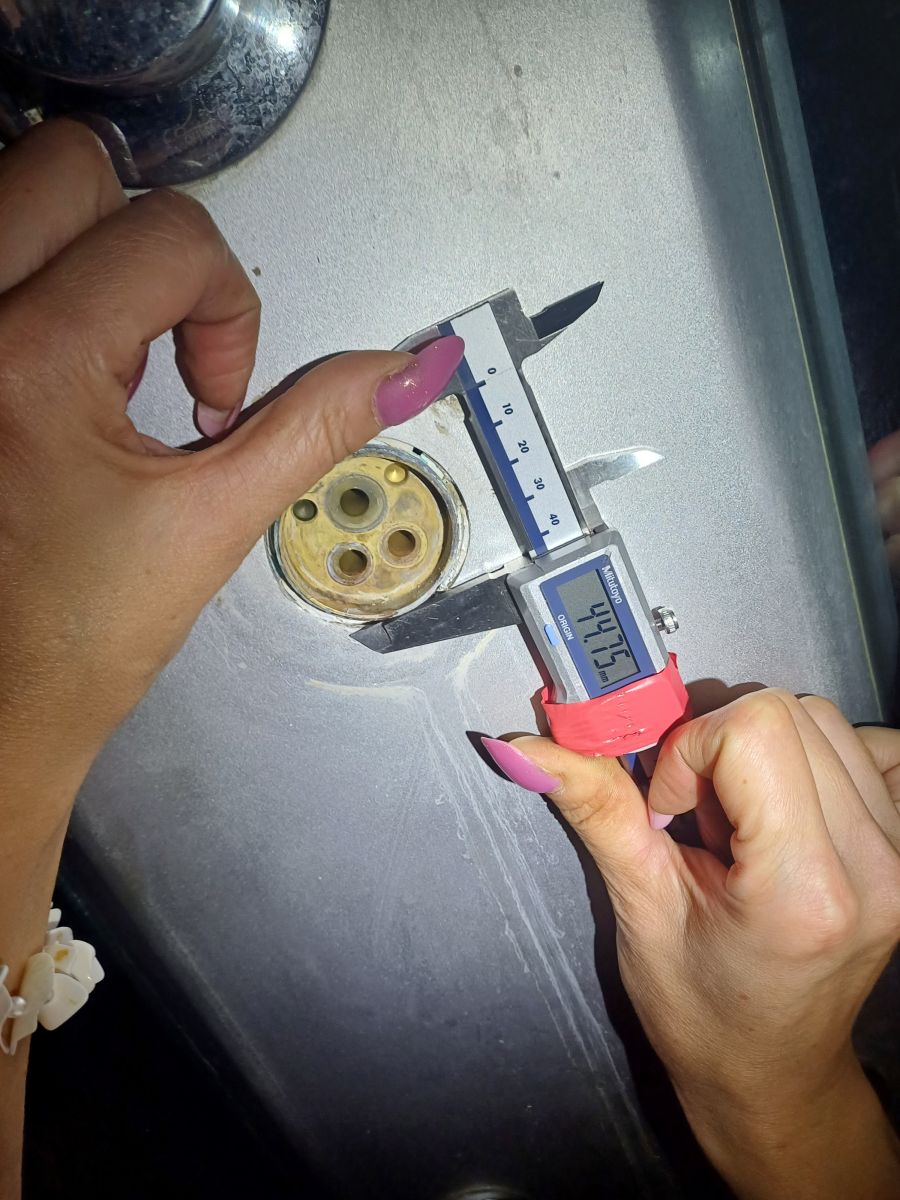

    Shower valve repair kit on an online store page.
    Close-up of a damaged metal coil element with visible scratches and peeling. .
    Savana shower panel with a missing component. .
    A woman measuring a metal component with calipers. .
    Hands using a caliper to measure a component in a sink. .
    small update: it fits :-) and works
