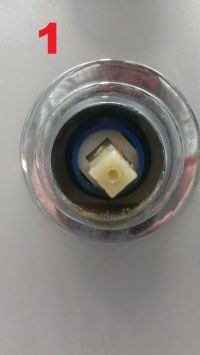

    Today I broke the handle to the mixer in the shower cubicle (for the moment, INBUS helps me to unscrew the water)
    Can I get a handle somewhere, is there no way to exchange it?
    First picture - actual state
    Picture two - what I need.

    But what exactly did you break? The pictures do not show what the problem is.

    The second picture clearly shows the water turning handle. I just don't have it. She was accidentally fired.

    I don't know if it's for sale, but you can use a lever with an old ball water faucet.

    I would honestly prefer the same or similar. I was looking for auctions but I can't find

    Here I found this knob: HANDLE 35mm STANDARD kitchen basin mixer (6626526501)
