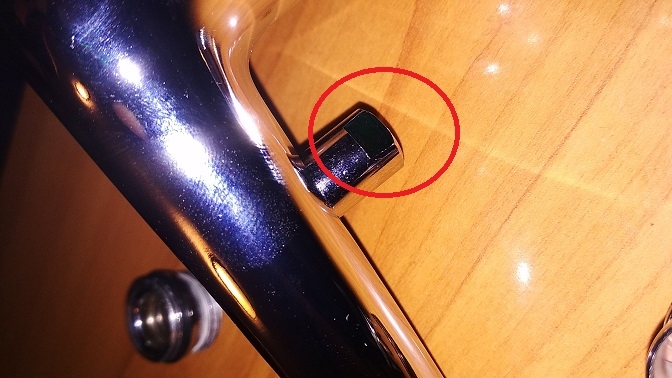

    Friends have a battery like the picture. Since the faucet / handset switch did not go, I removed the battery, took it apart, soaked it in vinegar and reassembled it again. Now the switch can be moved, but in both positions the water flies and from the shower head and tap. Can the problem be seals? I found a movie on the network that shows a switch like this one (unfortunately I didn't take the picture). https://www.youtube.com/watch?v=BLqcVjSztJ8 And the seals are e.g. in Castorama. https://www.castorama.pl/produkty/instalacja/instalacje-wodne/ak Akcesoria-zasilajace/uszczelki/komplet-uszczelek-przelacznika-baterii-wannowej.html. Is it enough to replace them? Unfortunately, I didn't find any manual with photos
    Attachments: To view the material on this forum you must be logged in.

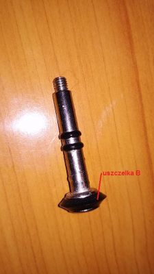

    Will try to add taken trzepienia and places in which to replace the O-ring - Bo and at home I have similar problem.

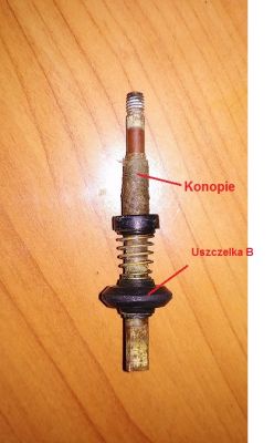

    Two O-rings with an internal diameter of 4.0 mm and a thickness of 1.0 mm "removed the defect" in the form of a profuse leak. Temporarily, even hemp wound up in a groove and smeared with assembling paste passed the exam.
    There was a slight water leakage from the spout when using behind the headphones, so it would probably be good to replace the unusual O-ring B that separates the spout / handset channels.
