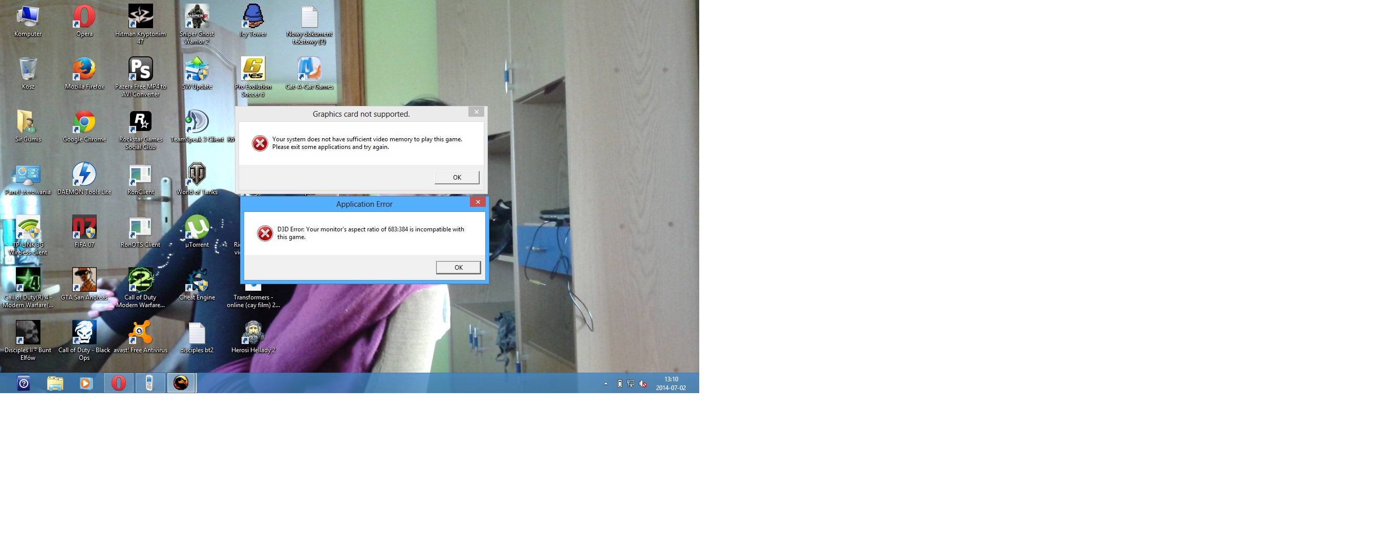

    Hello, I don't know if I gave a topic for a good forum, but I have a problem with Mortal Kombat Komplete Edition because I start the game and two errors appear. I replaced files in appdata like in movies with ytb but it didn't help. if I have to replace them with some others, please put them somewhere or something. because I don't know what to do.
    the equipment on which I installed the game is a laptop samsung 8gb ram 2 gb nvidia graphics. 750 wind 8 drive and the game should work like any other. I am green in such mistakes, so I have to ask for advice from others. Sad waiting for a quick response. Regards Smile

    here these bugs rather meet the requirements since other games are running fine in the youtube video there is one showing how to do it. and I do like him but when he does, he turns on the game and it doesn't work for him, so I'm looking for another way to do with it. what other requirements do you want? then I will try to add the most important things

    You have the info that "this graphics card is not supported" and the second error is something with the Direct library.
    And since the first mistake explains everything, the second doesn't matter.

    what to do to be supported? and with this direct what to do?
    I was just checking it, I have the newest direct 11 so this can't be it

    You probably have Direct 11 in the system, not on the card.
    What exactly is the graphics card - name, manufacturer, type, model.
    And make sure which Direct the game works with and whether your card supports the same.
    I also have DX 11, but in the system, and my graphics card only supports version 10, so I will not be able to play any game that DX 11 uses.

    nivida GeForce 710M. 8 GB in the requirements says that from 560 up. i direct 11.
    I am just downloading the latest drivers for this card, maybe it will help. but it will install in the afternoon
    Only the requirements refer to the GTX560 card, and you have a completely different card - the GF 710M. This card is much weaker than the GTX560.
    In addition, the GF710M is a card intended for laptops, by design these graphics cards are a bit truncated because laptops are not used for gaming and such and similar problems have occurred for a long time.
    All in all, you won't play this game on this computer and there's nothing you can do about it.
