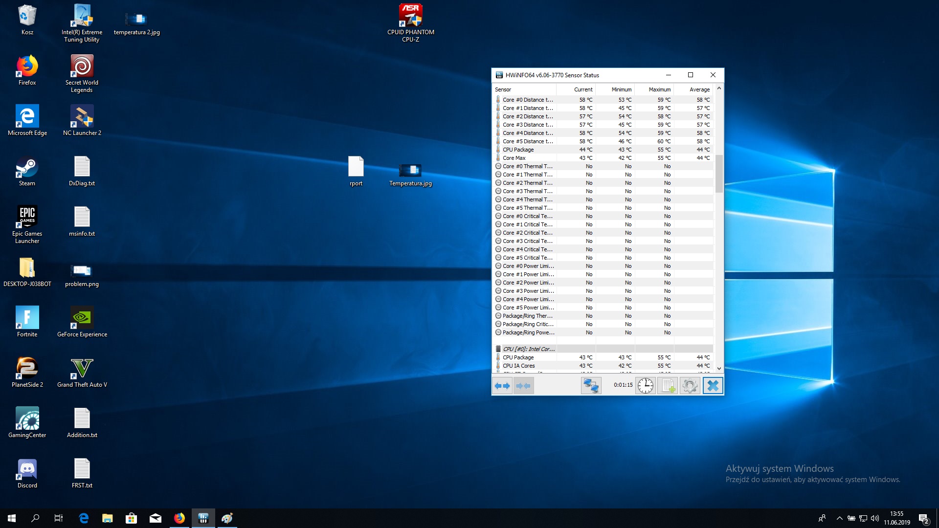

    GTAV is fired on the highest, I played the moments and then I made a screen. I would like to add that I have just finished playing fortnite and the game is running smoothly except that it just crashes every 5 seconds, sometimes even for 2 seconds, which is very disturbing.
    Below I will give the temperatures for the end of the game.
    • New Laptop Stutter Issue: GTA V, Blade & Soul - Performance & Adapter Impact, NVIDIA Update temperatura 2.jpg (327.65 KB) You must be logged in to download this attachment.
    • New Laptop Stutter Issue: GTA V, Blade & Soul - Performance & Adapter Impact, NVIDIA Update temperatura 3.jpg (327.78 KB) You must be logged in to download this attachment.

    These measurements are not worth much, because a colleague plays, then starts the application, when everything has time to cool down and takes a screenshot (and I suppose it is after the time shown at the bottom of HWInfo). Have a colleague run HWInfo, minimize it, then start the game (hwinfo runs in the background), play for 20 minutes, shut down the game, return to hwinfo and then present the screenshots of the measurements. Measurements from the load on the desktop alone are worth nothing.

    Insert Hwinfo with a window break - you have arrows at the bottom of the window and it does more columns.
    You MAY insert all the data, not some slices.

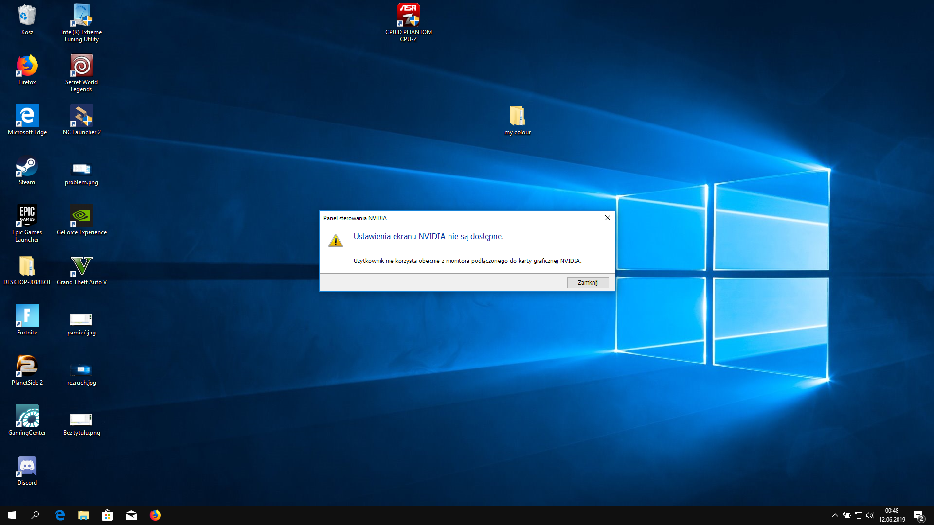

    Another problem arose. It had already performed before, but I installed older drivers and it was ok again. I don't know how, but it came back again. Namely, after right-clicking on the desktop, it is not possible to enter the nVidia panel, there is simply no such option in the bar. When I try to enter through the "magnifying glass" I get an error like in the screen. Are GTA and other games launching on Intel? If tk, how to fix it?
    So yes, unfortunately even if the laptop can already see the RAm memory, the problem still persists. Details: plays a game of fortnite and stutters when the opponent comes (most often), and sometimes stutters in a complete wilderness. Unfortunately, it is impossible to play with such a problem. However, I do not want to regret buying this laptop because it is clearly able to withstand even fortnite for the highest requirements. I would like to add that I play at the lowest settings except for the viewing distance, texture quality and surface smoothing. Problems with such jamming also occurred on the old paw, while the jams were less frequent and shorter. The old laptop had an i3, I don't remember what generation), I don't remember the 6GB of the GTX750 or 770 frame exactly. I can't believe the current hardware is too weak. I would also like to add that while playing GTA Online with a friend, he told me that his video memory is 3GB and that GTA only uses 1.5. For me, the memory is 6GB, and it takes 4.6 (with the same settings). My friend has a desktop computer, but there shouldn't be such a difference. Mouse lag also occurs for me and not for him.
    • New Laptop Stutter Issue: GTA V, Blade & Soul - Performance & Adapter Impact, NVIDIA Update problem2.png (1.09 MB) You must be logged in to download this attachment.

    Now, if you do not have an nvidia panel, Nvidia does not work for sure. You need to reinstall the nvidia drivers.
    When you run gta game on nvidia, insert screenshots of all hwinfo sensors - the game is to be run in the background and you run hwinfo before the game.
