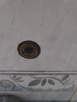

    Hello, I have the same problem as my colleague, and maybe even worse, because when I tried to replace the battery, the cam completely broke. The building is already 40 years old, so is the rust itself and nothing else. But a slightly different question - are there any substances that will help me "start" this eccentric (WD40?), Because it burned like a wild boar, since it broke when I tried to twist it (because the old battery was literally 3 mm narrower, so I could use new on old cams and have peace of mind ...)

    I tried to find something to stick in and there is a problem ... there is a knee in the wall right away, so it's quite shallow unfortunately.
    If I tried to saw it with a saw blade and break it piece by piece, I will probably damage the thread and leakage?

  • #15 18422429
    Xaveri
    Posts: 460
    Help: 13
    Rate: 77
    I have fought with a problem like yours 2 or 3 times in my life. Always the same method - I cut lengthwise what was left in the muff in 1 or 2 places (depending on whether it was brass or steel) and then hammered a flat screwdriver or something similar into the gap between the parts. The residue either curled inside (brass) or fell out. What was left (usually a larger piece) I treated WD40 and twisted by beating in the right direction.

    AdiBielo
    Posts: 238
    Rate: 29
    And this is exactly how the problem was solved - incised with a specially crafted saw blade (because I did not have a narrow one, so the wide one was treated with a square in half in a piece), then punching with a chisel, which broke the entire element and the largest piece, about half, could be pulled out in principle without the hassle of pliers. Anyway, everything is already working :)

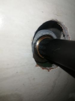

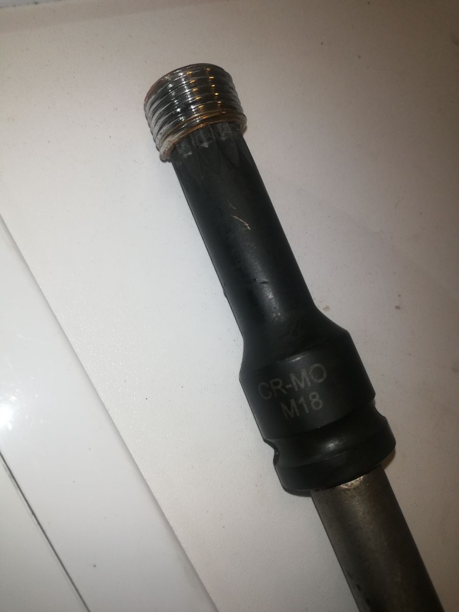

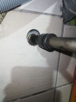

    Extracting Broken Bolt from Tap-Pipe Connection Without Damaging Tiles Extracting Broken Bolt from Tap-Pipe Connection Without Damaging Tiles Extracting Broken Bolt from Tap-Pipe Connection Without Damaging Tiles
    Hello, in the pictures you can see tools, thanks to which you can easily unscrew a broken thread from a pipe. We got it fast. Good luck to others. Regards
