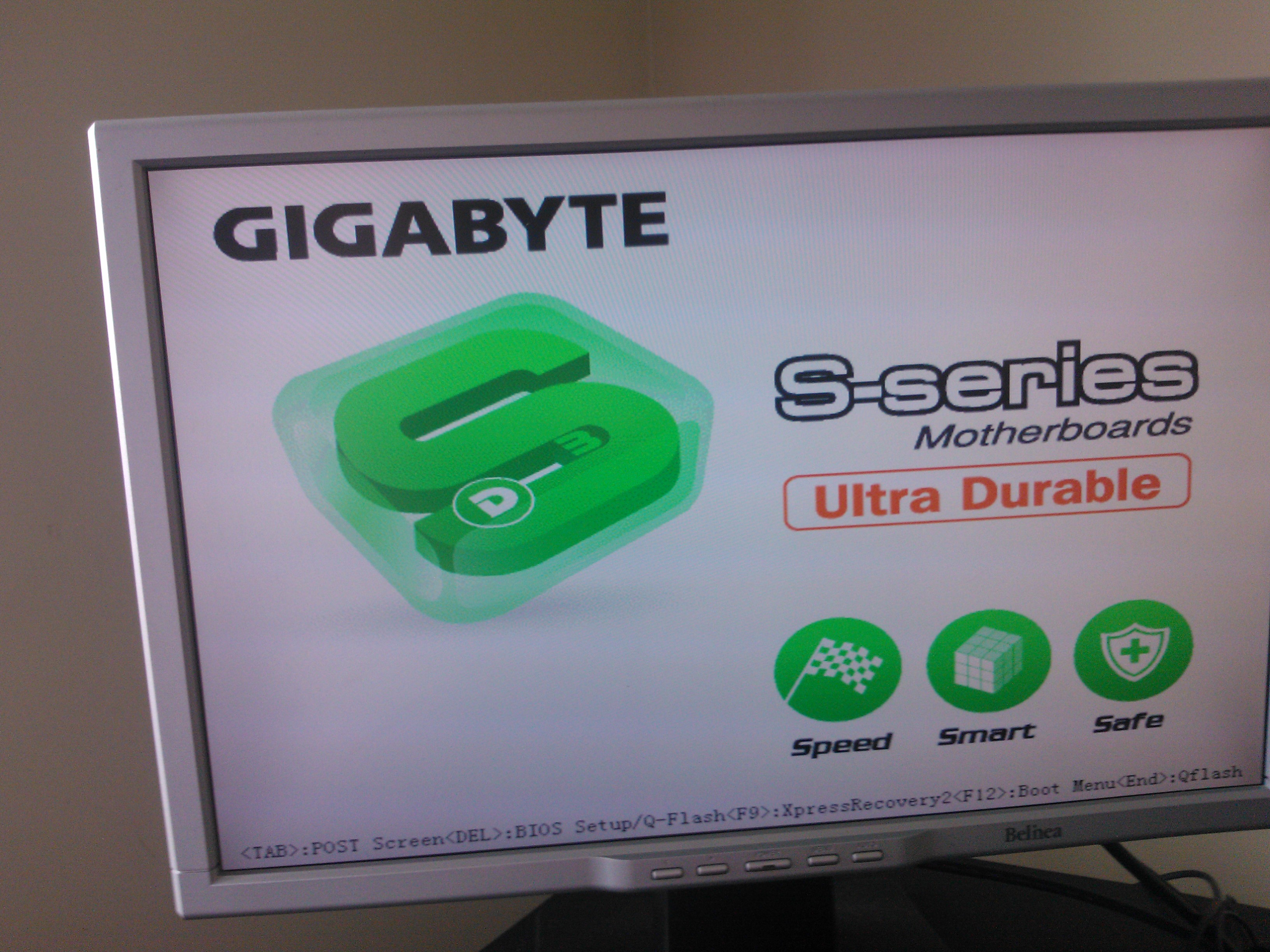

    I have a problem with the keyboard. The keyboard only works in bios, then the following message pops up and I can't do anything
    Problem - Monitor, keyboard and mouse do not work after starting the computer
    all I tried to do was restore the optimal bios settings and I still have ideas what to do

    fiftyfifty91 Enter BIOS, find USB Keyboard Support option, set it to Enabled.
  • #14 13888119
    fiftyfifty91
    Posts: 22
    Board Language: polish
    I did Load Optimized Defaults before (I think it should turn on the keyboard) because I did not find the keyboard option in bios and it did not help
  • #15 13888123

    Enter your motherboard model.

    I don't know where to find it, but the bios looks like that
    Problem - Monitor, keyboard and mouse do not work after starting the computer Problem - Monitor, keyboard and mouse do not work after starting the computer

    You can read the CD model directly from it after opening the computer case. Also from Windows with HWiNFO .
    Check the Integrated Peripherals-> USB Keyboard Support section to Enabled.

    Thanks :) everything helped but I wonder why Load Optimized Defaults didn't help? it probably resets Bios?

    It does not reset the BIOS, it only loads the default "optimal settings" - but optimal in the understanding of the manufacturer. This option is not used, because these settings must ensure high compatibility anyway (the manufacturer does not know what you are going to connect). BIOS reset is to remove the battery or set the appropriate jumper on the motherboard. Appropriate configuration should be made according to the connected equipment. Create a separate topic, then I can help you with the appropriate setting.
