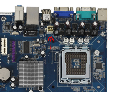

    Probably somewhere near the processor, since it is the processor power supply. Judging by the questions my colleague asks, he is gone Colleague Friend of the manual for this disc - so please download it, there are described all the sockets:
    http://www.asrock.com/mb/intel/g31m-s/#Manual
    The CPU power socket is on this board here:
    Monitor Stays Black After Turning On Computer: Tested Monitor, BIOS Reset, Cleaned Components

    The power supply is connected. I took out the RAM bones and turned it on but I don't hear the beeps but the buzzing.

    It is worth checking on a different power supply, if there are two memories then try to run only on one (if it does not start again, replace them and try on the one removed). If you have only one memory, you can check it or borrow another for testing. There is still a board and processor left - if you check all components and the board does not move, it will be guilty. An attempt to clean the CMOS was (as I see in the first post), but was it done correctly? Is the power disconnected, the CMOS jumper is switched on for about 10 seconds, then moved again to the right place?
