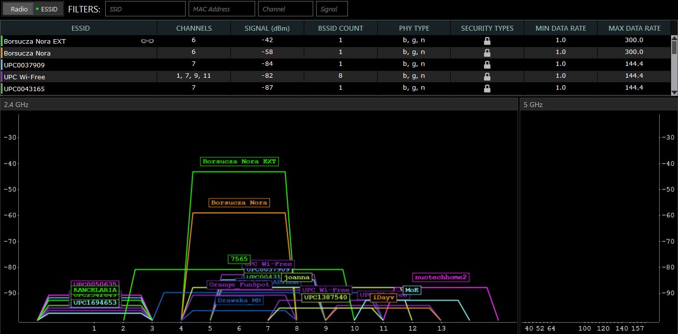

  • #5 13879407
    mikolajek
    Posts: 36
    From the technical support humor series - the solution they proposed in the form of setting the same name of the basic and extended network is given on the D-Link website as the root cause of connection problems :) Hands down...
    Below is a screenshot from inSSIDer. At the moment, the network with DAP-1520 is marked as EXT.

  • #6 13881593
    mbo
    Posts: 19691
    Help: 2333
    Rate: 845
    With such a large number of networks, the transfer can actually be poor.
    Did you scan in a place where the laptop usually works?
    If so, the repeater doesn't make much sense - -58 is a good signal level.
    Check how it works on other channels - for starters, I suggest 13.
  • Crowded Wi-Fi environment and weak source signal prompted repeater purchase
    #7 13881832
    mikolajek
    Posts: 36
    Well, unfortunately, the whole block is taken over by UPC and everyone seems to have Wi-Fi turned on, whether they need it or not. So the crowd in the ether is quite big. Recently, an ambitious idea of UPC with a Wi-Fi network available to all customers, which additionally takes up space, has been added.
    Yes, the scan was done where the laptop is, but in general, the basic network signal is usually between -60 and -68. The purchase of the repeater took place when I had Thomson (now it's Ubee), and the network power there was tragic (-80 was the standard).
  • #8 13882981
    mbo
    Posts: 19691
    Help: 2333
    Rate: 845
    Now he proposes to test channels and transfer with the additional AP turned off.
  • #9 13952174
    mikolajek
    Posts: 36
    To close the topic: it turns out, however, that only the option with a different SSID works - even when setting the order of WiFi preferences, the computer gets stupid and connects alternately to two networks with the same SSID. After changing it to another, the problem is gone, and there are two networks in the ether anyway, so... :)
