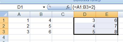

    The easiest way is to save a new one
    1. select a range equal to the source in a different place on the sheet or on a different sheet
    2. write "="
    3.Select the source range
    4. enter by how much is to be increased. For example "+2"
    5.confirm with Ctrl + Shift + Enter (array formula)
    How to Add a Constant Value to Multiple Cells in Excel 2007?
    6. Ctrl + c (copy)
    7. Ctrl + Alt + v (paste special), select: 'values'
    8. copy and paste in place of "old"
