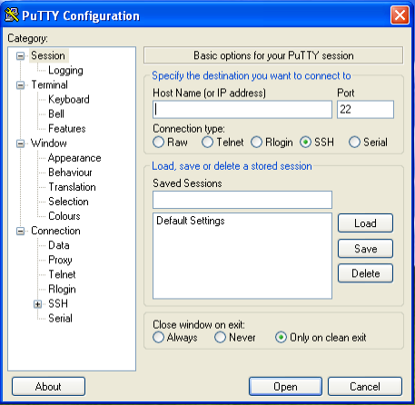

    Connecting to a SSH is basically very easy, just download putty (if you haven't already got it) or another similar program, and set the connection like here below:
    SSH Command: Connecting to Custom Port, Secure Shell Protocol, and Network Communication
    Just mark SSH, set the name of your host, and choose the port. After that, you can save your configuration for further use or just click Open to Connect to the host.
    If you would like to have SSH on Windows, install OpenSSH – changing the port is made in OpenSSHetcsshd_config. Just change “#Port 22” to your own port like 23 and remove # - “Port 23”.
