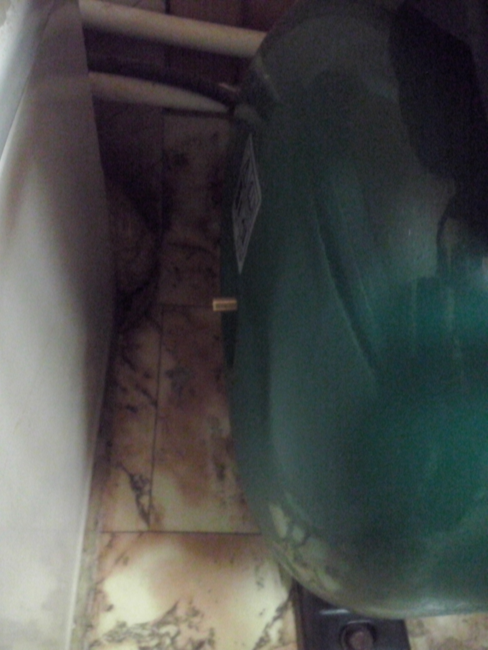

    Hello, I don't know if anyone can help me with this topic, but the point is that when I turn off the hydrophore and drain the water, I can't inflate the expansion tank ... 3 months ago I did it without a problem, now I wanted to pump up the air because the hydrophore started switch on more often and "it is impossible" to push the air with the pump ... when I loosen the hose from the pump at the entrance to the tank, the air escapes, if I tighten it to the maximum, I would have to have my muscles puffed up to make 2-3 pump movements ... .
    thanks in advance for your help :-)

    And how does the pressure on the tank behave then?

    Well, the problem is that when I apply a nanometer, it seemed to be broken ... because it shows nothing, is it possible?

    Replace the pumping valve on the tank, your trouble with pumping and checking the pressure will pass.

    Thanks :-) .... tell me how to replace it, because that's for me hmmmm ..... :-)

    Give me a picture because I don't know what you have there.

    I mean, don't you have to pull out the entire inner tube to replace this valve ...? Correct Inflation of 300L Hydrophore: Proper Air Pressure & Pump Range for Optimal Water Usage Correct Inflation of 300L Hydrophore: Proper Air Pressure & Pump Range for Optimal Water Usage

    The valve is the same as in a motorcycle or bicycle, so you only replace the middle by turning it to the left. As if you showed water after turning it off, it means that the diaphragm is leaky and needs to be replaced. When you replace the valve, you pump with the water drained and the hydrophore turned off to the pre-pressure that is written on the plate and only then you start the hydrophore. The valve is in the tank, not in the "inner tube". There is water in the tube.

    cool, thanks, i bought a new valve, i'm going to get on with it soon :-)
    Added after 1 [hours] 50 [minutes]:
    Thanks, Wawrzyniec :-) done, valve replaced, nothing spilled from the inner tube, inflated, twisted, works !!!, :-)
    thanks again ;-)
