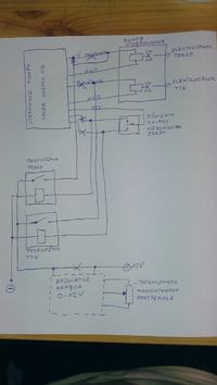

    In the Merlo loader died electronic controller that controls the electrovalves in the hydraulic pump. To begin with, a diagram of the conversion :
    Merlo Loader: Replacing Damaged Hydraulic Pump Controller with Two Relays
    In the original version, the regulated voltage from the controller smoothly controlled the movement of the valves so that the loader does not move rapidly but slowly depending on the value of the potentiometer located near the pedal. This is important especially during charging - it pulls up slowly and not abruptly.
    I replaced the controller with two relays that switch 12V to the valves depending on the setting of the direction lever. The relays are switched by shorting the minus to the case near the pedal (instead of the factory potentiometer).
    Everything works beautifully only that the charger starts violently. So I came up with an ego solenoid for the solenoid valves. I will place the regulator potentiometer at the pedal.
    And here a request to you esteemed forumers to give me some scheme of the regulator that will work best here.
    The maximum voltage that will flow into the regulator is 14.4 volts, the minimum voltage probably does not have to be 0 or 1 because I do not believe that 1volt will move the solenoid valve enough to get the charger going. As for the control current, it is quite high and measurements showed that it was 19-20A at times. Also a higher power regulator is needed. Thanks in advance for your answers....

    szelton wrote:
    Your circuit will not pass the test, because if one of these additional relays is tripped then 12V goes to the valve which is full open and that is why it jerks.
    Why do you say it will not work? I cut the wires from the controller and all control goes through relays at the moment. When I move the forward direction lever the voltage goes to the coil of the relay (let's call it #1 ) but it doesn't get switched on because I have the pedal depressed, which disconnects my coil circuit. Only when I let go of the pedal does the coil circuit of the relay close, this in turn short-circuits the contacts and full 12V flows to the valve and the charger starts rapidly. It is the same with the reverse movement - the reversing lever gives voltage to the coil of relay No. 2 and the same thing continues. When you add a regulator, the ground will be connected permanently. So
    if the voltage of 12V applied to the valves through the relay contacts will be regulated by a potentiometer at the pedal, then when the pedal is depressed to the stop and the shift lever is moved, for example, forward, the relay coil will turn on, but the charger will not start because no voltage will flow through the contacts. Only when you let go of the pedal will a slowly increasing voltage flow through the relay contacts and the supercharger should start more smoothly because the valve will open more slowly.
    If the pedal is not depressed and I move the directional lever then it will jerk but if the pedal is depressed it must move slowly :) .

    bonanza wrote:
    Basically, this is what I mean.
    Here is the schematic
    I think the valves are controlled by voltage (current ?). There are two pieces on the pump, each has two pins. There is a 5kohm potentiometer at the pedal. In addition, there is a speed sensor connected to the controller, probably the shaft. The valves were controlled both by pressing-releasing the pedal and by measuring the engine speed. Because if I threw the direction lever, for example, forward without pressing the accelerator, the machine stood still. When I slowly pressed the gas pedal the machine slowly moved. If, for example, I wanted to scoop something I needed higher engine speed. Then I adjusted the speed with the pedal (potentiometer located next to the pedal. My modification will exclude the first way of starting the machine ( when using the shaft speed sensor).
    I could be tempted to build a more elaborate controller but there is no point. If I understand correctly, the maximum current that is needed to control the coil I will calculate from ohm's law. I just need to measure the resistance of the coil, the control voltage I already know - it's 10-12V. Just need to calculate the current and you can build a regulator :) What do you guys think, am I thinking right ?

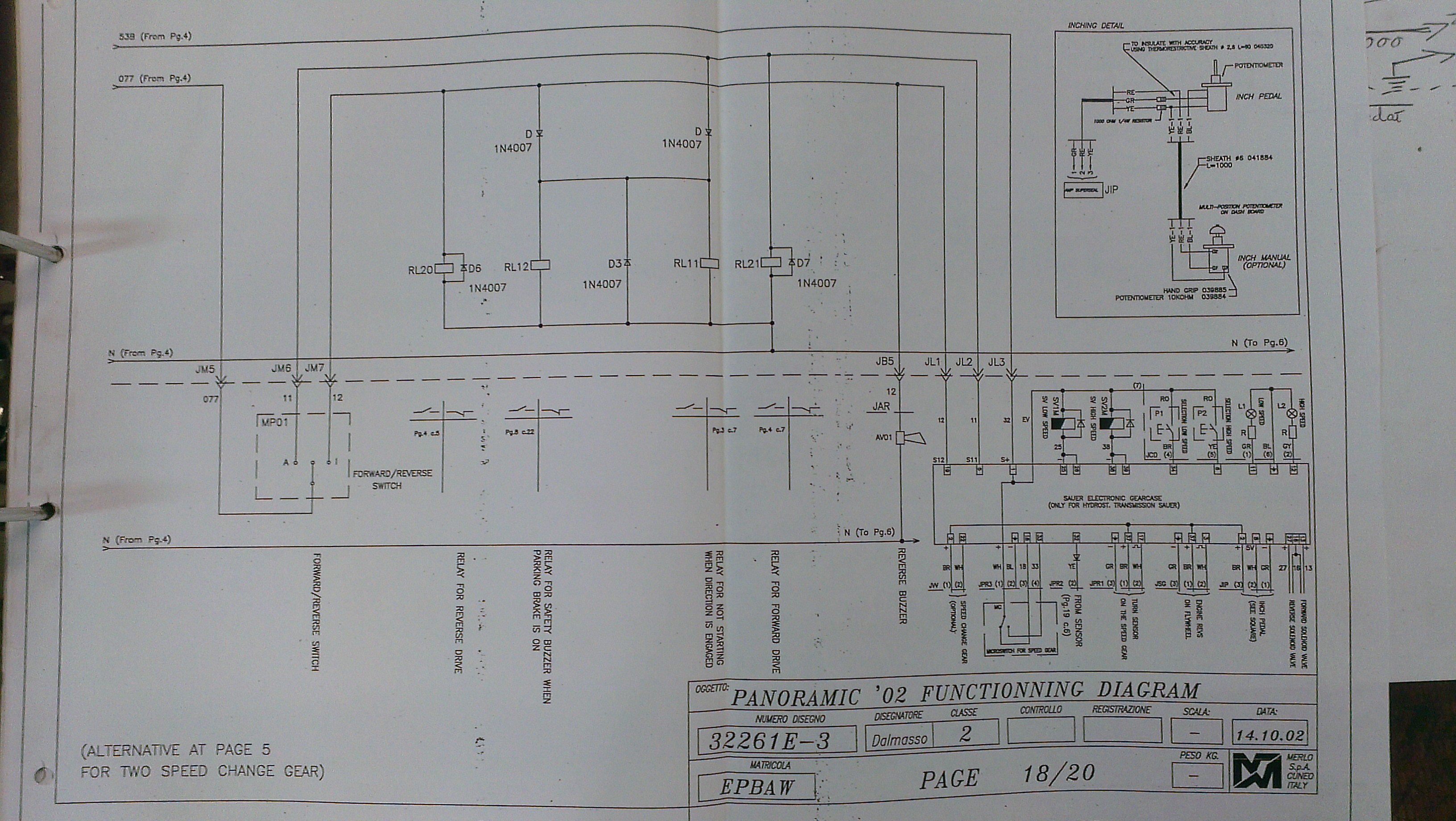

    Colleagues...judging by the original schematic, these two valves (SV Low Speed and SV High Speed) are used to switch the low or high flow from the pump (switching and switching based on the signal from the foot pedal/potentiometer and the shaft rotation sensor); while the direction of travel is realized by RL20 and RL21.
    If this schematic is true for the machine with which Col. Adam_sil has a problem with, then the reworking of the control (to bypass the original controller) must go in the direction of creating such a control pedal that would give 3 states: off, low speed, high speed (and with this -> powering the valves); possibly converting the linear signal (voltage divider on the potentiometer) into useful switching thresholds.

    pafciowaw wrote:
    Colleagues...judging from the original schematic, these two valves (SV Low Speed and SV High Speed) are used to switch the low or high flow from the pump (switching and switching based on the signal from the foot pedal/potentiometer and the shaft rotation sensor); while the direction of travel is realized by RL20 and RL21.
    The two speeds are realized by a micro switch located on the direction lever and indicated by an indicator light. Originally, it was pressing the accelerator pedal and - let's call the other pedal the clutch - the clutch that changed the speed only within the range of specified speeds. Pressing the switch acts as if I had engaged half a gear - the supercharger responds the same way to pedal pressure except that it goes slower or faster depending on the state of the miko switch. After the fault, RL20 and RL21 switch on depending on the position of the direction lever, but the machine stood still. The measurement showed a lack of control voltage on the coils, so I installed relays there. In this way I circumvented the faulty servo control of the coils by the controller.
    The loader is a Merlo kt 33.7 The resistance of the coils is 5.5 ohms. So after calculations, the regulator should give an amperage of about 2A
    I'll look for some schematic and assemble it quickly. It won't hurt to try and maybe it will work as I expect it to

    You are talking about "microswitch speed gear". - yes, you can use it according to your schematic (with additional relays) and you will get two speeds (speed).
    This will work, but the original controller analyzed simultaneously: the pressure on the pedal (inch pedal see square), the speed sensor of the speed gear in question (turn sensor of the speed gear) and the rotation of the shaft (engine revs on flywheel) and the direction of travel....
