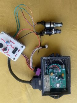

How can I replace the damaged Merlo loader hydraulic-pump controller with a regulator that smoothly drives the proportional solenoid valves?
You should use a PWM/current controller for the proportional solenoid valves, not a simple linear voltage regulator or relay switch, because the original SUSMIC unit drives the coils with pulsed current and also uses pedal, engine-speed, and brake inputs [#14153372][#14670306][#14687502] Measurements from a working machine showed about 100 Hz PWM, with duty cycle changing from roughly 2 ms on/8 ms off at idle to 6 ms on/4 ms off at full pedal, and the pedal characteristic is non-linear [#14670306][#14783740] Another reply noted that the valve coils start moving around 0.45 A and reach maximum drive near 0.7 A, so the controller has to regulate current, not just voltage [#14687502] One practical workaround that was tested was an AVT PWM kit adapted to the original 5 kΩ pedal potentiometer, plus a separate 12 V/5 A stabilizer to stop resets; it worked smoothly but only over part of the pedal travel [#14887467][#14888771]

    After several attempts with various PWM regulators, I finally found a solution that satisfies me. I used a regulator I bought as a DIY kit, the schematic of which is in this post https://www.elektroda.pl/rtvforum/topic2940955.html .The regulator required some minor modifications because it often reset when using the charger. I cut the path at leg 1 of IC2, inserted a voltage regulator for 12V/5A because the unstable voltage coming from the alternator was resetting my controller. The valve control voltage is taken from the output of transistors T2 and T4. This voltage flies to the relays, the diagram of which I posted at the beginning of this post. Further to the corresponding valve. I connected the other output of the valves to ground. Instead of the potentiometer given in the schematic (10k), I used the one from the 5k charger. I removed only two resistors, probably 1k each. In this way, I basically achieved smooth starting adjustment over the entire range of the potentiometer, i.e. from zero (pedal depressed) to 2/3 of the height the adjustment is felt.
    This works in such a way that after firing the supercharger, the controller diode blinks and the voltage does not flow to the valves. When the pedal is pressed, the controller automatically begins to apply voltage and the LED lights up continuously. The voltage is zero because we have the pedal depressed, but when we let go of it the machine starts (if, of course, we have the direction lever switched accordingly). It works very well :) eventually. There is also an inconvenience but about that later because I have to go

    Returning to the topic ...
    When the pedal is depressed to 2/3 of its stroke, the charger does not respond to further release of the pedal. Probably because the voltage at the output reaches a value sufficient to drive the maximum valve (measured with a meter, it is about 8-9V) With further release of the pedal (further movement of the potentiometer), the voltage increases, but it is no longer relevant to the valve. It would be possible to lower the supply voltage of the entire controller to, say, 10V, and this is what I intend to do. This should increase the control range of the valve through the potentiometer.
    The inconvenience of this whole solution is that during driving, when the pedal "clutch" is pressed, the charger immediately comes to an abrupt standstill. However, you can easily get used to this by operating the individual pedals of the loader slightly differently to get rid of this problem. When it comes to gently pulling up, scooping what is on the bucket, the controller does its job very well. The driver's transistors don't need any heatsink, the only heatsink is for the voltage stabilizer, but even that doesn't get too hot.
    That's it for now, I'll play around with a lower supply voltage for the controller and I'll let you know if it's even better

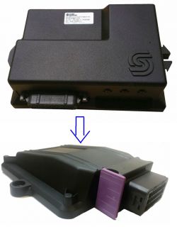

    Hello everyone, I'm on the portal since today and it's because of the SUSMIC 12 controller
    namely I need a broken one of this kind

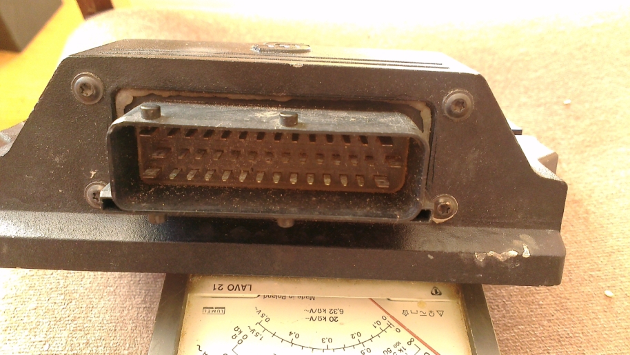

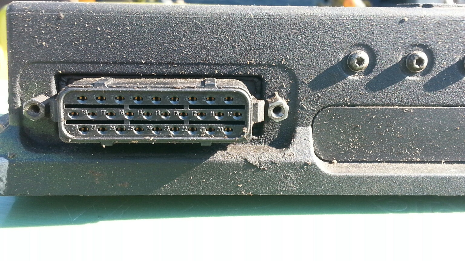

    I have some two at home but they have obliterated markings. Paste some pictures of the plug and housing or send on pw

    Merlo Loader: Replacing Damaged Hydraulic Pump Controller with Two Relays Merlo Loader: Replacing Damaged Hydraulic Pump Controller with Two Relays .

    Yes actually I only need the connector itself, I built a replacement to plug in while the original is being repaired, now the connection itself takes too long

    Mine have a different connector

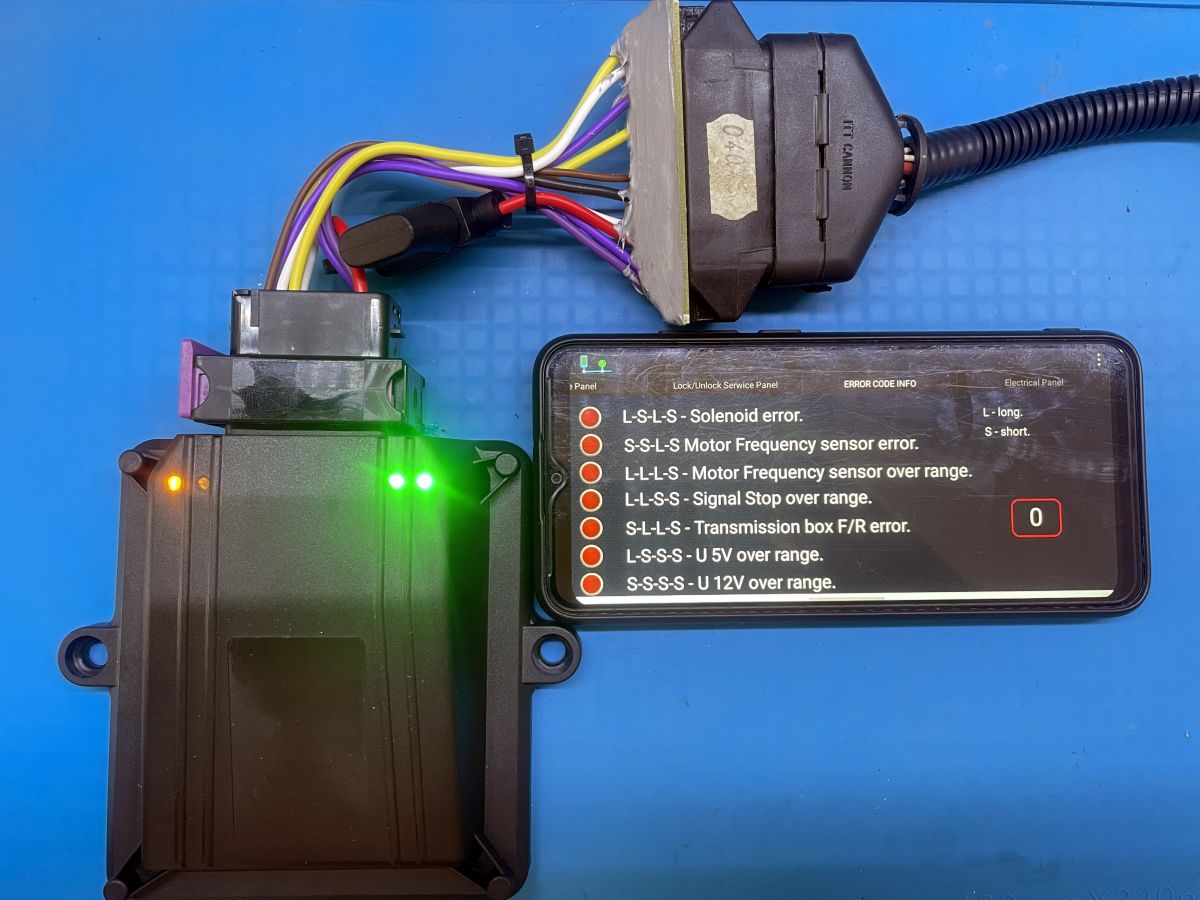

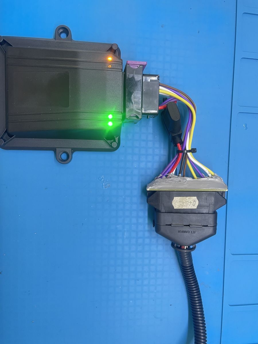

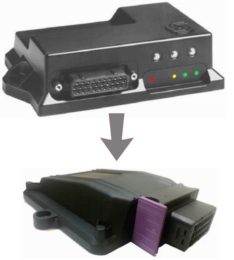

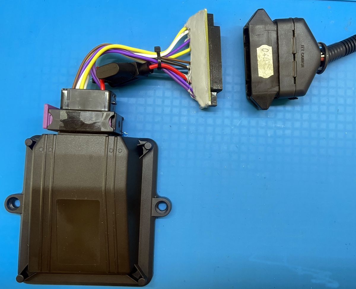

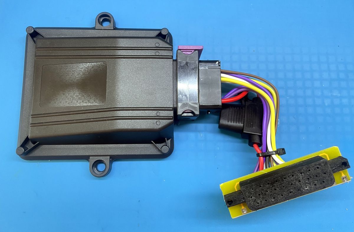

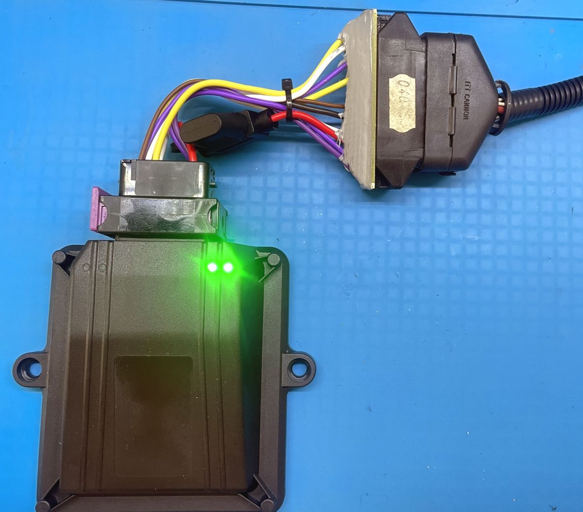

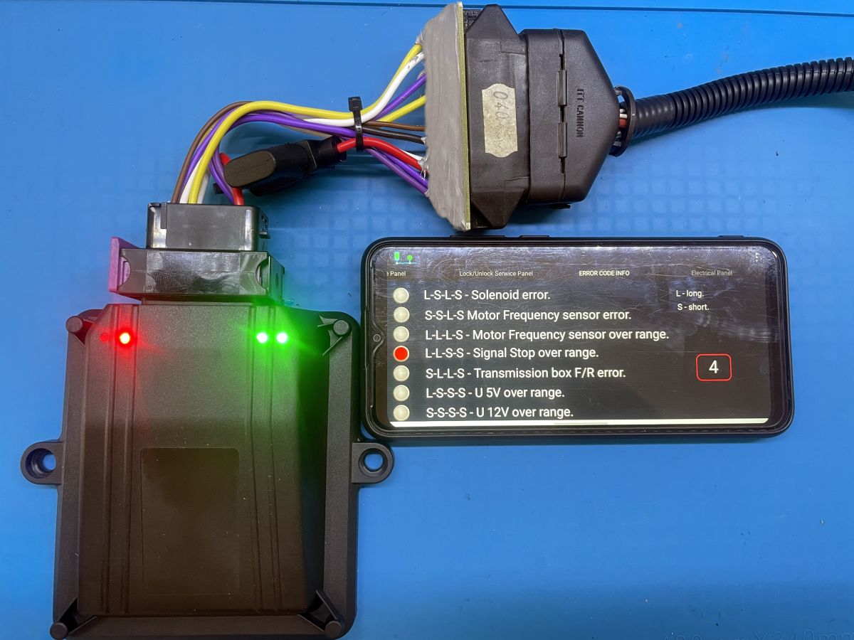

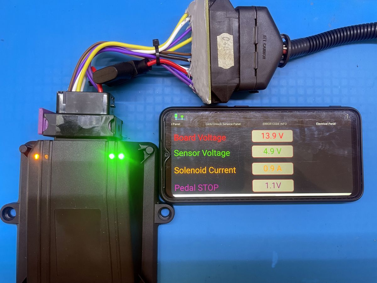

    Hydrostatic Transmission Controller (SUSMIC 12 Analog)
    Compatible with MERLO, Sambron, Matbro, Bobcat, Massey Ferguson, JCB
    We offer a new analog of the SUSMIC 12 hydrostatic transmission control unit, fully compatible with the original MERLO controller (100%).
    Part numbers: MCE209B1003, MCE209B1023, NFPE, 059568, 035965, 058553.
    ✅ Key Features:
    Works immediately after installation – no complex setup required.

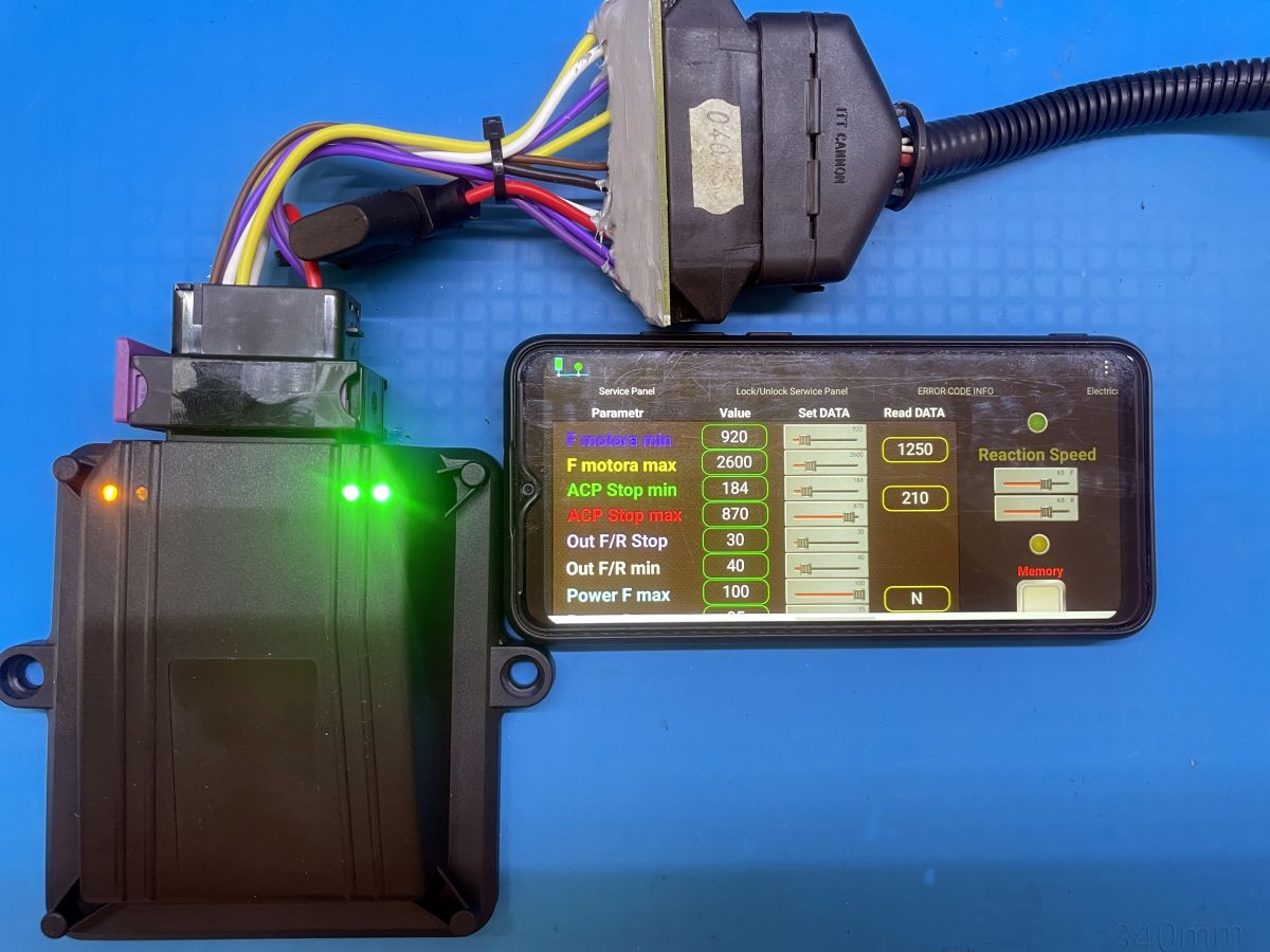

    Increased stability against voltage fluctuations – ideal for older machinery.
    Software calibration via smartphone (Android) ensures smooth movement, precise pedal response, and reduced fuel consumption.
    Ability to limit maximum speed and smooth acceleration – reduces transmission wear and extends component life.
    Emergency driving mode – allows the machine to move even if sensors fail (at 40% drive power) to reach the repair site.
    Built-in fault diagnostics with clear error descriptions displayed in the mobile app.
