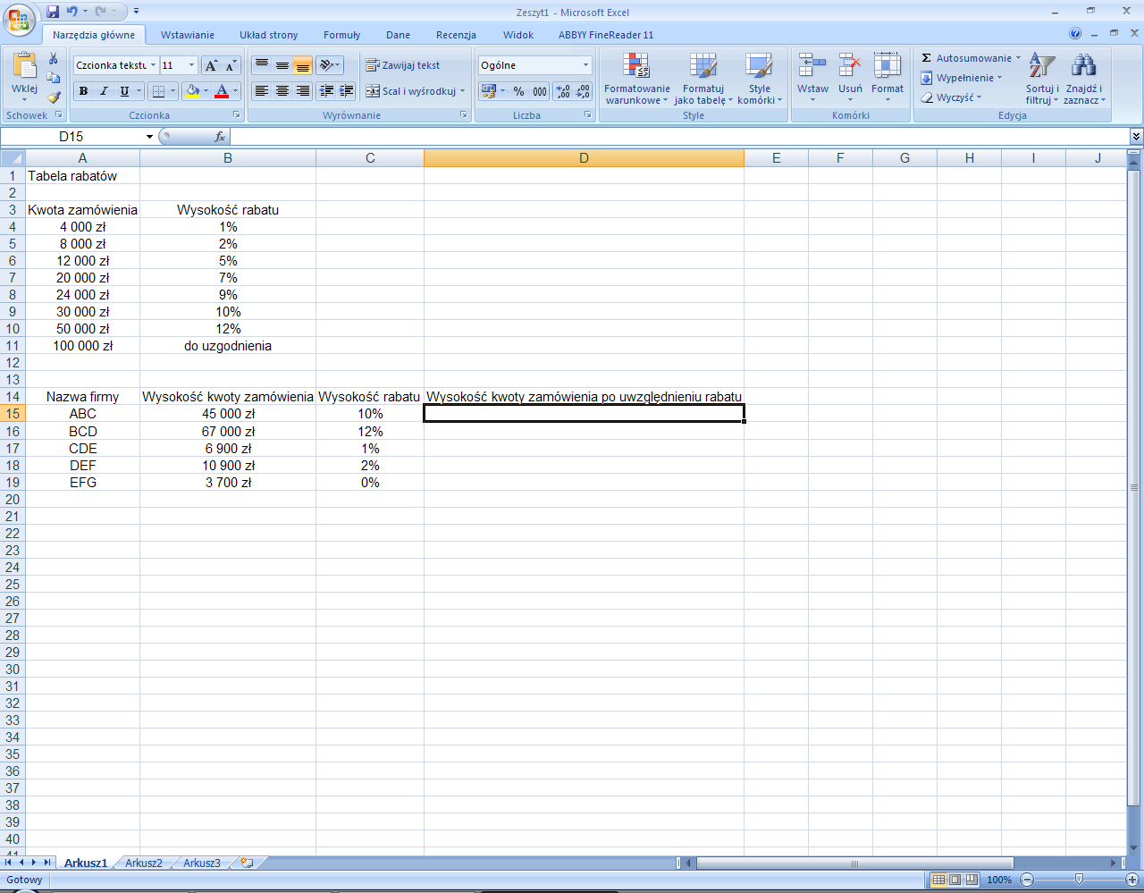

    Hello, I have a few doubts about Excel. I am not asking for a ready-made solution, but for a hint and explanation of what, where, and what.
    In the first order, I have to adjust the amount of the discount to the amount of the order. So, for example, from PLN 4,000 the discount is 1%, from 8,000 - 2% and so on. I don't know what pattern to use.
    In the second command, I am supposed to calculate the discount amount based on the order amount using only the if function.
    Besides, I don't know what it means:
    It should be remembered that the sheet generated in tasks 1, 2 and 4 is to react appropriately to any entered values. You should not use hard assignments, only conditional functions.
    So if I create such a conditional function, the sheet will automatically calculate everything for me?

    In my opinion, the first point of this task concerns the creation of a discount table.
    This is where we enter both the value and the discount percentage for a given value. Such a horizontal (two-line) or vertical (two-column) table.
    This is what will be changed because "the sheet should respond appropriately to any entered values"

  • #5 14145937

    I just thought about it now. I will create a rebate table, a two-column "rebate amount" and "rebate amount", but how will the program be able to differentiate what rebate amount to choose?

    In my opinion, you enter data in this table manually, here and here
    Only in "if" you make everything dependent on the cells in this table.
    The condition is that the table has to be either in ascending or descending values (it cannot be mixed because it will not come out with "if" nesting then instead of if () you would have to use search.vert () or search.level ())
    Based on this table, you have to build if ()

    Well then you explained a little to me, but where do I use the if function? After all, I can calculate the rebate using the normal function.
    Excel: Calculate Discount Based on Order Amount, IF Function & Conditional Functions
    I entered all the values from the "finger".

    If you want to show the discount amount separately (C15 and below), here will be the if () functions. And then you can actually apply the usual multiplication.
    But (I thought) point 2 says that you have to calculate the discount amount. So instead of separately showing the percentage for a given amount paid by a given company, immediately multiply it by the base amount already inside the formulas if (). But that could only be my illusion.

    If you want to leave the discount percentage in column c then:
    Enter C15
    = if (B15> = A11; B11; if (B15> = A10; B10; and so on
    If only the rebate amount is to be (this is how I understand task 2 - but I can be wrong) then:
    WC 14, change the header to "rebate amount".
    Enter C15
    = if (B15> = A11; B15 * B11; if (B15> = A10; B15 * B10; and so on
    I think you can handle it, because I gave you the solution on a tray - I don't know if the teacher will be satisfied.

    I dealt with it before, namely I arranged the conditions in ascending order instead of descending. Thanks for your help anyway.
    Now there is a problem with these stamps, my function for calculating the amount of discounts as a percentage looks like this:
    = IF (B15> = A11; "negotiable"; IF (B15> = A10; B10; IF (B15> = A9; B9; IF (B15> = A8; B8; IF (B15> = A7; B7; IF (B15> = A6, B6, IF (B15> = A5, B5, IF (B15> = A4, B4 ;) )))))))
    Where do I add $ marks so I can drag it down?
