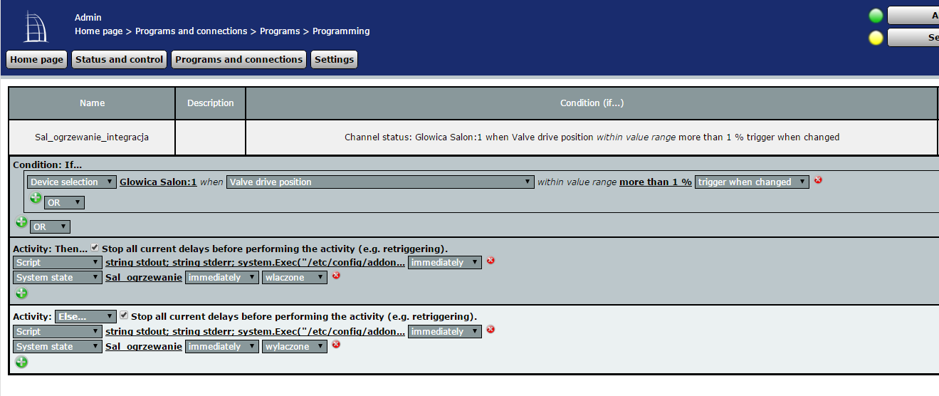

    gwisniew
    Posts: 6
    Rate: 9
    Preparing a suitable 'programme' will be trivial. I deliberately use inverted commas because it can hardly be called a programme. Such a configuration is clickable. I am attaching a screenshot of such a program (just in the screenshot there is a script call, which in your case will not be necessary).
    The head status is read directly from the head, not from the thermostat. The head is visible from the control unit regardless of the thermostat (but the thermostat can and should be
    (but the thermostat can and should be paired with the head and then the thermostat controls the head without the control unit).
    More problematic will be the control of the furnace. A suitable device for this would be: http://www.elv.de/homematic-funk-schaltaktor-mit-klemmanschluss-zwischenstecker-bausatz.html, but this is only available in a DIY kit and you have to do a bit of soldering and I'm not sure if it has a bistable output, i.e. if it maintains a short circuit (rather yes, all devices have quite a few configuration options). I couldn't find any documentation on the elv website.
    Alternatively, you could use the http://www.elv.de/homematic-132989-funk-schal...enstecker-fuer-smart-home-hausautomation.html device, but you will need some kind of relay that would short-circuit the cooker contacts.
    Regarding range, there is a repeater available in the Homematic system: http://www.elv.de/homematic-selektiver-funk-z...cker-repeater-hm-sys-srp-pl-fertiggeraet.html. Other rulers do not have this function.

    I will be expanding and buying another set for my home in pols. First of all, the price.
    The heart of it is the control panel-hub. It has a built-in relay to control a boiler or two a boiler and hot water in fact just two pairs of contacts. in my case, it controls the boiler. It communicates with radiator thermostats and room thermostats. Communicates with home wifi and drayton wiser cloud. The device can operate independently of an internet connection. Operation from the app.
    Radiator thermostats - heads. Without display. Room thermostats overriding the heads up to a maximum of five thermostats in a room one four radiators and a room thermostat.
    At my place it is like this.
    bathroom thermostat head + room thermostat. The head showed a slightly different temp than was in the room is by the door.
    living room three radiators with heads + room one.
    bedroom 1 - head
    bedroom 2 - head
    The room thermostat in the living room opens the heads and starts the boiler in the bathroom.
    Time schedule in days of the week and hours to be set. Open window detection function. Geofancing - location of occupants.
    Preview of room heating on characteristics.

    The open window function has not been tested yet. I don't know if it will work at all at my place because I have radiators on the wall on the other side of the window. Opposite. Well. England. You know two taps and radiators not under the window.
    When it comes to geofancing it works with the life 360 app. all to link together on IFTTT. There you link the wiser app with Life and also, for example, lighting but that's another matter. Life tracks your location and transmits the data to wiser. If you move away from the house in a circle with a defined radius, the heating switches to a low-cost mode, e.g. 16st. Or it switches off completely. Once you are within this circle, the heating starts. This is not a problem for me. There are no harsh winters and I have no underfloor heating. It takes 25-30 minutes for it to be warm. Temperature on the boiler feed water 50st. Application mode comfort. That is, the outside temperature and the characteristics of the flat are taken into account.
    Added after 5 [minutes]:
    This is a characterisation from yesterday for example.
    HomeMatic - How do I get started with thermostats and a LAN gateway for radiator control?
    Added after 1 [minute]:
    Added after 17 [minutes]:
    On the ifttt location app I also have it linked to the lighting which only turns off when I leave. Here it is better to have motion sensors, but this solution costs money. For example, I turn on the alexe radio when I enter the house. This is just for curiosity's sake, because here it is better to have a motion sensor that detects you and is connected to your location. In addition, it still detects movement when you are not there - an uninvited guest.
