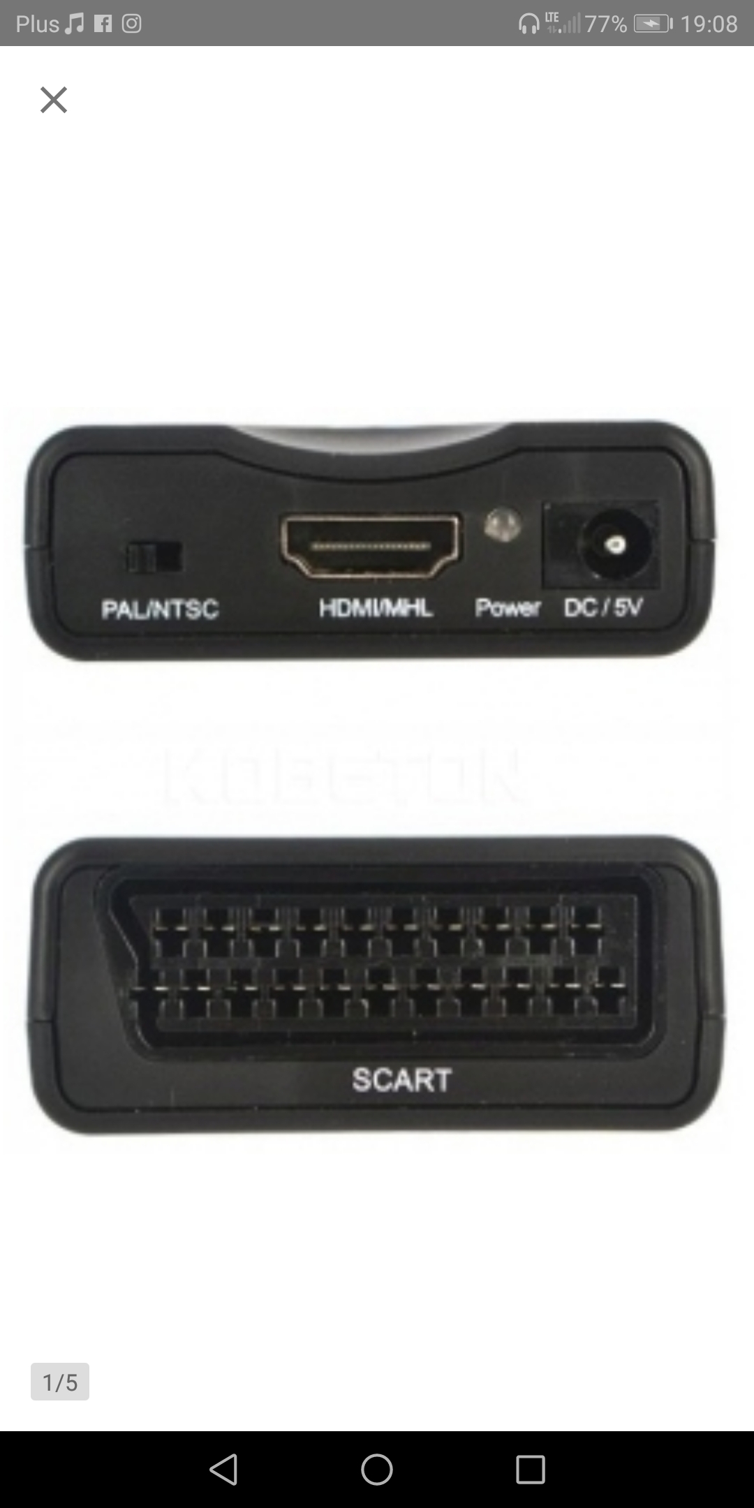

  • #5 14294609
    ZawaDi
    Posts: 316
    Rate: 58
    Then this wire
    DIY HDMI to SCART Cable (EURO): Creating Custom Laptop to TV Connections & Profitability
    I do not have a schematic for it, and I do not know if it is for HDMI as the first HDMI connector sends the signal to scart or vice versa.
  • #6 14294676
    andpol 33
    Posts: 4155
    Help: 513
    Rate: 1146
    The plug can be put on anything. This cable is not allowed to work.

  • #8 14294826
    andpol 33
    Posts: 4155
    Help: 513
    Rate: 1146
    Cińczyk will do whatever you order. For what...? Probably just to earn money. Personally, I do not know devices that could be connected with such a cable and the HDMI-Scart converter costs PLN 200 at least.
  • #9 14297498
    KOCUREK1970
    Posts: 35666
    Help: 3860
    Rate: 5488
    ZawaDi wrote:
    If it has no right to work then why are they producing it
    Because there are na?ve people to buy it.
    All it takes is a password
    "how simple it is, you don't need expensive devices that convert the HDMI signal to RGB anymore, our wonderful cable, for PLN 99 will do it" - and 300 pieces sold on the trunk.
    andpol 33 wrote:
    the HDMI-Scart converter costs PLN 200.
    And people think they saved a lot of money buying this great cable.
    It is not even sure if these plugs are connected to this cable at all ...?.
    I myself saw a 500 GB SSD on the Allegro, for PLN 149 - those who bought it "got" a lesson for life, and what was in the set when someone took it apart, because people reported problems:
    - a metal box in which 2 screws were glued with glut to ensure the weight of the whole is appropriate,
    - in the middle, an ordinary USB bone skillfully connected to the slots and programmed in such a way that it showed 500 GB in the BIOS ... - only that its real capacity was 16 GB - now you understand.
