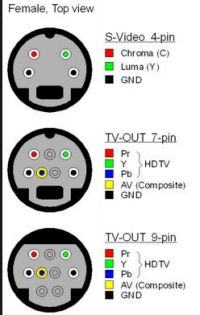

    All in all, it was connected to the S-VIDEO. Although the entrance in the trap is actually free, it works in the docking station :-)
    And here's another question. The docking station has the S-VIDEO 7 pin output. The cable is S-VIDEO 4 pin. While the S-VIDEO (4-pin) - S-VIDEO (4-pin) cable on a traditional DVD player works well, it is connected to the computer's S-VIDEO docking station with 7 pin and displays the image, but BLACK AND WHITE.
    I found something like this on the internet:
    Connecting PC to Samsung Hi-Tron Dolby Surround TV using SCART: HDMI Converter or Alternatives
    It follows that S-VIDEO 4 and 7 pins should be compatible (version 7 has two additional pins on composite video). And now a question - why is the picture black and white after connecting the computer to the TV via the standard S-VIDEO 4 pin cable? The computer detects the TV correctly (as Monitor No. 2 - PAL-D TV), but with a similar connection via S-VIDEO of a traditional DVD, the picture is normal, color?
    If, in addition to the standard S-VIDEO, connect it like this:
    leading from the 7 pin plug additionally chinch on composite using something like this:
    http://monitorsklep.pl/kable-przewody-kable-p...pin-s-video-wtyk-+-3,5-jack-stereo-wtyk-3rca- socket - + - 4-pin-s-video-socket-o_l_208_68864.html
    would that be the color on the tv?
    I know it's a technology from 10 years ago, but it's already working. It's just that the picture is black and white for some reason :-)
  • #10 16528815
    Polon_us
    Level 42  
    Posts: 6937
    Help: 1184
    Rate: 1281
    wujek_dobra_rada wrote:
    It follows that S-VIDEO 4 and 7 pin should match
    In this particular case, this sentence is not true with regard to the description of the sockets that the colleague showed.
    Although, it is generally the case.
    The TV-OUT 7-pin socket (in the entry above) has no S-Video signals.
    It is a Component signal - three signals make up a complete video signal - Y, Pr and Pb.
    A colleague is sure that this description applies to this laptop / docking station?
    If a colleague wants to input the Composite signal to the TV, there is absolutely no need to input other video signals additionally.
    All you need is one Composite connection - the image should be in color.
    Of course, you must remember that the TV set has the correct Composite video input (not S-Video!)
    I assume that this description (7-pin) is correct, although I have doubts - I have seen a different description of the S-Video 7-pin sockets once.
    If I were a colleague, I would check it on the laptop / docking station manufacturer's website.
