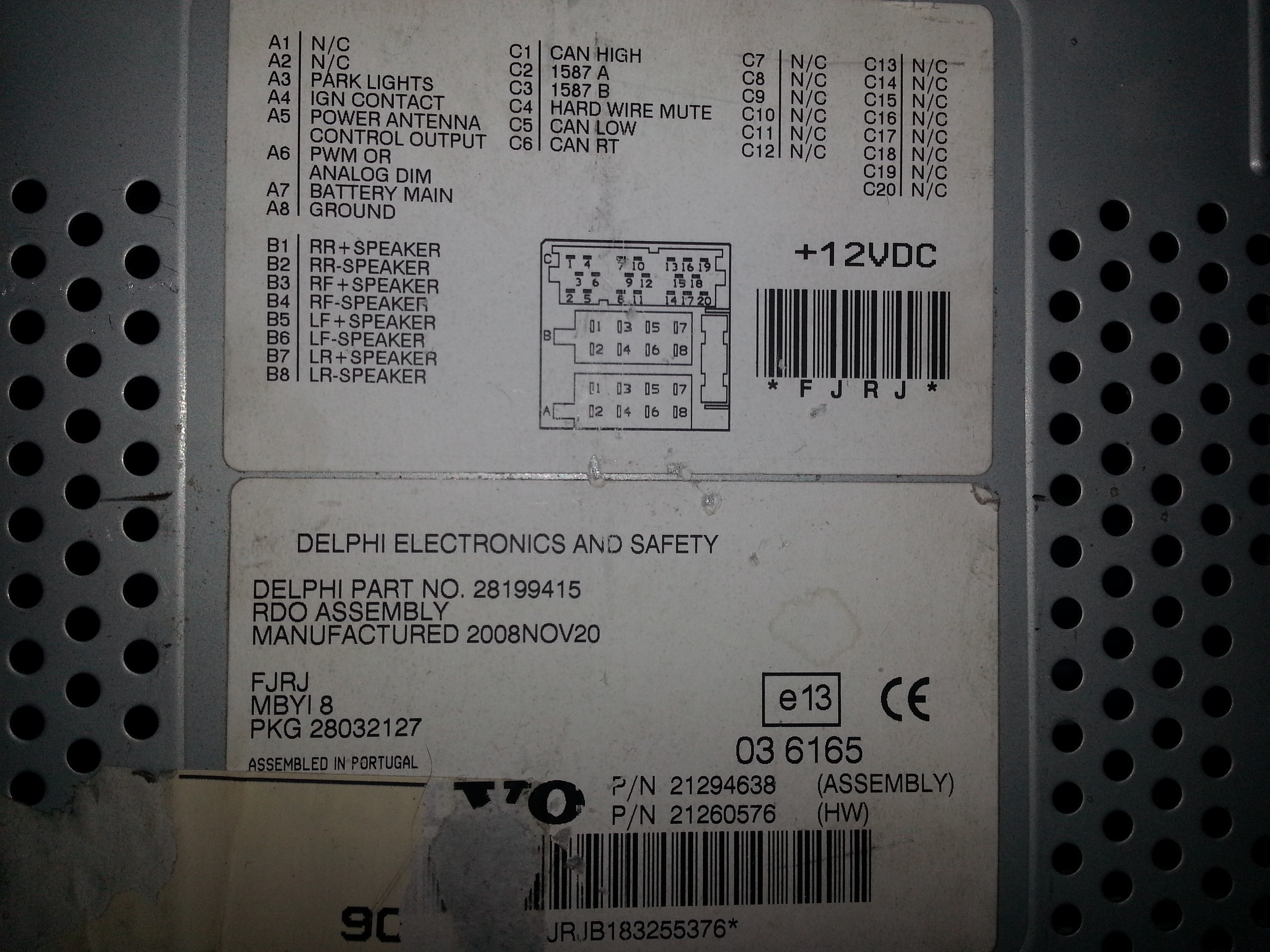

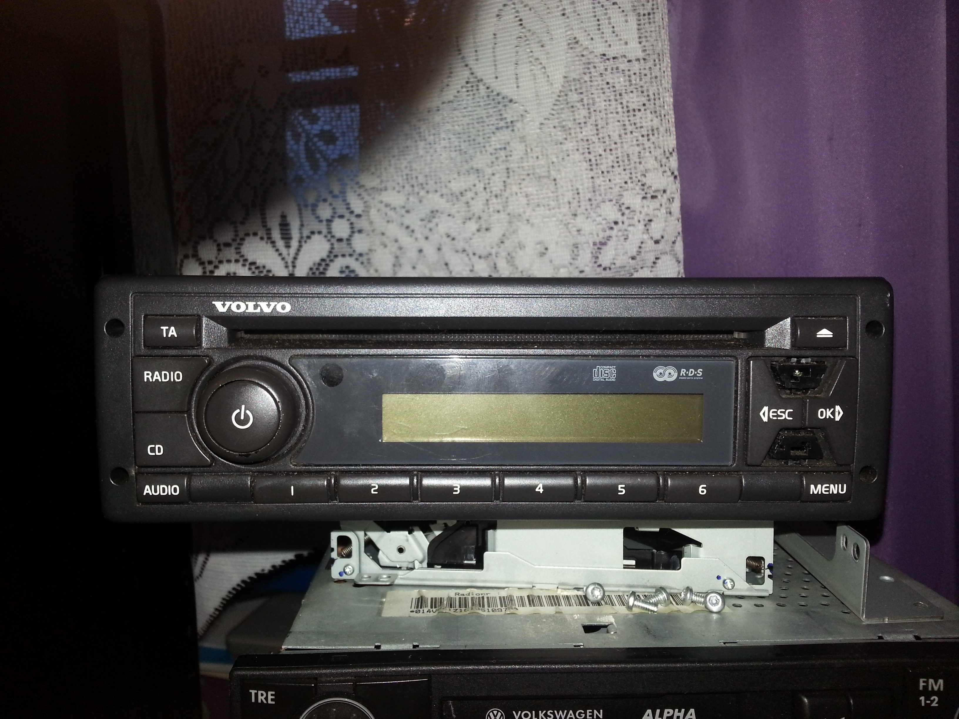

    The radio worked in a truck unfortunately asking for a code after replacing the batteries.
    I am asking for help in reading the code from the batch.
    Input loaded with the easy pro 90b programmer.
    Radio Volvo cd memory 24c01.
    • How to read Volvo HF CD radio code from 24C01 EEPROM file? vo.jpg (2.34 MB) You must be logged in to download this attachment.
    • volvo_cd_bin.bin (128 Bytes) You must be logged in to download this attachment.

    we give as much as possible of the equipment data, in particular the brand, type, pn
  • #4 14403655
    serwis11
    Posts: 81
    Rate: 12
    That's all I can find on it and the name VOLVO.
    • How to read Volvo HF CD radio code from 24C01 EEPROM file? vol.jpg (2.53 MB) You must be logged in to download this attachment.
