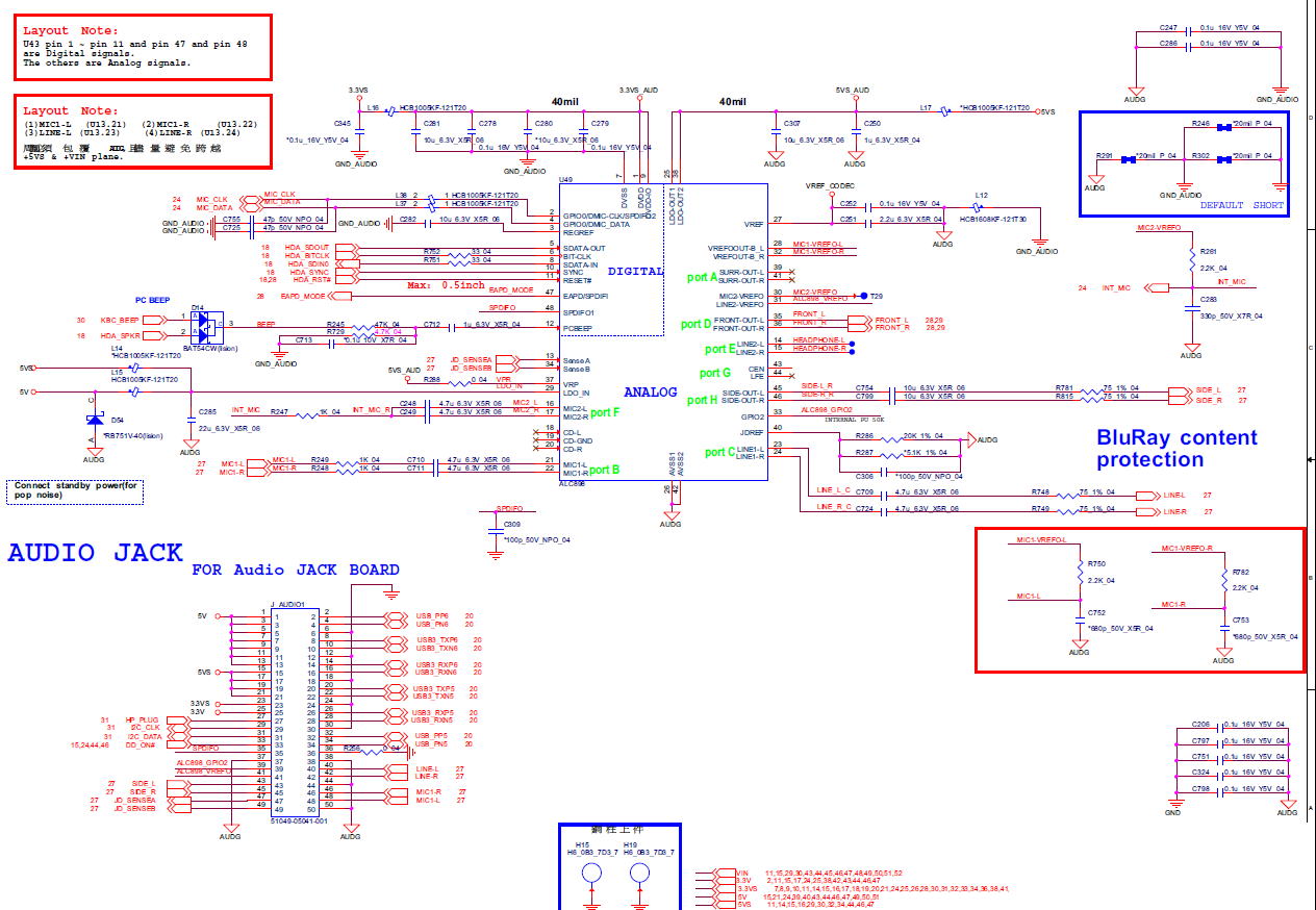

    Is anyone able to read this information, will the 80 ohm version work well for me on a laptop? Without amplifiers etc.
    • Choosing Beyerdynamic DT770 PRO Headphones: 32, 80 or 250 Ohm for Onyx Blackjack & Kurzweil PC3x image.png (215.37 KB) You must be logged in to download this attachment.
