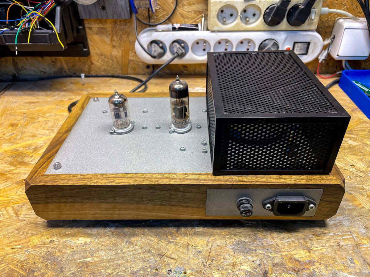

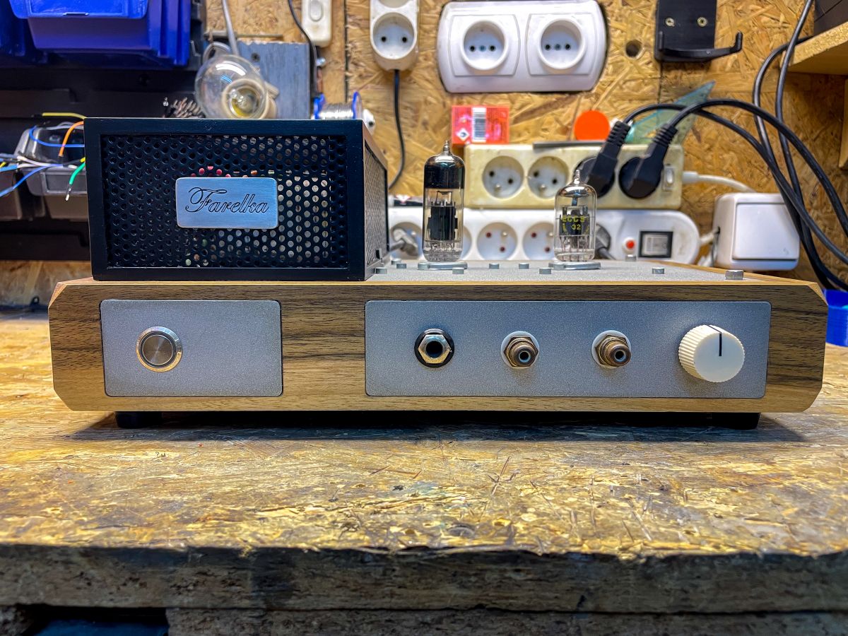

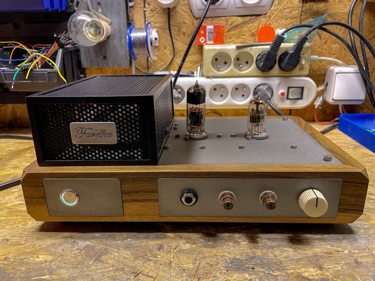

  • Hello to all enthusiasts of home tube designs! I come today with a headphone amplifier project using ECC88 and 6N6P tubes. This amplifier was created to drive the Beyerdynamic DT990 Pro headphones, which, as befits studio headphones, have a sizable impedance (250 Ω). It was one of the longer projects, due to the fact that I am still a beginner when it comes to electronics, and also because I was implementing solutions that were completely new to me at the time. It is not a perfect design, and unfortunately it is not universal either, because the impedance that this amplifier can handle should not be lower than 250 Ω (due to the design of the output stage), but for my applications it is ideal.

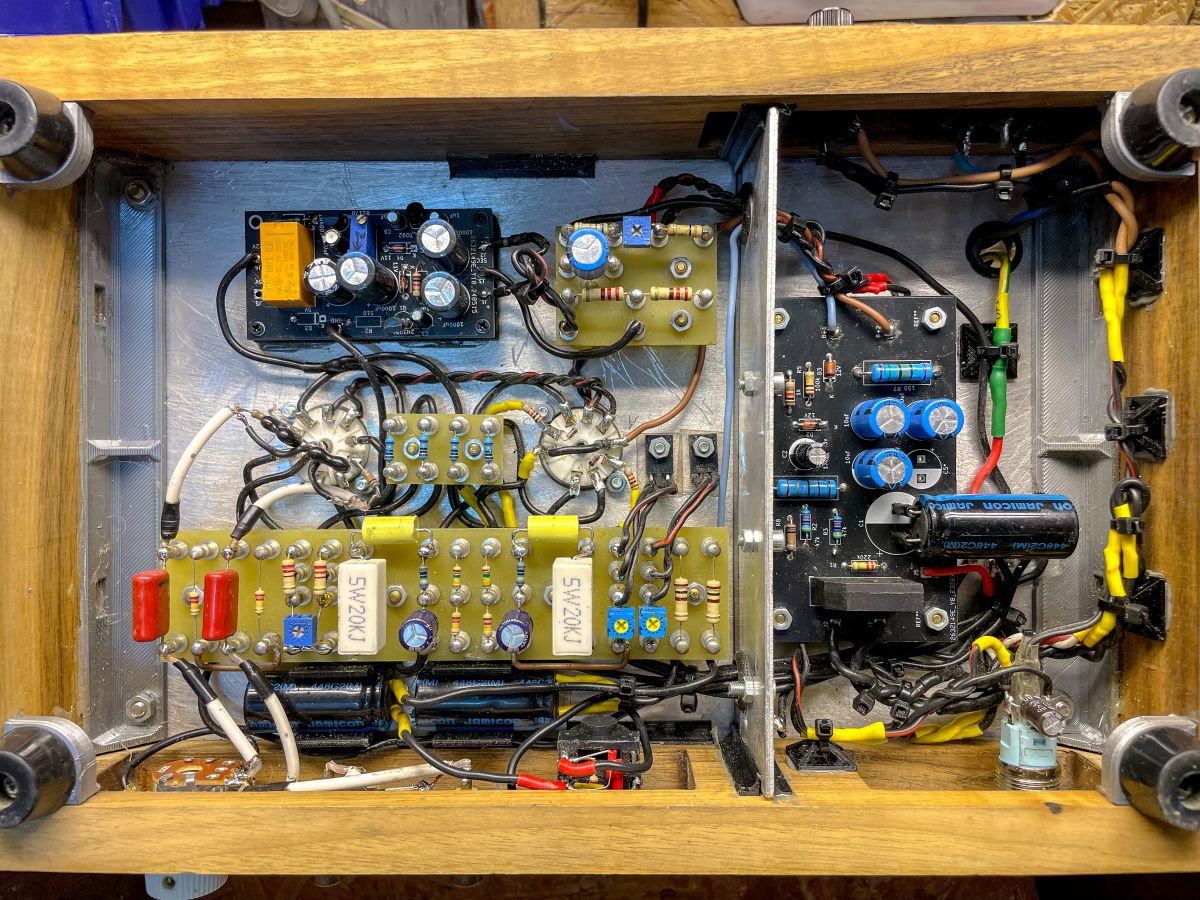

    I built the amplifier using components I had in store, i.e. transformer, tubes (although initially there was going to be a second 6N6P or 6N1P in the control stage, but I got a couple of ECC88s from a friend). As the power transformer had limited capabilities (200 V AC and 100 mA), it fell to a 'simple' cathode secondary for the output. Had I had a transformer with higher maximum currents and voltages, I probably would have opted for a White's secondary, but alas :) .
    There was a lot of news in the power supply, as I decided to implement active filtering with a gyrator (which in the end was not particularly necessary) and a capacitance multiplier. The control stage on the ECC88 is a typical circuit, without any miracles, except that it has a balance potentiometer in the cathodes of both tubes (not the best solution, but it works). Much more (in my opinion) happens in the final stage. The 6N6P tube acts as a cathode secondary, however it is not a typical secondary as the cathode resistor has been replaced by a current source on an NPN MJE340 transistor (now I would do it on a MOSFET). The current sources are powered by a separate power supply with a built-in base voltage turn-on delay (set to 15 seconds from what I remember). Each source has a precision potentiometer in the emitter to set the current, so that the current of both halves of the tube can be set perfectly. Because the voltage at the 6N6P cathodes exceeds the maximum heater-cathode voltage, I used an elevation voltage that is 40 V. I took a lot of information and inspiration from Mr Merlin Blencowe's books. I attached the MJE340s to the chassis because they heat up a lot, and that's why the name "FARELKA" came about, because the amplifier can get ;) (but of course within the norm).
    I made the enclosure from walnut wood and aluminium, which I cut out using CNC. The screw mounts, the transformer 'cage' and some other parts were printed on a 3D printer. I placed the amplifier parts on a turret board, as I am a fan of this technique. I have tried to keep the interior as neat as possible, but that is for you to judge. I like it.
    As for the sound - in my opinion it sounds brilliant. You can't hear any noises (when I first fired it up during testing and heard nothing in the headphones, I was sure it wasn't working. All I had to do was turn up the volume control). I'm not an audiophile or anything like that, but the amplifier continues to impress me, as well as my friends who have had the opportunity to test it.
    What do you guys think? ;D

    The design looks interesting, the wooden parts came out very professional. Perhaps a metal knob would be useful?

    Pretty neat. It's nice that something audio and tube-based has appeared in the DIY section :) Wooden parts brilliantly done, the fit of the whole is also flawless.
    In my opinion, this black cage is a bit incompatible with the silver parts of the amplifier. Nothing else is black so in my opinion it would be better if either the grille was silver or the rest was also black. The white knob doesn't fit very well either, but I suspect it's a temporary solution ;) And the RCA sockets on the front - not very convincing to me, I think it would be better if they were on the back, there's plenty of space there.
    These black PCBs are some kind of "ready-made" or just ordered?

    TechEkspert wrote:
    Interesting looking design, the wooden parts came out very professional. Perhaps a metal knob would be useful?
    I just like this knob for what it is, but maybe I'll think of something!

    Olkus wrote:
    In my opinion this black cage is a bit out of keeping with the silver components of the amp. Nothing else is black so in my opinion it would be better if either the grille was silver or the rest was also black. The white knob doesn't fit very well either, but I suspect it's a temporary solution. And the RCA sockets on the front - not very convincing, I think it would be better if they were on the back, there's plenty of space there.
    These black PCBs are some kind of "off-the-shelf" or just ordered?
    Thank you for sharing your feelings! I personally like the effect of a kind of colour 'dissonance' in the form of the black cage, and as for the knob, I personally like that too, however your responses are prompting me to see what the other knobs will look like. The RCA sockets are at the front because there are more wires at the back with AC and anode voltages (with high current) so if they were located there, it could affect some interference. But really thanks for the feedback !
    Olkus wrote:
    These black PCBs are some "off-the-shelf" or just ordered ?
    The PCBs are also of my design, they were ordered from the JLCPCB website. Greetings!

    Pltin74 wrote:
    Thanks for sharing your feelings! I personally like the effect of a kind of colour "dissonance" in the form of the black cage, and as for the knob, I also personally like it, however your responses make me want to see what other knobs will look like.
    If you like it then OK. After all, it is you where this amplifier will stand and play, the most important thing is that you like it :) .
    Pltin74 wrote:
    The RCA sockets are at the front because at the back there are more wires with AC and anode voltages (with high current) so if they were placed there, it could affect some interference. But really thanks for the feedback !
    Anode voltages (if constant) are less of a problem than AC. I would just be afraid that the RCA wires at the front will spoil the aesthetics of the amplifier, there will be a preamp, DAC or whatever added after some time and it will make a "noodle" at the front.
    This is also what I suspected ;) However, I personally would not want to order such small PCBs and would make at home, even much larger ones I make at home, comes out cheaper overall.

    The interior aesthetics are undoubtedly an asset to this project. And I have to admit it, even though I am not a fan of the old style of mounting tube equipment.
    On the electronic side, it's hard to say, because we don't know anything. But I perfectly understand my colleague not wanting to reveal his secrets. (I am increasingly thinking the same thing myself.)
    As for the impedance of the headphones, it's clear that when you're doing an OTL tube design, you're not going to power low-impedance headphones with it. Although those stated 250 ohms are a bit puzzling. I use my OTL myself to power 50 ohm headphones with no problems.
    To be honest, even for a tube headphone amplifier, I find your project quite large. Personally, I would prefer something smaller. I know, everything is a matter of taste. And apparently we do not discuss about taste. But since you have presented your project, let me express my own opinion.
    At first glance, visually, the design gives the impression of neat refinement. But when I looked at it a little longer, apart from the aforementioned large dimensions, I could see a lack of style here, as if it were a total misfit. (I don't mean the combination of wood and metal. This, done well, I like very much.) For me, too many colours of wood, aluminium would be enough. And here additionally black of the transformer grille, grey/white volume control knob. On top of that, I would prefer a solid rather than split aluminium insert on the front. Other than that, though, for me, the RCA inputs on the front are a poor idea. They spoil the aesthetics a bit (especially when something is plugged in, rather than standing as in the pictures, unconnected). And while I'm on the subject of sockets, the headphone jack you used isn't one of the prettiest either. Yes I know, it allows for easy mounting in the faceplate, but it also disfigures it a bit.
    I am very sorry to have expressed my opinion so strongly. It's not my intention to belittle you or your actions. But since you mentioned your intentions to possibly sell, I simply expressed my opinion from the point of view of a potential customer.

    250ohm a 50ohm mentioned by kol titka is also OK. Maybe even 32ohm would do. The power will be reduced a little.
    As for size..the dedicated designs for the Sennheisers are huge. Too bad you can't see that wonderful classic assembly through the sweeping enclosure. Like 1960s Japan but much more professional and qualitatively better.

    tytka wrote:
    With regard to headphone impedance, it's clear that when you're doing an OTL tube design, you're not going to power low-impedance headphones with it. Although those stated 250 ohms are a bit puzzling. I myself power 50 ohm headphones with my OTL without any problems.
    The amp was designed to drive 250ohm headphones (which I have) to the maximum. You could plug 50ohm headphones into it, the music would "play", but the power would be drastically reduced (and it would also be unhealthy for the tube, as the operating points would shift etc).

  • The enclosure combines walnut wood, aluminium, CNC-cut parts, 3D-printed details, sanding, and oil finishing; the PCBs were custom-designed and ordered from JLCPCB. [#21406898]

How do you build a neat turret-board tube amplifier layout and keep the internal wiring quiet and organized?
You keep it neat by separating functions, using a turret board, and planning the chassis around heat and noise. The builder says he mounted the amplifier parts on a turret board, kept the interior as tidy as possible, and fixed the hot MJE340 devices to the chassis. He also kept RCA inputs away from the rear area with AC and anode wiring. A commenter later says the inside makes a better impression than the outside and praises the interior workmanship as very good for DIY. [#21442636]
