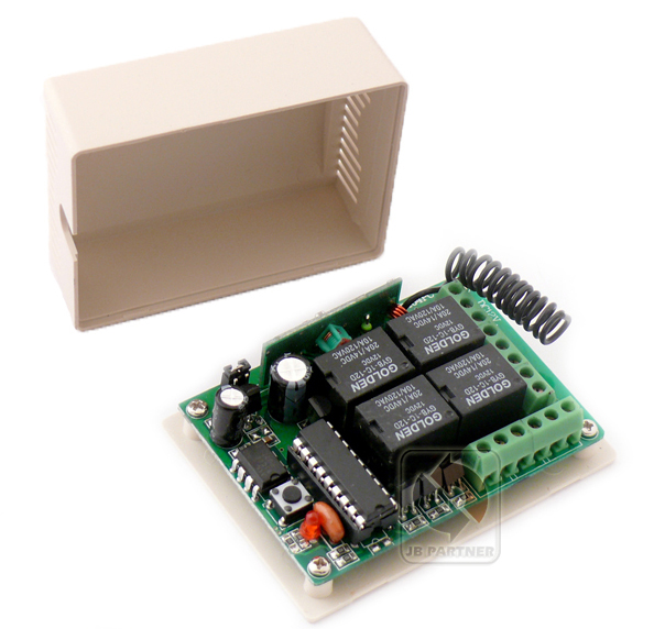

    what IC could be sitting in this controller ?? it is a ukaład with 18 legs . Unfortunately in all versions there is no inscription on these chips . The controller refused to work, so it does not respond at all, i.e. 4-channel radio
    bought on allegro .
    it may be an integrated circuit UL1958 ????

    UL 1958 is a no longer manufactured circuit for switching channels in RTV equipment.
    As 18 pins, you can guess that it is something from a PIC. E.g. PIC 16f84. Definitely a microcontroller of some kind.

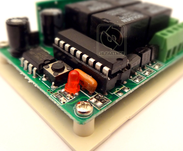

    another piece of information, underneath this IC there is the inscription " MIBEEG1448 " maybe there is something to be found out from this inscription.

    Finding a chip will not get you anywhere. In order for a microcontroller to perform the functions you expect of it, you must first program it. They come out of the factory "clean".

    since the controller has no response it could be e.g. the ceramic resonator - orange cylinder ????
  • #7 14441418
    ArturAVS
    Moderator
    Posts: 26474
    Help: 2305
    Rate: 7873
    Hard to tell without any measurements. There could also be a defective remote control.

    Well, that's all clear. You should have written right away. This receiver has a 12V supply! (Even on the relays you have it written that the coil is 12V). The stabiliser is probably fried.
    Give a close-up photo of the board, and a wiring diagram.

    You provide pictures inadequate to the state of your possession. The topic should not exist at all. You should post pictures of the controller you own, not some downloaded from the internet.
