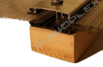

    I thought about connecting ordinary panels with polycarbonate profiles. They are sealed and intended for a similar purpose.

  • Polycarbonate roof profiles proposed for panel sealing; horizontal joints remain
    #9 14516415
    zibuch
    Posts: 43
    I was thinking about exactly this solution. the use of system solutions for polycarbonate roofs. they have gaskets at the top and bottom, cover strips ensure tightness.
    You do not have to worry about working in changing temperatures - polycarbonate has about 8 times the thermal expansion coefficient than glass. if polycarbonate works, the panel will handle it. vertical movements should compensate for the seals.
    there is only 1 problem - horizontal connections (when looking at the slope). how to get the tightness here. the idea came to my mind to glue the angle to the bottom edge (I put on the frame panels), so as to make an "extension" of the panel (one side of the angle against the frame, the other side flush with the upper surface) which will fit on the lower panel and in the event of thermal operation will allow movement.
    has anyone seen something similar? or met with a similar solution
    In my case, I do not assume the need for 100% water tightness because I will have full boarding and a membrane underneath. it is about eliminating the tile and making it airtight

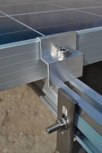

  • Mounting hardware costs PLN 740 per kW
    #12 14516598
    Jan_Werbinski
    Posts: 2821
    Help: 76
    Rate: 671
    Is it worth saving?
    According to normal prices (eg ASAT), using the original aluminum profiles and aluminum / stainless steel fixings, the material for mounting on rafters or flat roof and aluminum triangles costs PLN 740 / 1kW or PLN 88 / m2. This applies to thin films without an aluminum frame. It is said that the frame is cheaper to install, but I do not know. For me, it was cheaper due to direct access to the importer.
    I could combine it with welding a steel structure, but I won't save much, much more work and there is a maintenance cost.
    So for a 3kW installation we have a cost of PLN 2220, and for a 10kW installation, PLN 7400. At a price of PLN 3,500 / kW, it is 21%.

    I have two under construction: for the rafters http://www.sklep.asat.pl/pl/p/Uch useful-standard-do-dachowek-ceramicznych-i-betonowych-%2C-Art.007-/128 which is mounted on a flat roof and alu triangles.
    I am not going to make an airtight roof, if only because it is inconsistent with the panel manufacturer's instructions (cooling, dilatation, expansion, etc.).
    The visual aspect is great: completely black SL1-90 panels with a black frame.

    These polycarbonate profiles can be used on 4 sides by joining the panels together.
    The connection with the tiles can probably be made through a roofing apron or a metal sheet (on one side fixed in the profile and on the other side under the tiles).
    As for cracking - in rail mounting, these rafter mounts can bend a little as the roof moves. As for mounting directly on the rafters, there is no such range of motion, because the panel is rigidly fixed on the beam. I don't know what it looks like from this point of view.
    Putas wrote above that the panels mounted in this way broke someone else.
    Another thing is ventilation. At high temperatures, not only is the efficiency lower, but also the efficiency drops faster and therefore the service life is shorter.
    Despite all these issues, there are direct assembly (integration) systems and they even look good.
