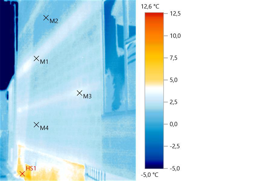

    On a normal winter day, what yield will 3850Wp amorphous panels placed vertically on a mostly shaded building wall give? I know that amorphous panels are more pros and cons.
    Are stains and dirt visible on the vertical panels?
    I am asking for an objective assessment of the economic sense of installing amorphous panels on the vertical western wall.
    For three years, the main source of heating a house with the annual demand for CO 30MWh has been PC P / W, and the peak source is the DS 25kW boiler. Last winter has slightly verified the possibilities of my PV system with PC P / W appetite in an expensive tariff, significantly increasing the operating costs, and since I had some wood and coal residues, I was cleaning them up in the DS boiler :) This year, I was supposed to insulate only two niches by the balconies (thermal bridges at the windows), but the thermal imaging of the side wall suggests its insulation.
    Installing 3850Wp Amorphous PV Panels Vertically on Shaded Wall: Winter Yield & Economic Viability
    With my current heating costs, expenses related to insulation will never pay off, I am more interested in the comfort effect (no chilled ceilings, no need to support the PC with the DS boiler) and finishing than the electric energy gain.
    Can the GS-50 amorphous panels be mounted vertically at all - taking into account their performance and technical considerations?
    Is there any sense in this mounting on a wall facing west and obscured by a neighboring house 6 meters away?
    I have a tall and moderately energy-consuming house, its side wall is about 8.6 meters wide, 9 meters high, and the highest point is 11.5 meters high.
    I am thinking of insulating this wall: the cost with the material will come out about 10-11 thousand. .
    I wonder if it is worth putting the insulation on my own, seal it up with mortar, paint it with paint and put amorphous panels on it. I will do all / most of the work myself (installation of double-threaded screws, mounting strips, sticking polystyrene on PU foam, placing an adhesive layer on polystyrene + some ground).

  • #12 16345788
    gaz4
    Posts: 4992
    Help: 77
    Rate: 2982
    Vertical installation makes sense when we want to use direct solar radiation in winter. Only then, because with a cloudy sky they will give half the power compared to those mounted horizontally. So using the entire western wall lined with PV to heat the house does not make any sense, it would be otherwise if it was the south wall. One of my colleagues writing in the thread about the construction of the collector for PLN 1,500 installed his structure vertically and praised himself very much - it has good performance in the fall and spring, and the water does not overheat in summer. And if you already apply such a "glass wall" to something (Żeromski would not even dream of such a hi-end :) ) it is only for water heating. The GS50 can be bought very cheaply (I got mine for about 1.5 PLN / W) so even with this setting the return on investment would be at a reasonable level (probably less than 15 years). An inverter is a big cost, it is not profitable to invest in the case of a half-hearted PV.
    The power obtained on a sunny day is easy to calculate. We multiply solar radiation by the sine of the angle of incidence. The sine of 30 degrees is 0.5, i.e. with the PV mounted vertically when the Sun is in front of the panels 60 degrees above the horizon (the angle of incidence on the vertical PV is 30 degrees), half of the available power will be obtained (i.e. when the rays fall on the PV perpendicularly).
