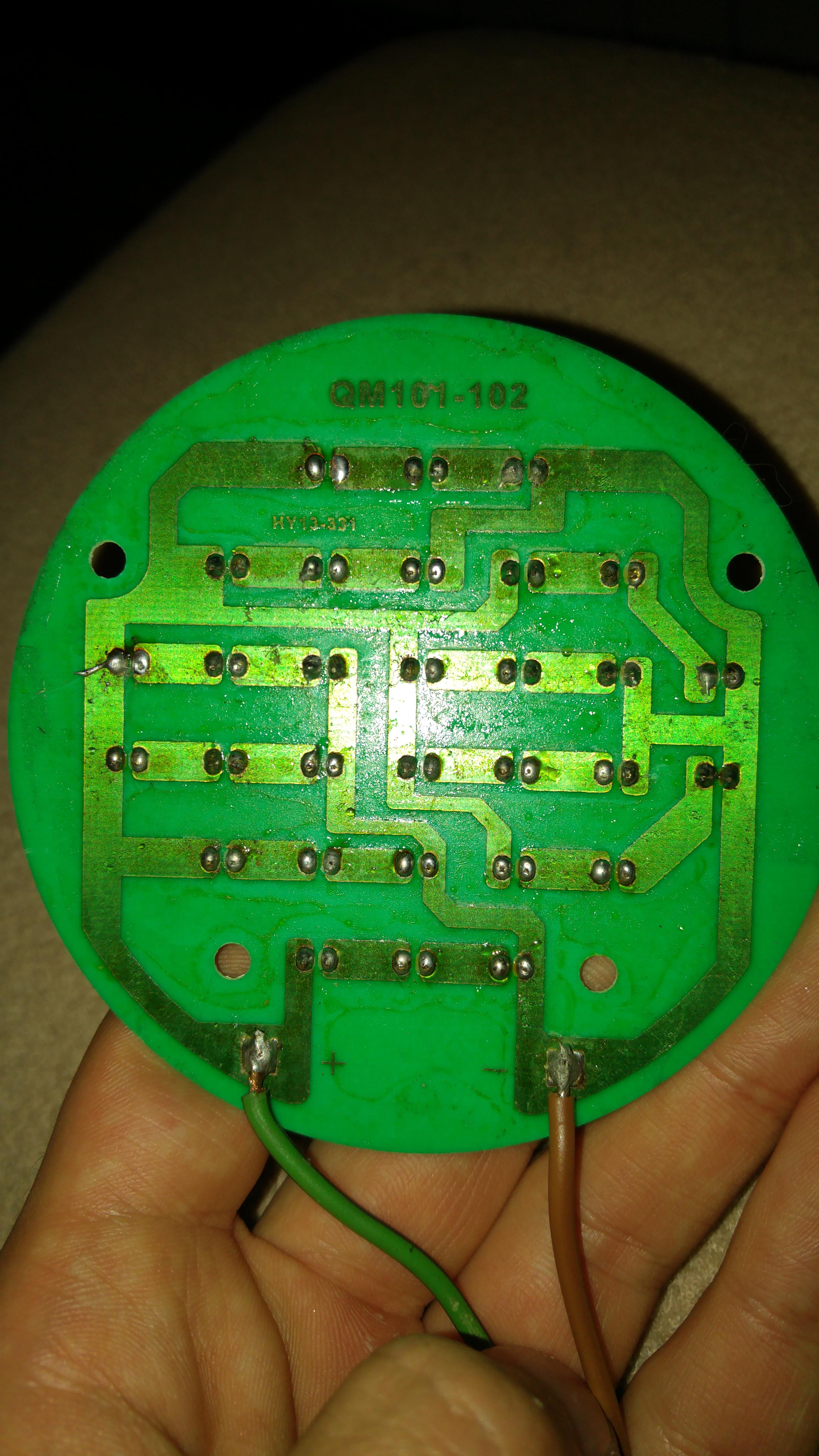

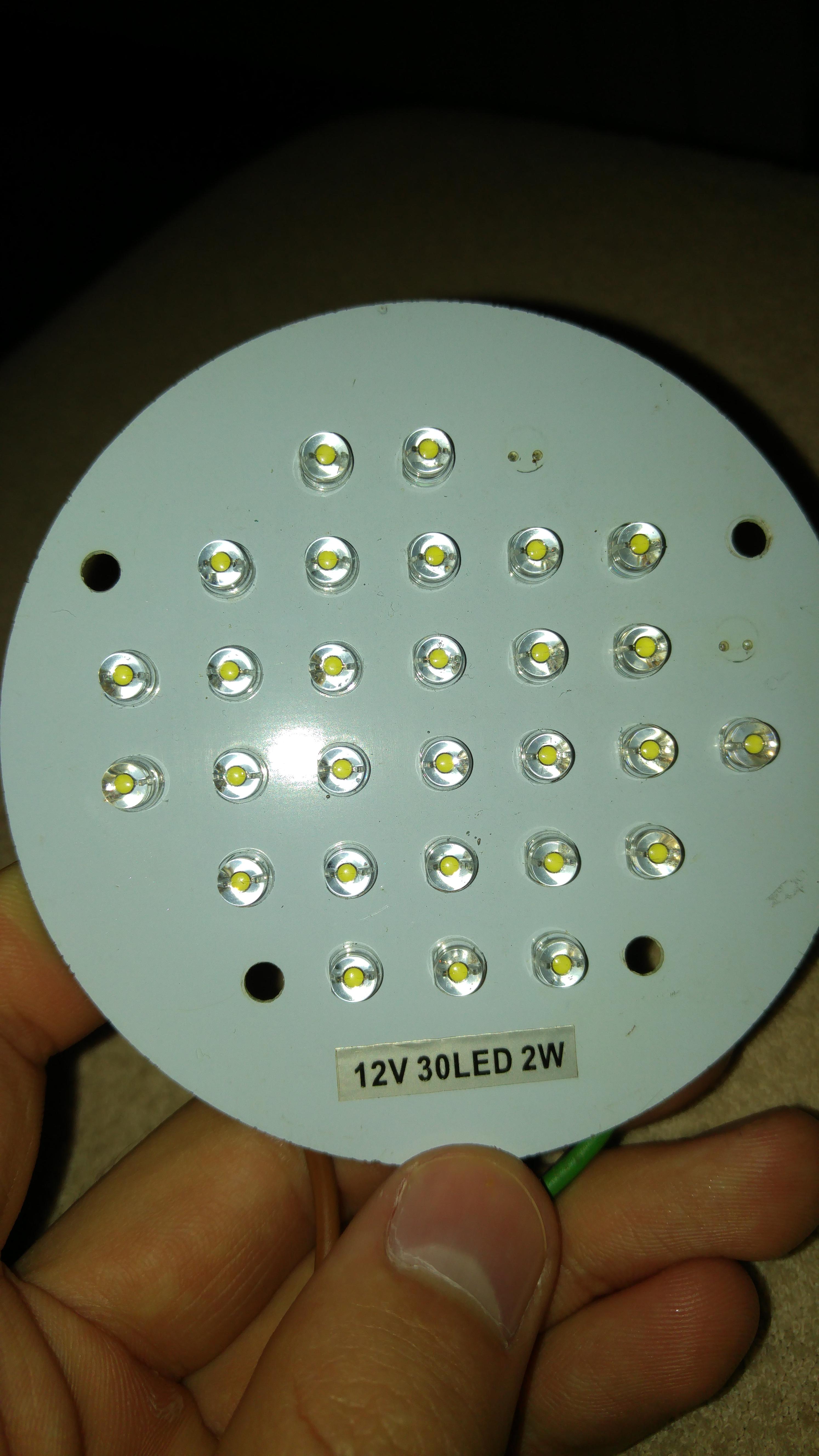

    I have a plate with 30 LEDs soldered on (very bright, white). The board says 12v 30LED 2W - which resistor should be used to use 1 diode for the car (backlight of the window button, 12v)?

    You must determine how many of them are in line because certainly not all of them ;)

    If you can draw a diagram of how these LEDs are connected.
  • #4 16434500
    henazari
    Posts: 34
    Rate: 9
    12V 30LED 2W: Choosing Optimal Resistor for Single LED in Car Backlight Window Button 12V 30LED 2W: Choosing Optimal Resistor for Single LED in Car Backlight Window Button
    This is how it looks.

    To power one diode from 12V you will need a 480? / 1/4 W resistor.

    480 ohm will be hard to find, if I give 500 it will be ok too? What does it mean 1/4 W? - I'm sorry but I'm green in it :D

    If you use 500? = 0.5K? nothing will happen, it will only shine a little less.
    1/4 W is the resistor power that the power can convert into heat.
    500? can be obtained by connecting two 1K? resistors in parallel.

    From what I see, it is 3s10p :)
    Don't those diodes burn?
    Measure the current consumed by one 3-diode branch and use the simplest current source instead of resistors. There is no constant voltage in the car. It ranges from 11 to 15. A power source can handle this.
    Read here: http://robotykadlapoczatkujacych.pl/lekcja-10-stabilizatory/
    You can also build a power source on the LM317 and one resistor. For a current of 10mA, a resistance of 120 ohms.

    Unfortunately, the button has very little space and I do not want to combine with such miracles, I hope that the resistor alone can do it :) So far none of the diodes has burned out - 3s10p is the "name" of these diodes?

    This is just a single low power diode.
    The limited resistor current will not burn.
    The current source is good with frequent voltage changes and more than a few diodes or one larger.

    No no.
    3s - 3 series
    10p - 10 parallel
    3szeregowo10rownolegle.
    At least that's how I read it from the pictures.
