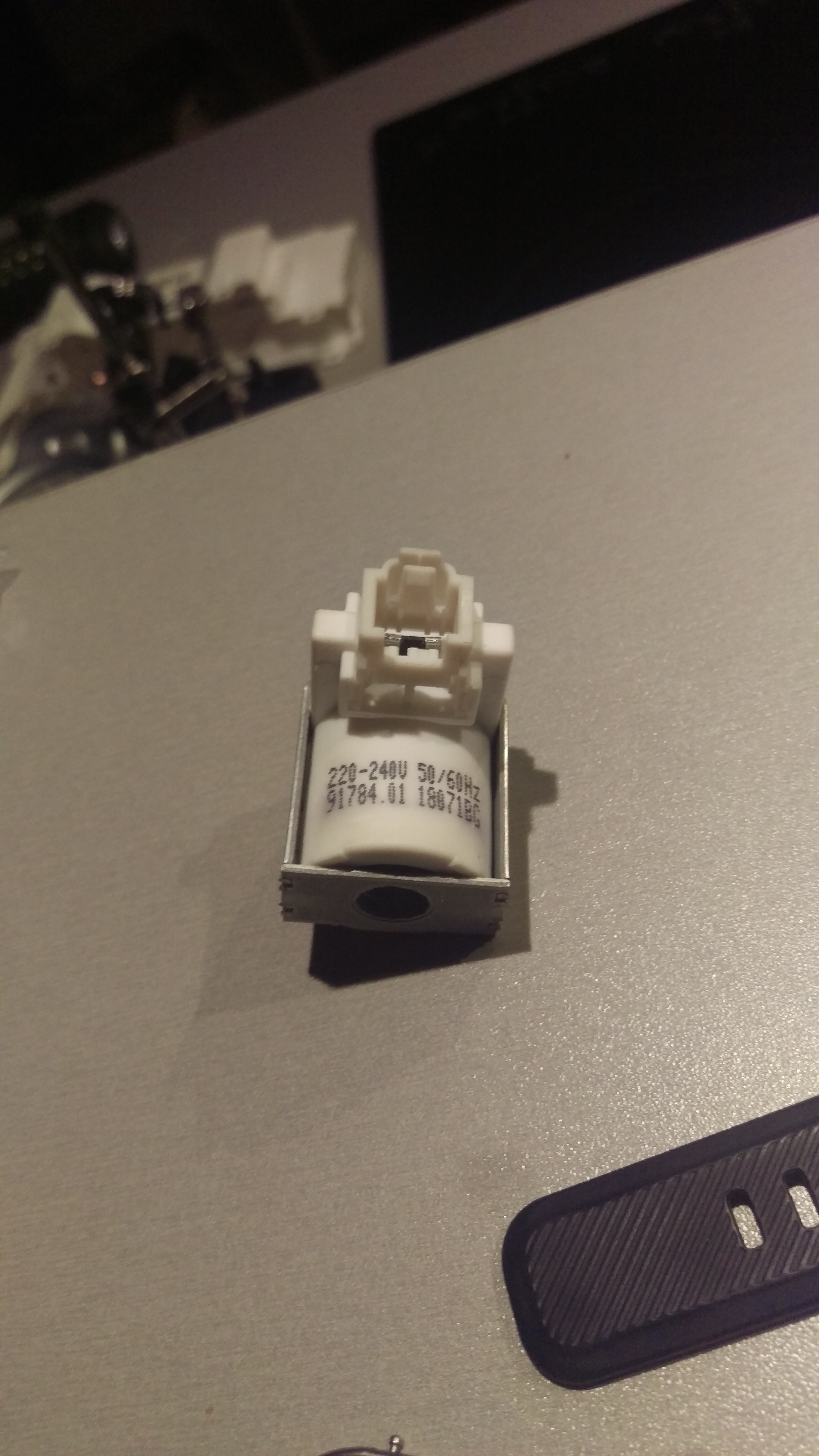

    Welcome. I have a problem with the dishwasher - it does not heat the water - the controller does not supply voltage to the heater. Two contactors are responsible for its work. When the heater is to turn on, one contactor (its coil) shows 9V, while the other only 0.8V. It works normally only washes in cold water and at the end of the program the error E: 04 is thrown. Can someone suggest where to look next?

    I can set 200, 20k, 200k, 2000k on the meter. But I checked three wires from the heater and only the two red ones have resistance. I am asking because this is the entire element that costs exactly PLN 596 - this is 1/4 of the value of a new dishwasher.
    Added after 7 [hours] 12 [minutes]:
    Could you tell me where this zeolite heater is? Is it in the attachment?

    I already know that it is not a heater. For me, there is no heater in the zeolite tank. Unless I'm blind ? This zeolite is these red pebbles and is combined with a salt reservoir?
  • #12 17269132
    mrice
    Moderator of Home appliances
    Posts: 13953
    Help: 2213
    Rate: 6951
    No, if the zeolite is present, it is in the tin box on the left side (viewed from the front of the device).
